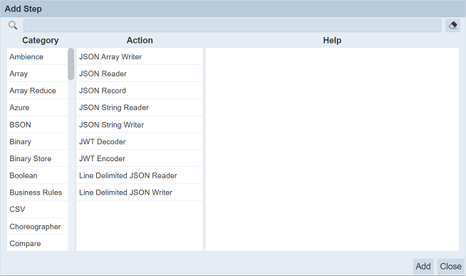

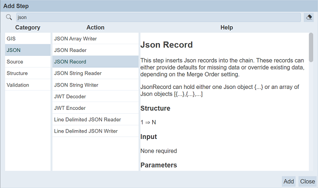

Add Step
If more steps are needed, simply continue selecting other steps then click on the Add button. Click on the Close button after adding steps. If any step was added, closing would instantly open the Edit Step dialog box corresponding to the last step added. Do note that step input parameters are required to be entered and saved before closing the Edit Step dialog box, else the steps will not be saved.

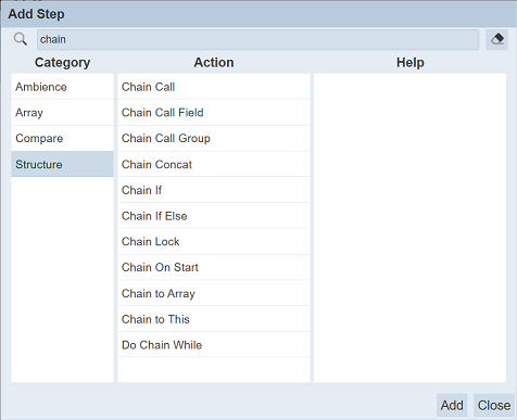

Chain Call Steps
- the
GenerateTextchain creates a text - the
SendEmailchain sends an email

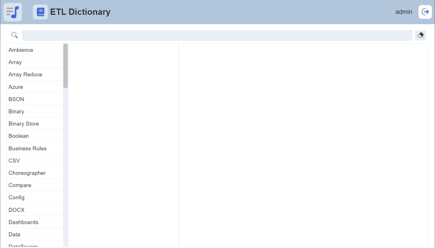

There are many other related steps, serving different purposes. For more information on these steps, refer to the Dictionary provided.

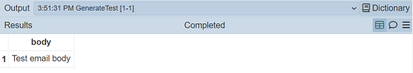

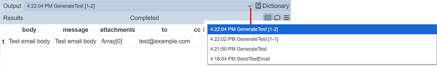

Run Steps
Right after triggering the chain to run, a record appears on the Output panel. Each run adds a record in the Output panel. The Results panel displays the actual results of the executed steps.
If the execution is ongoing, the result will not be displayed and the status In Progress is shown. A Cancel Job button will appear, allowing you to cancel the job.
If the same chain or chain subset has already been executed before and is still listed on the Output panel, new records are labeled with a timestap appended before the chain or chain subset.

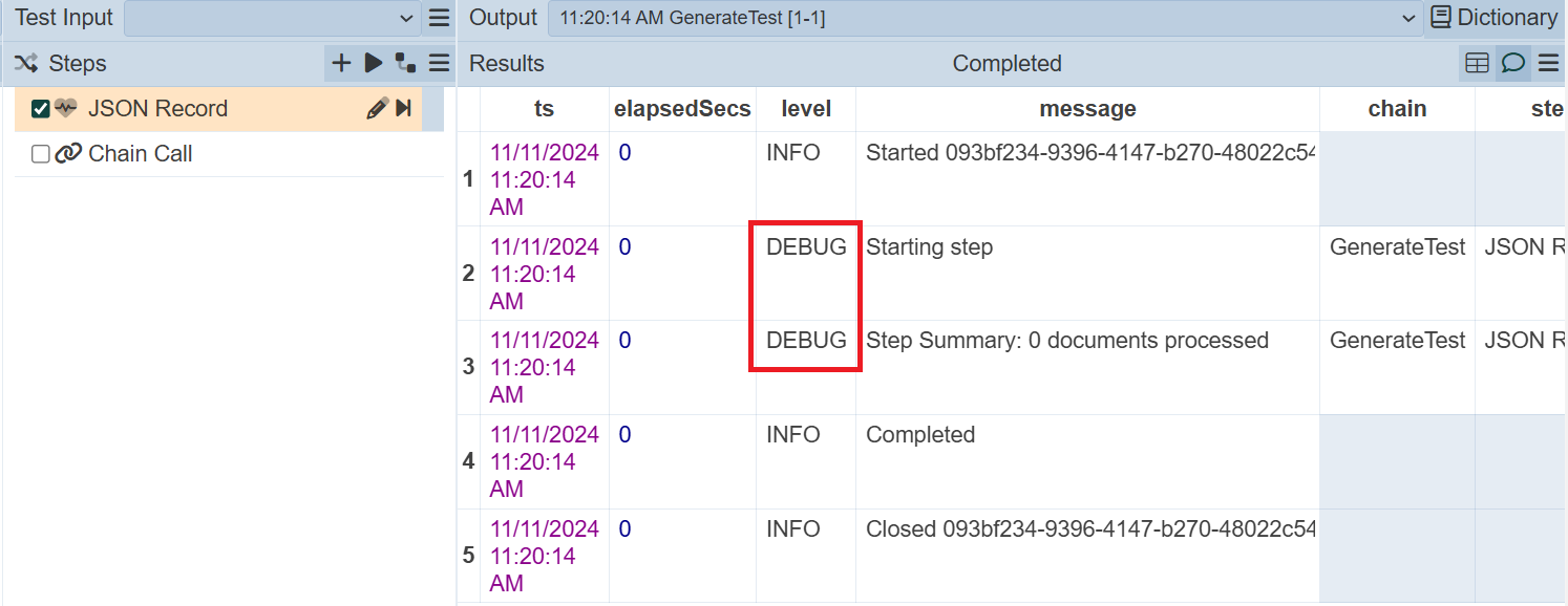

Debug Logging
User can turn on debug log to view the results of the ETL steps. This can help user to debug the ETL chain, especially during initial setup.
To do so, select the desired ETL step and click on the “More Actions” button and select the “Debug Logging On” option. The icon on the left of the ETL step will change to a heart icon, indicating the “debug mode”.
Run the ETL step and the debug log will appear in the Output panel.
To turn off the debug logging, click on the “More Actions” button and select the “Debug Logging Off” option. The icon on the left of the ETL step will revert back to the previous icon selected prior.

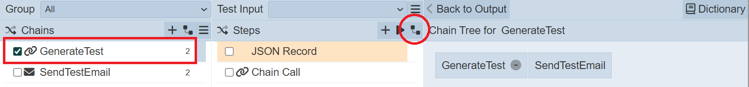

Show Chain-call Tree
Some ETL chain calls another ETL chain, thus creating dependencies.
To show the chain-call tree, select the desired ETL chain and click on the
 “Show Chain-call Tree” button in the Steps panel.
The dependency tree will be displayed in the Output panel. In the example above, the GenerateTest ETL chain calls the SendTestEmail ETL chain. Click on the “Bck to Output” button to show the Output

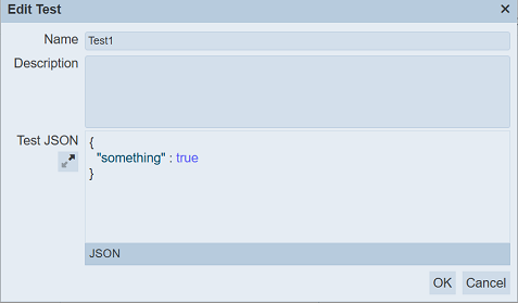

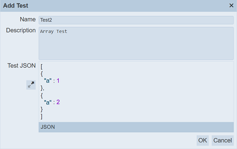

Add Test
To add a test input, click on the
 button and select the only option Add Test. The “Add Test” dialog box will appear.
In the Name field, key in an unique name for the test input and a brief description in the Description field (optional).

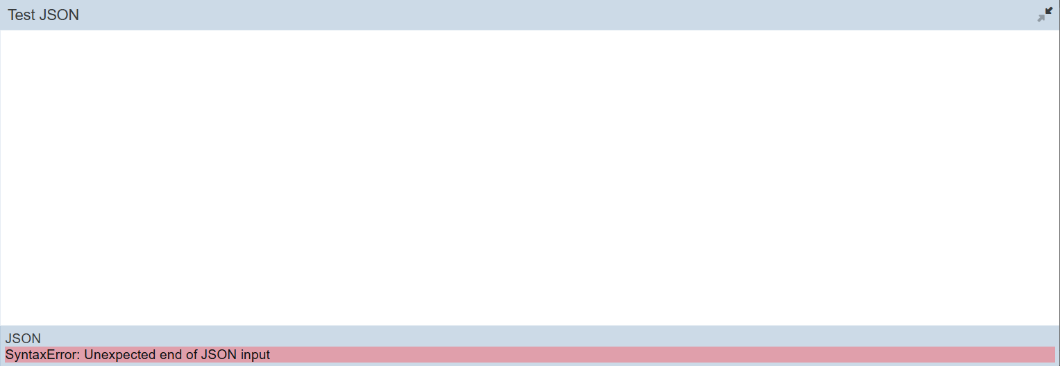

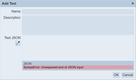

In the Test JSON field, key in the test input. The
 button next to the textbox allows you to maximise the textbox to a full screen. Error message will appear at the bottom of the dialog box if there is a syntax error in the JSON input.
To revert back, click on the
 button at the upper right corner of the page.
Click on the OK button to save the new test. A message will appear once the new test is saved successfully.

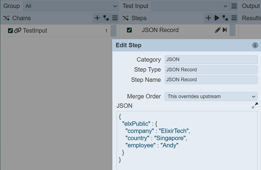

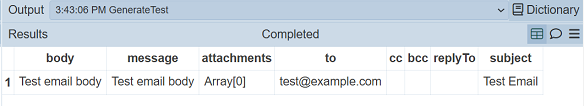

In this example, a simple ETL chain with one JSON record step is used.
When the ETL step is run without test input, the result returns as such:

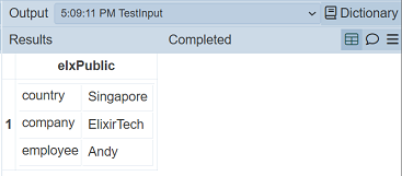

Create a simple JSON for the test input and label it as Test.

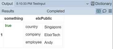

Select the Test1 from the drop-down list and run the ETL step again. The result returns with the test JSON as an input.

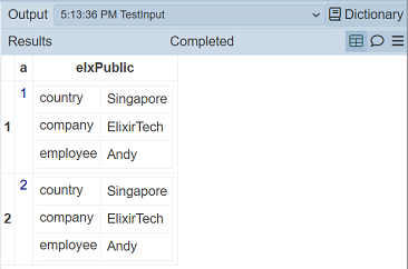

Create another test input and label it as Test2 This test input uses an array of records.
Select Test2 from the drop-down list and run the ETL step. The result return as below.
