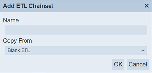

Add ETL Chainset
| Name | Unique name assigned to the chainset that would be used as its identifier. | Y | Text field | Any text. The value must not exist in the current list of names, regardless of status (enabled or disabled) and ownership. The value is case-sensitive. | Empty string |
| Copy From | Indicates what template the chainset would be based on. Selecting “Blank ETL” results in using a blank canvass as a starting point while selecting an existing chainset would result in having the selected chainset as the starting template. | Y | Select | 1 value can be selected. Options are:  - “Blank ETL” - names of all enabled chainsets the user currently has read access to  |
      “Blank ETL” |
Do note that if an option is selected from the drop-down list for the “Workgroup” field at the top of the page, any ETL chainset added to the management page will have the selected workgroup added to it. For example, if “Workgroup A” is selected, a new ETL chainet “Chainset XYZ” is added. “Chainset XYZ” will have “Workgroup A” added to its properties.

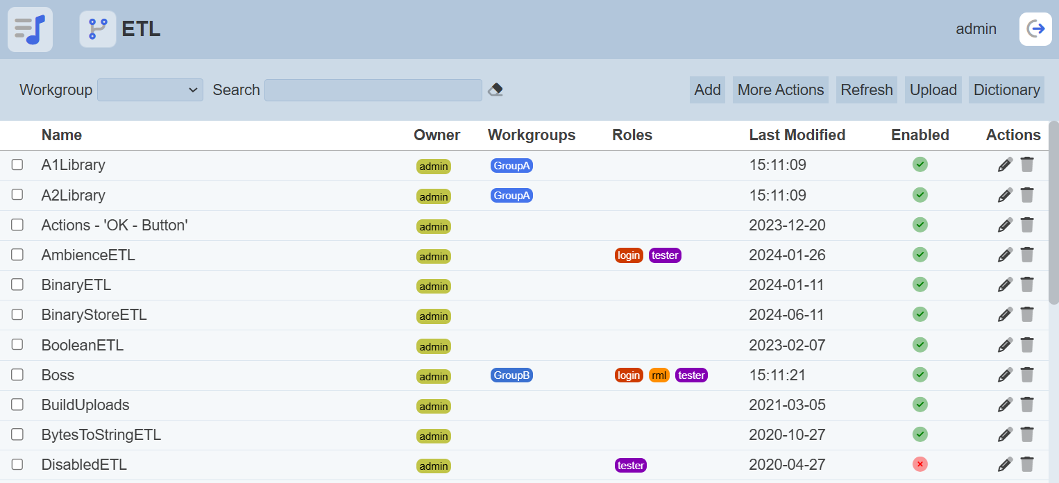

Edit ETL Chainset
To modify an existing chainset’s attributes, click on the
 “Edit” icon under the “Actions” column corresponding the said chainset.
The “Edit ETL CHainset” dialog box displays the selected chainset’s attributes.
| Name | Unique name assigned to the chainset that would be used as its identifier. | Y | Text field | Any text. The value must not exist in the current list, regardless of status (enabled or disabled) and ownership. The value is case-sensitive. | Empty string |
| Enabled | Indicates if the chainset is enabled (selected) or disabled (unselected). | Y | Checkbox | True (selected) or false (unselected) | True (selected) |
| Import Chainsets | |||||
| Search Function | Allows you to search for the ETL chainsets that starts with the string defined in this field. | N | Text field | Any text. The value is upper case and is not case-sensitive. | Blank |
| Chainsets | List of ETL chainsets. | N | Drop-down list | Multiple values can be selected. | Not selected |
Enable / Disable Chainset
Disabling a chainset temporarily makes it unavailable for all allowed read users.
To enable a disabled chainset, select the “Enabled” checkbox in the “Edit ETL Chainset” dialog box. The enabled ETL chainset will be indicated with a green tick under the “Enabled” column in the management page.
Similarly, deselect the checkbox to disable an enabled chainset. Disabling a chainset also disables using it with the ETL Designer interface for the designated roles. The owner can still access the chainset via the ETL Designer interface. The disabled ETL chainset will be indicated with a red cross under the “Enabled” column in the management page.

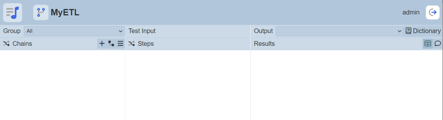

Open ETL Chainset
Click on the name of the ETL chainset under the “Name” column to load the ETL Designer.

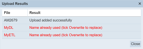

Upload ETL Chainset
Single File
To upload a single file, select the JSON file to upload by clicking on the “Choose File” button in the dialog box. THe selected file must have the filename format: <filename>.chainset.json.
Zip File
Browse to the location of the zip file to be uploaded. The name of the chainsets will be extracted from the zip file. Click on the “OK” button to upload the chainsets. The “Upload Results” dialog box will display the results of the uploading.

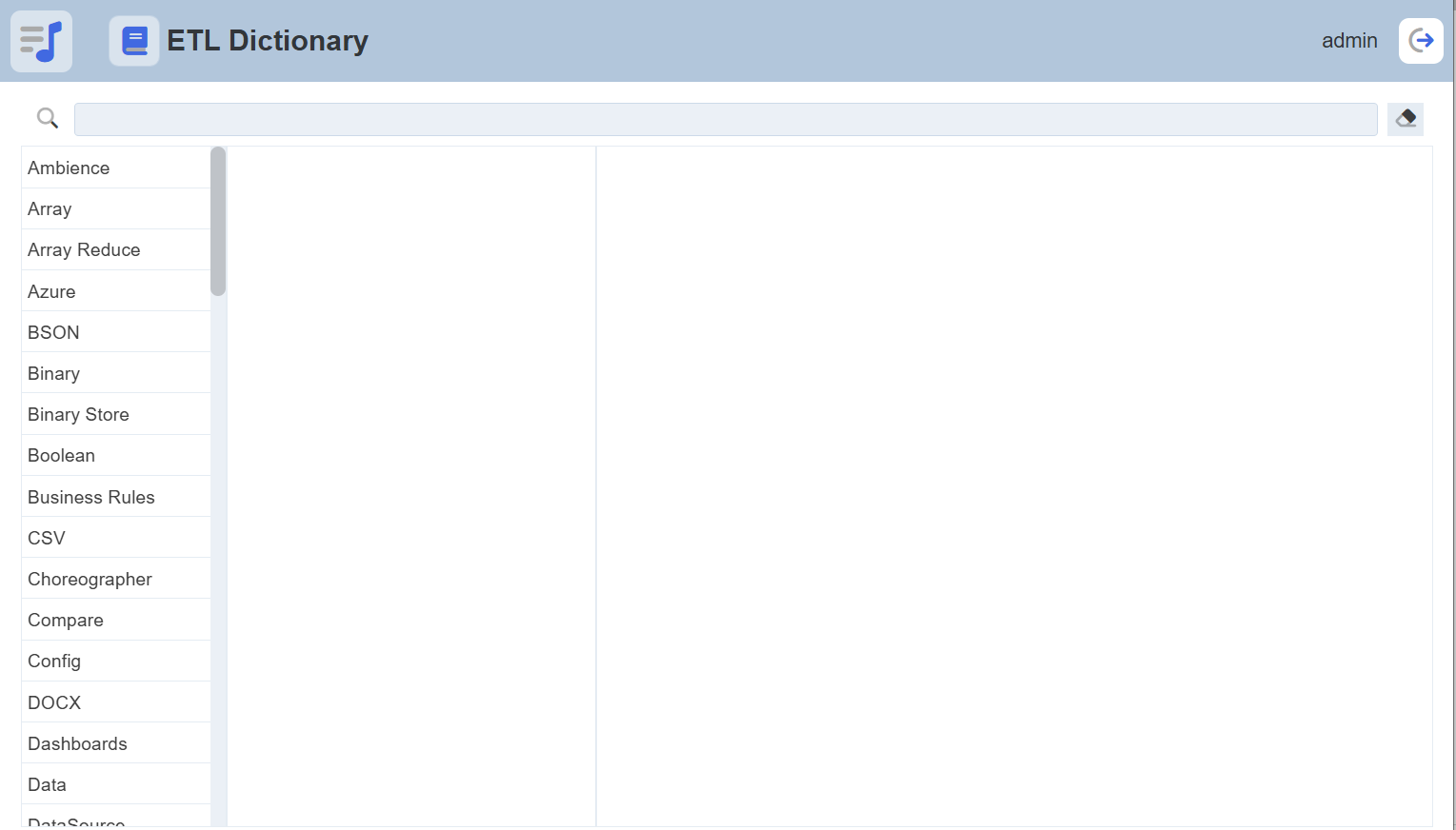

Dictionary
The “Dictionary” button at the upper right corner of the page when clicked, displays a page which allows you to search for the ETL step along with their description.
The page can be divided into several parts: The search function at the top of the page allows user to key in keyword to search for the ETL step. The left panel displays the categories of ETL. The centre panel displays the ETL steps of the category selected. The right panel displays the description of the ETL selected.

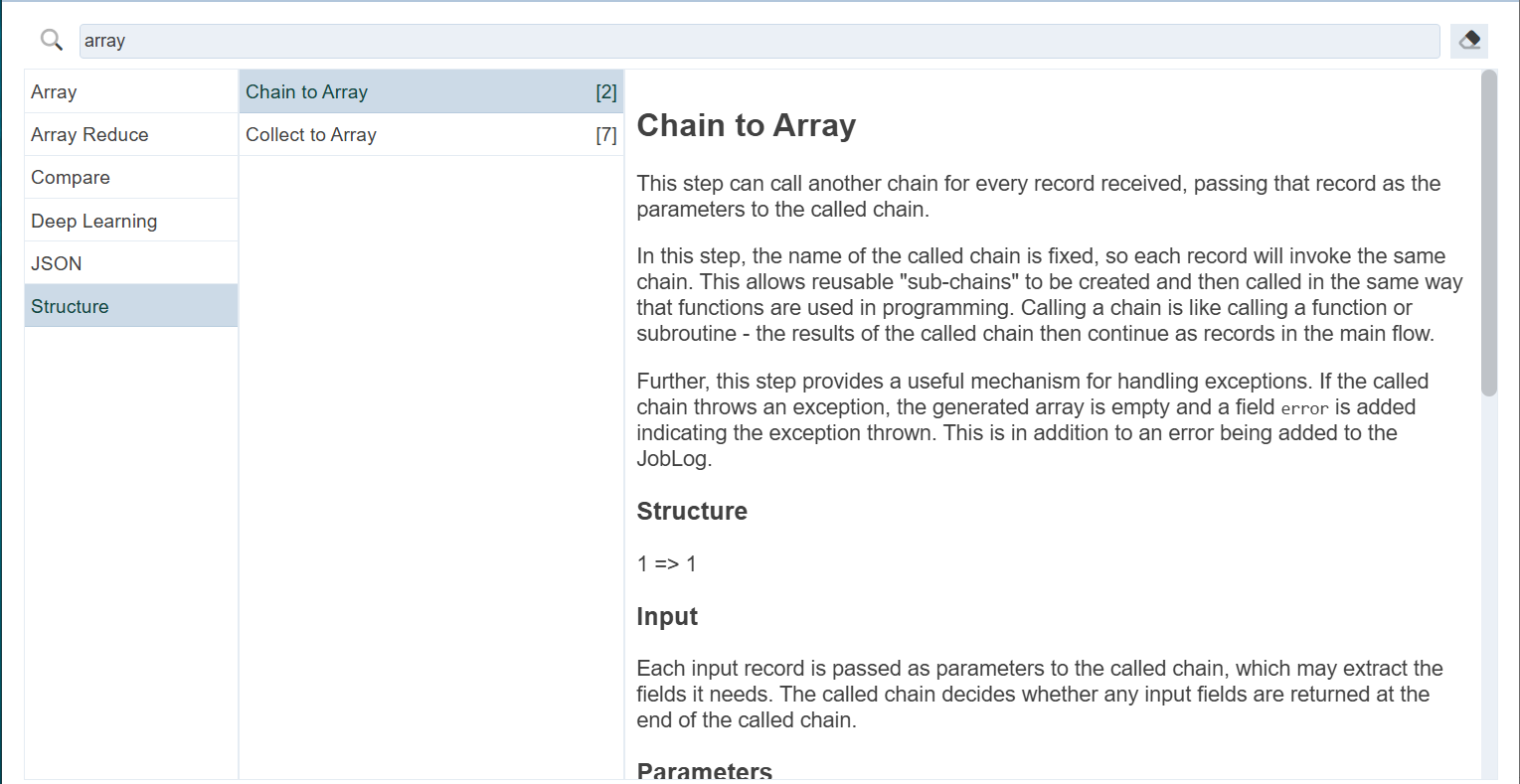

Keyword Search
To use the search function to search for a ETL step, key in a keyword, e.g. “array”. The left panel will display the categories that have ETL step(s) containing the keyword “array”. Select the desired category and the centre panel will display the list of ETL steps containing the keyword “array”. Select the desired ETL step in the centre panel. Some ETL steps may have a number in square brackets on its right. This number indicates the number of usage of the ETL step. The description for the ETL step will appear in the right panel.

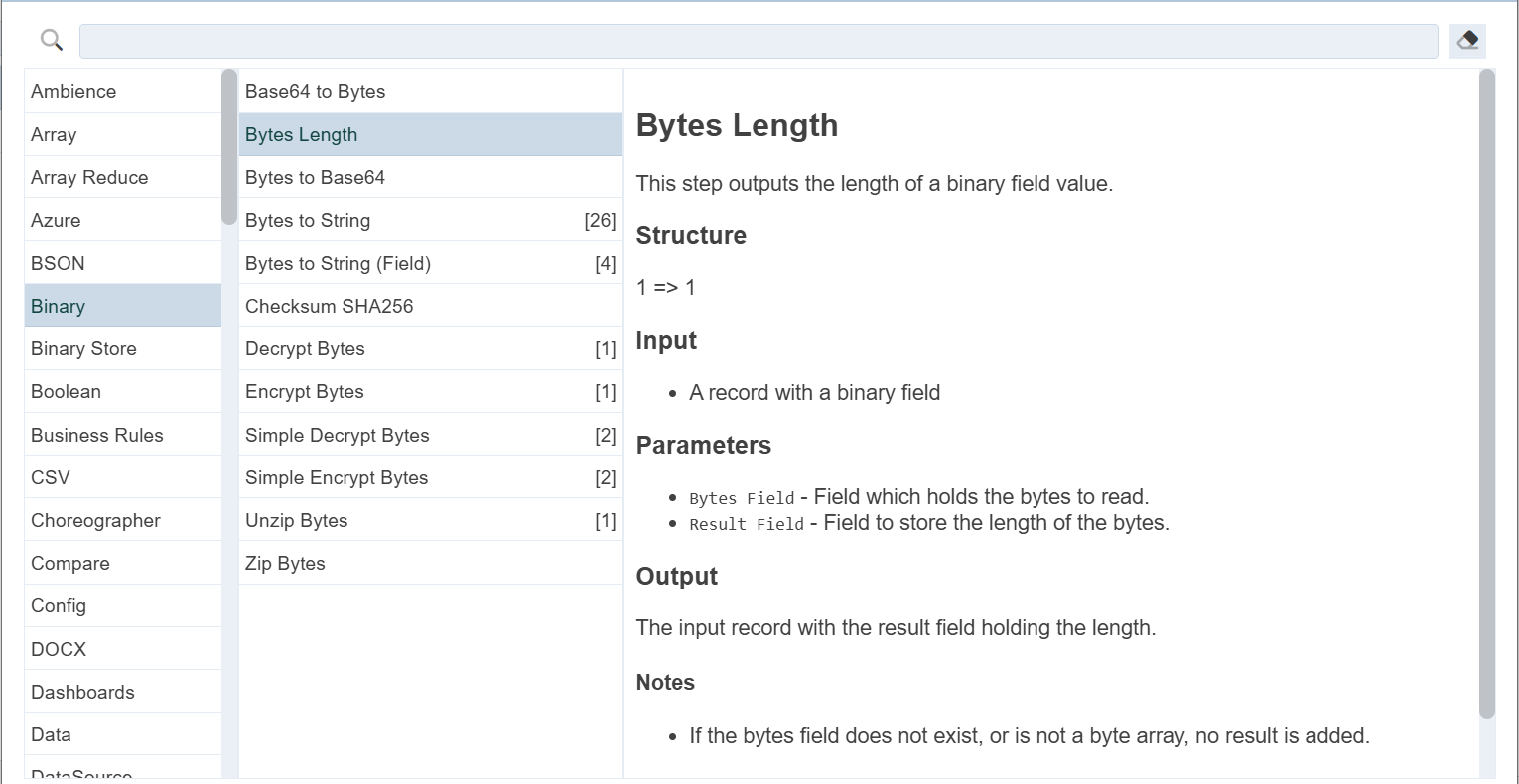

To search using category, scroll and select the desired categroy from the list of categories in the left panel. The list of ETL steps for that category will appear in the centre panel. Scroll and select the desired ETL step. The description for the selected ETL step will appear in the right panel.

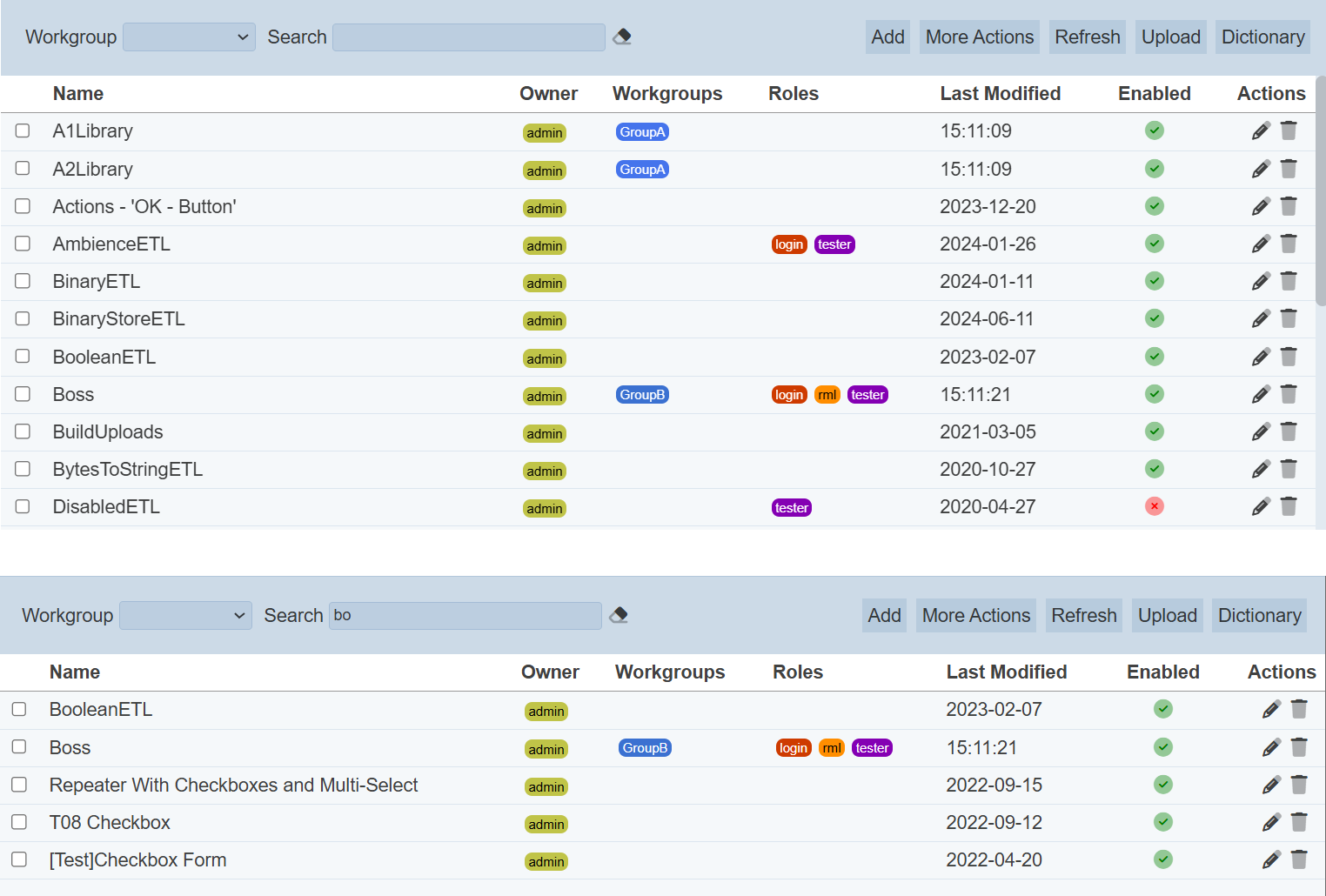

The “Workgroup” field at the top left corner of the page allows you to filter the ETLs associated with the selected workgroup.
Simply select the desired workgroup from the drop-down list and the ETLs associated with the selected workgroup will appear.

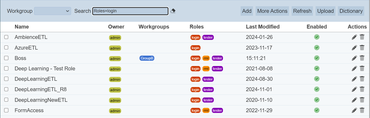

 - Workgroups
Alternatively, you can click on the any owner, orkgroup or owner under their respective columns to aid the search for the chainsets in the page.
In the example above, chainsets that are assigned the role “login” are shown.
