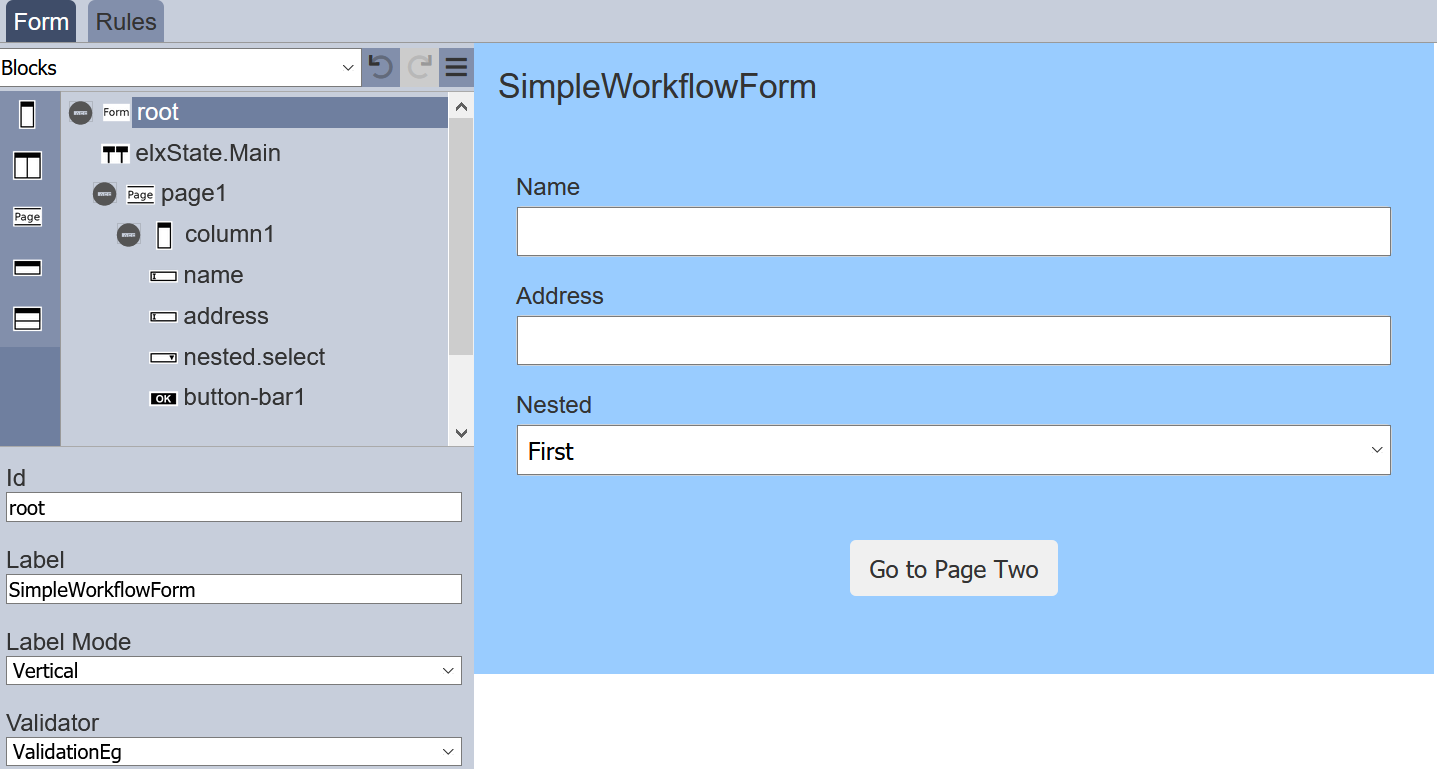

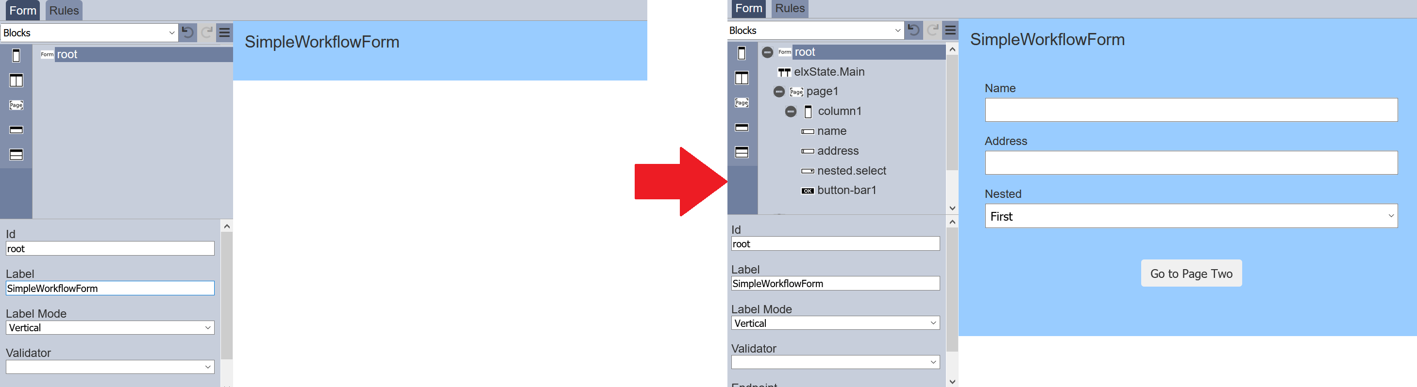

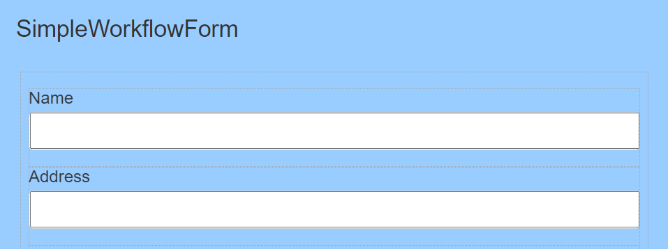

The Form tab consists of two panels. The left panel displays the hierarchy, the components and their properties of the form. The right panel displays the form, allowing to to visualise the form as you design it.
The left panel displays the available actions for the selected component in the form. It has three parts; the top row, form structure in the middle and component properties at the bottom.

To add a component onto the form, first select the “Type of Options” in the top row. The available components will be displayed in the Form Structure section. Simply drag and drop the desired component onto the desired higher level.

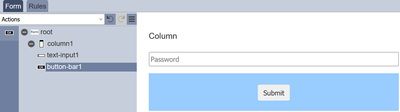

In the simple example below, a new form is created, which includes a input text field and a submit button. First, under the “Blocks” option, select “Column” and drag it to the “root”. Next, under the “Inputs” option, select “Text Input” and drag it to the column. Lastly, add a “Button Bar” under the “Actions” option to the column.

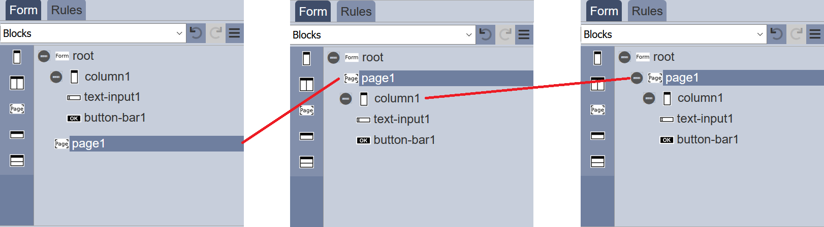

To add a page to the form, select “Blocks” from top row and select the “Page” icon on the left panel in the “Form Structure” section. Drag and drop the “Page” onto “root”. The new page will be added at the bottom of the “root” by default, if there are any components added onto the form prior adding the page. You can relocate the new page by drag and drop it to a new location in the form structure.

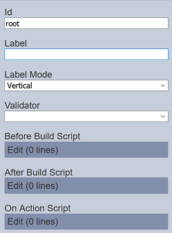

Root
Every form has a root, this is by default. The root presents the blank form itself until components are added onto it.
You can define and validate the form using its properties.
| Id | Name of the root that will be displayed in the form structure. | “root” |
| Label | Name of the form that will be displayed. | None |
| Label Mode | Defines the orientation of the form. Available options: - Vertical - Horizontal - None |
“Vertical” |
| Validator | Defines the ETL chainset to be used to validate the form. | None |
| Before Build Script | The script to be executed before any changes are applied to the current form. | Empty script dialog box |
| After Build Script | The script to be executed after every change is made to the current form. | Empty script dialog box |
| On Action Script | The script to be called when a button is pressed. | Empty script dialog box |
