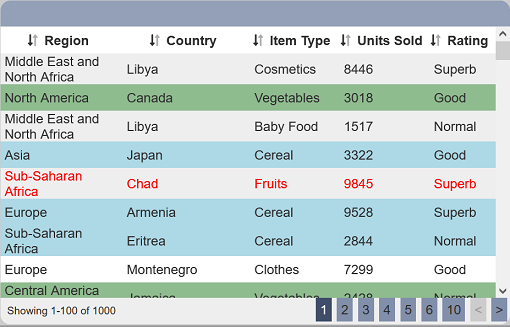

The binning or grouping is displayed in the view, in the example below, the “Rating” column. You can click on the column heading to sort the values. The linear table also has Row Foreground and Row background defined for some options under “Item Type” column, “Vegetables” having green background, “Cereal” having blue background amd “Fruits” having red foreground (text).

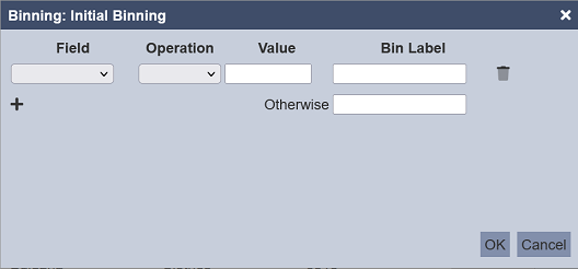

The “Binning Editor” dialog box will appear. You can change edit the current settings or add new ones by clicking on the “+” icon.
You can change the value of “Superb” bin from 8000 to 9000. Click on the “OK” button to save the changes. Click on the “Cancel” button to abort.
The “Rating” column will change according your edits, (i.e., the first data row “Rating” is changed from “Superb” to “Normal”).
Do note that this change is temporary. Once the page is exited, the pre-defined binning in the Binning Control applies. It is advisable to set the “Visibility” of this control to “Always”.

In the “Rating” control dialog box, select the same dataset and subset of the view that you wish to add into. Once the dataset is selected, the “Open Editor” button will be clickable (i.e., not greyed out). Click on the “Open Editor” button to add a new binning condition.
| Field | Description | Mandatory | Input Type | Default Value |
| Field | Defines the field to be used for comparison. | Y | Drop-down list | “None” |
| Operation | Defines the operator to be used. | Y | Drop-down list | “None” |
| Value | Defines the value to be compared to. | Y | Textbox | “None” |
| Bin Label | Defines the text to be displayed if the comparison returns true. | Y | Textbox | “None” |
| Otherwise | Defines the text to be displayed if the comparison returns false. | Y | Textbox | “None” |

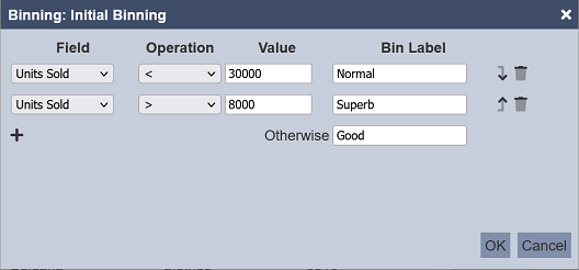

Select the appropriate values and text accordingly. To add more binning condition, click on the
 icon on the left, below the “Field” column. In this example, 2 binning conditions are added. You can rearrange the order of the conditions by clicking on the
 or
 icons. To remove a condition, click on the
 icon.

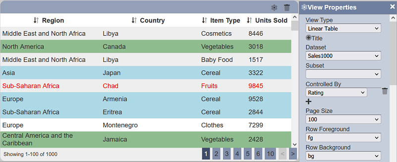

In the linear table, first add the “Rating” Binning Control in the “Controlled By” property. This will allow the “Rating” Binning Control to be added as a column into the table.
Then, in the “Columns” property, add “Rating” as one of the columns to be displayed.

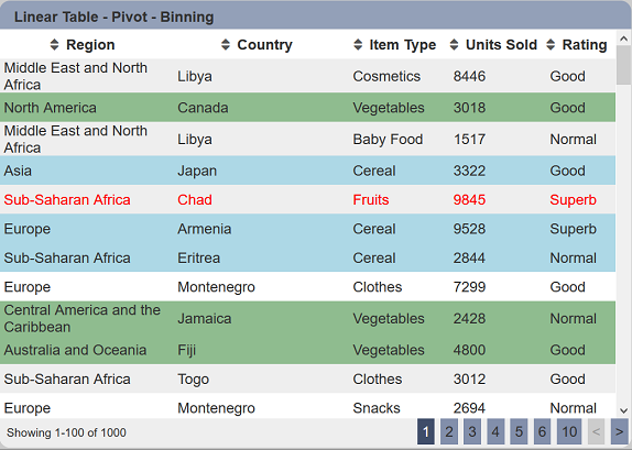

Click on the “Save” button on the upper right corner of the page. A new column “Rating” is added to the new to the linear table.
