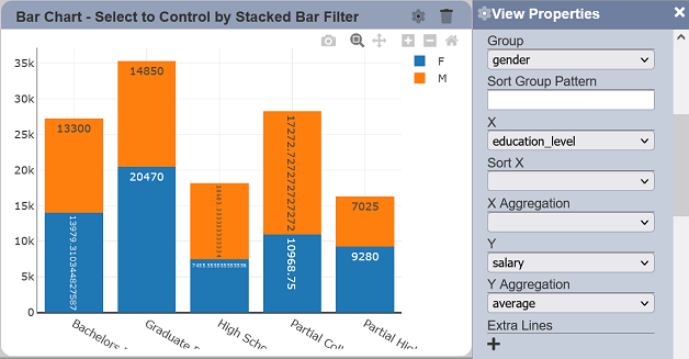

Below is an example. Create a bar chart as in the screenshot below.

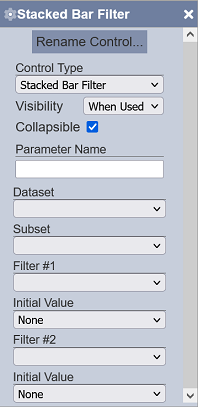

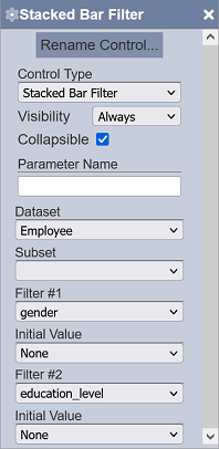

Set the Stacked Bar Filter control by selecting the bar chart’s Group By field as “Field #1”. Set the bar chart’s X field as “Field #2”.
Add the created Stacked Bar Filter control to the bar chart view’s Select to Control property.

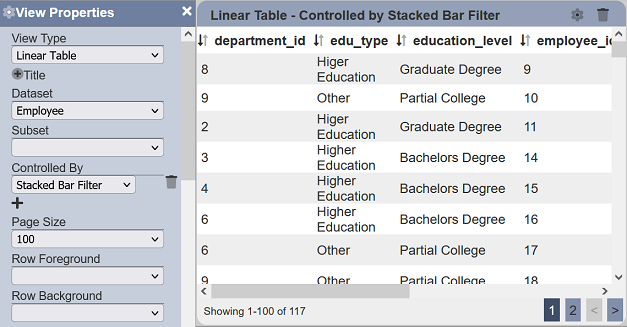

Next create a linear table using the same dataset. Add the Stacked Bar Filter control to the Linear Table’s Controlled By property.
In this example, the selection on the bar chart view controls the displayed records on the linear table view. If exactly the same dataset is used on both bar chart and linear table views, the latter would effectively display all records that are aggregated into the selected bar.

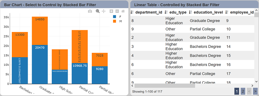

Once all are set up properly, the bar chart and line table shows all the records in the dataset.

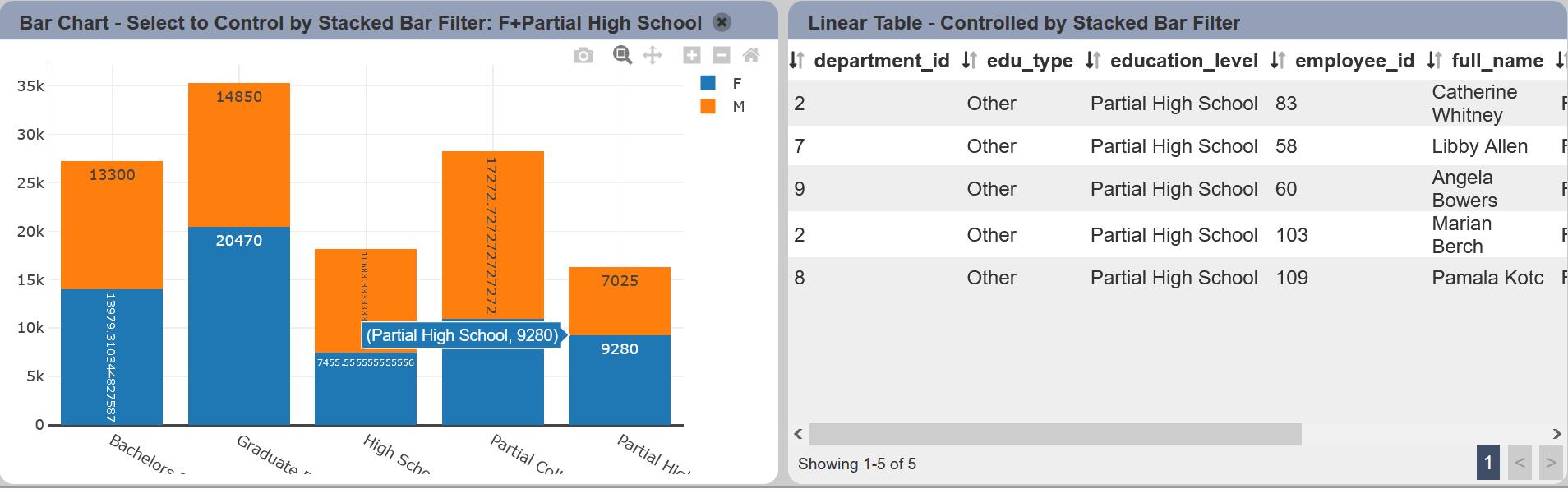

Click on any bar on the bar chart view. The displayed records on the linear table displays only the records for the selected bar.
In this case, the bar for gender “F” and education_level “Partial High School” are selected. This is also reflected on the bar chart view’s title as shown above. It appends the title given to the view, if any.
If the Stacked Bar Filter control is displayed on the control panel, the fields also reflect the selected bar’s values.
