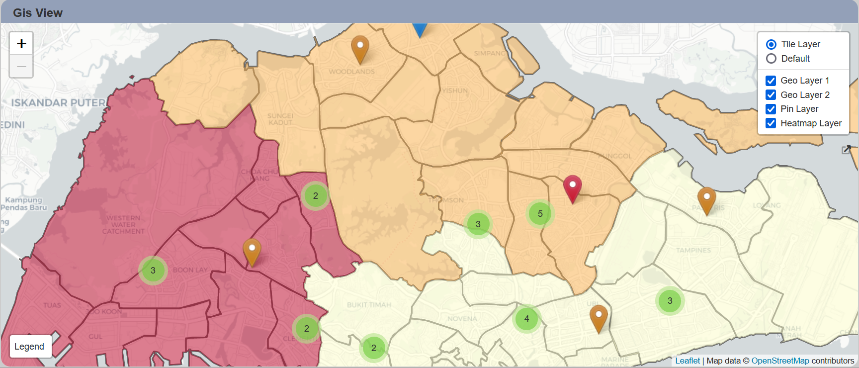

Example: Using GIS View
In the GIS view, you can perform the following functions.

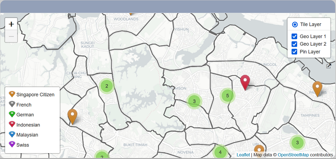

Tooltip
Depending on the settings of the GIS Explorer, when hovering over a pin, a tooltip may appear.
Popup
Depending on the settings of the GIS Explorer, when a pin is selected, a popup may appear.

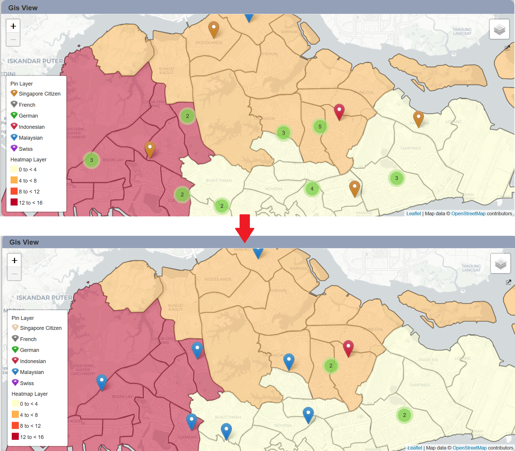

Legend
In the GIS view, at the lower left corner, you may find the “Legend”, either in collapsed or expanded mode.
The legend displayed are from the pins and heatmap layers. Only the pins legend is selectable, i.e., you can click on the desired pin legend to turn off/on the pins.
Layer Control
In the GIS view, at the upper right corner, you may find the “Layer Control”, either in collapsed or expanded mode.
In collapsed mode, a “Layer” icon will be displayed. To view the available layers, hover over the icon. In expanded mode, the available layers will be displayed on the map.

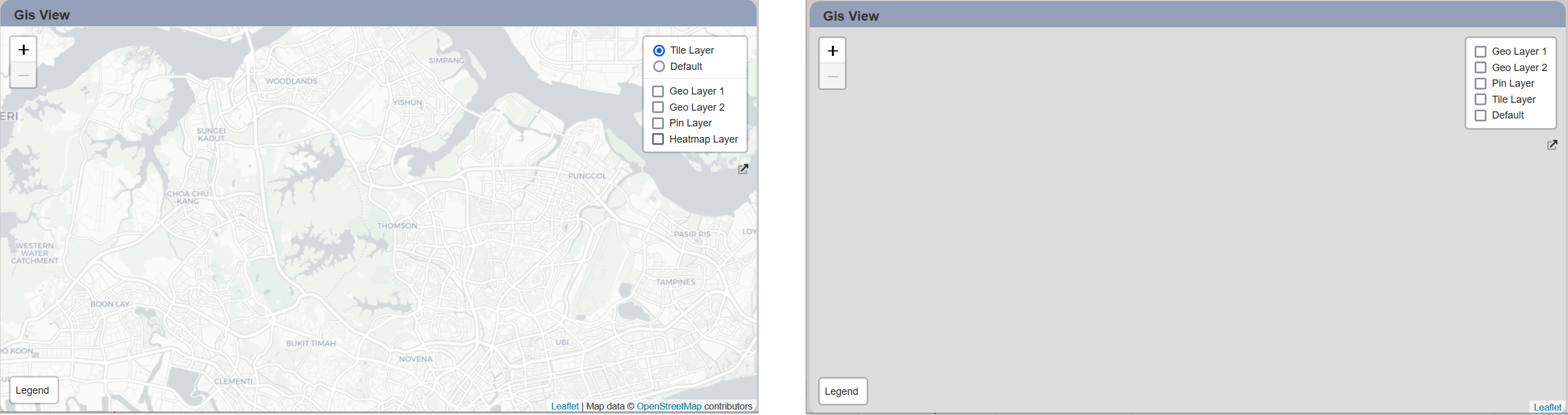

Do note that the tile layers may allow single or multiple selection depending on the settings in the GIS Explorer. In single selection mode (default), one tile layer is selected at any one time. In multiple selection mode (set to be control as layer), the tile layer may have more than one layer selected or turned off (none selected). Turning off all tile layer is not advisable as you will not see any map in the view. If more than one tile layer is selected, depending on the opacity of the tile layers, you may see two tile layers overlapping each other.
For the other layers, you may turn the layers on or off by selecting or unselecting their respective checkboxes.
By un-selecting all layers, a plain map without any pins will be displayed (see screenshot on the left). In the case where the tile layer is in multiple selection mode, a blank view will appear (see screenshot on the right).
