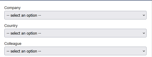

Example: Using Cascade Group
Below is an example of using Cascade Group component to create a form with cascading input select.

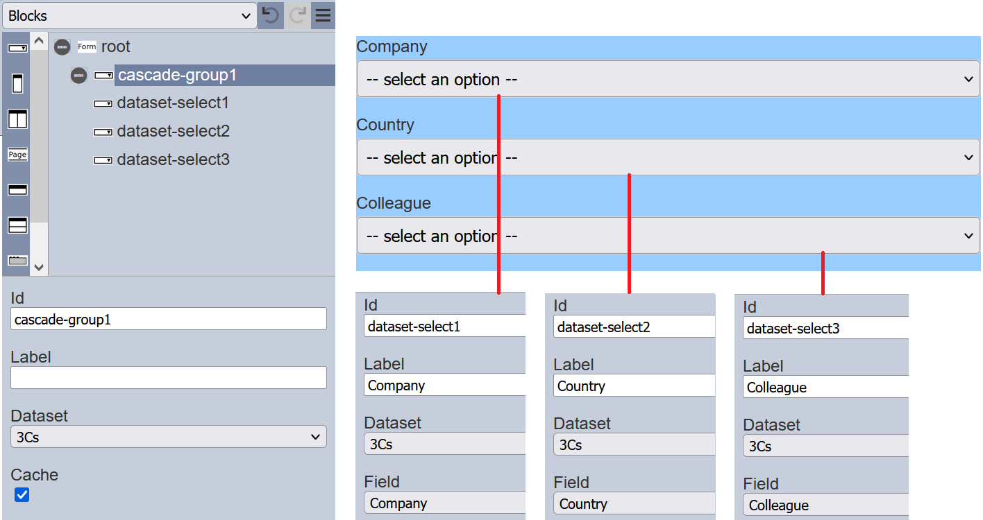

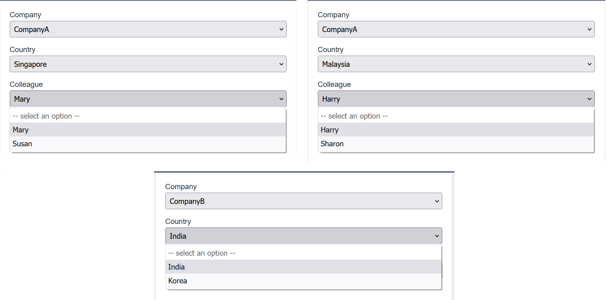

Add a Cascade Group component onto the form. Select the desired dataset to be used in the “Dataset” field. Then add three Data Select components onto the form. Set up the components are per the screenshot below.
Run the form without any workflow.
Select the any option in the “Company” field. The available options for the selected option will appear in the “Country” field. Depending on the option selected in the “Country” field, the available options for the selection option will appear in the “Colleague” field.
In the example above, different option selected in the “Company” field gives a different set of options in the “Country” field. And the different option selected in the “Country” field will give a different set of options in the “Colleague” field.

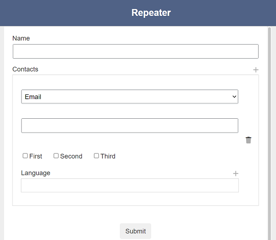

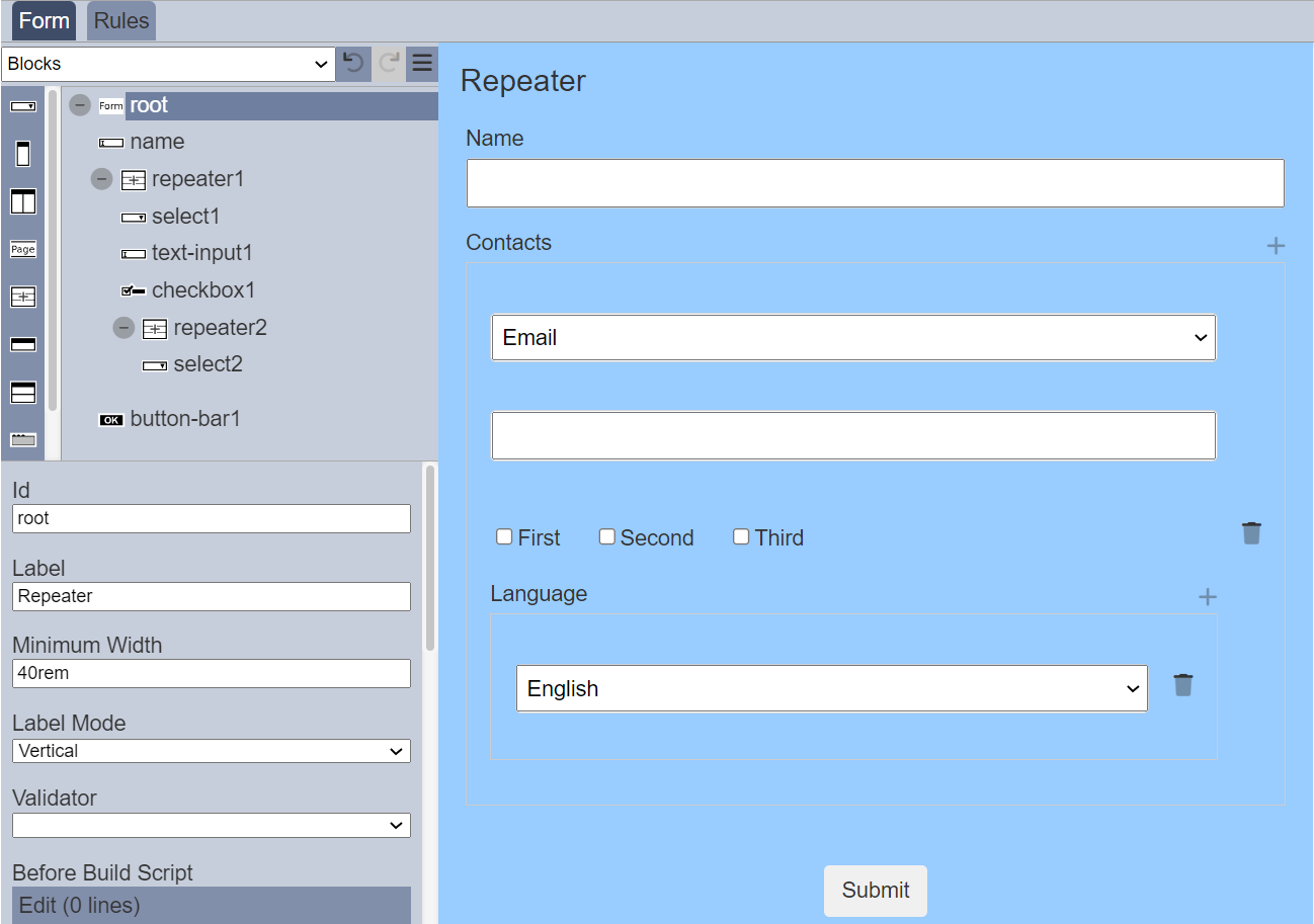

In this example, two Repeater components are used in the form.

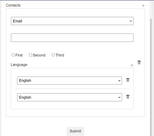

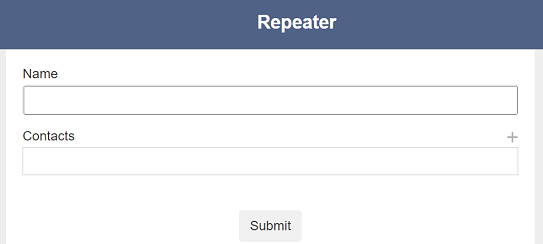

When the form is run, by default the repeater is minimised.
The first Repeater component is the “Contacts” section and the second Repeater component is the “Language” section. To add a contact, click on the “+” icon on the right of the “Contacts” section. The “Contacts” section will expand and display the components within it. To add more contacts, click on the “+” icon and the Repeater component will duplicate itself and display in the form.
To add a language, click on the “+” icon on the right of the “Language” section.
Select the desired language from the drop-down list. To add more languages, click on the “+” icon again.
To remove a language, click on the
“Delete Row” icon next to the language selected. A pop-up dialog box will appear cautioning the action.
To confirm, click on the “OK” button to delete the language. Click on the “Cancel” button aborts the action.

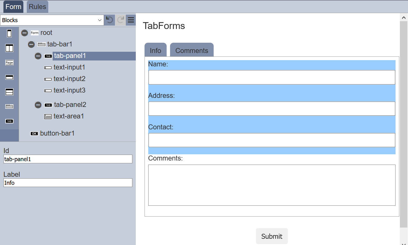

Example 1: Using Tab Bar and Tab Panels
The simple example below creates a form with two tabs.

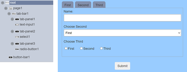

Create a form with the following components under the root. The Tab Bar component (tab-bar1) is first added to the root, which places a placeholder to display the labels of the subsequent Tab Panel components that are added.
Two Tab Panel components (tab-panel1 and tab-panel2) are added under tab-bar1. Change the value in “Label” fields as “Info” and “Comments” for tab-panel1 and tab-panel2 respectively.
The two labels will appear in the Tab Bar (tab-bar). This will allow you to switch between the two tabs. Add the Input components into the two Tab Panel components and the Action component onto the root. Do note that the Input components will appear in the right panel of the Form Designer according to the sequence they are added into the form structure.

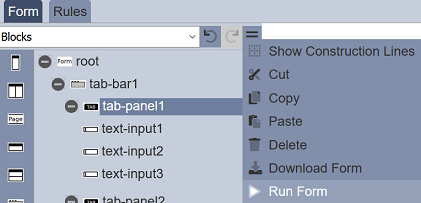

“More Actions” icon at the upper right corner of the Top Row and select “Run Form”.
In the “Run Form” dialog box, select the “No Workflow” option (as this is just an example, there are no workflow). Click on the “OK” button to run the form.

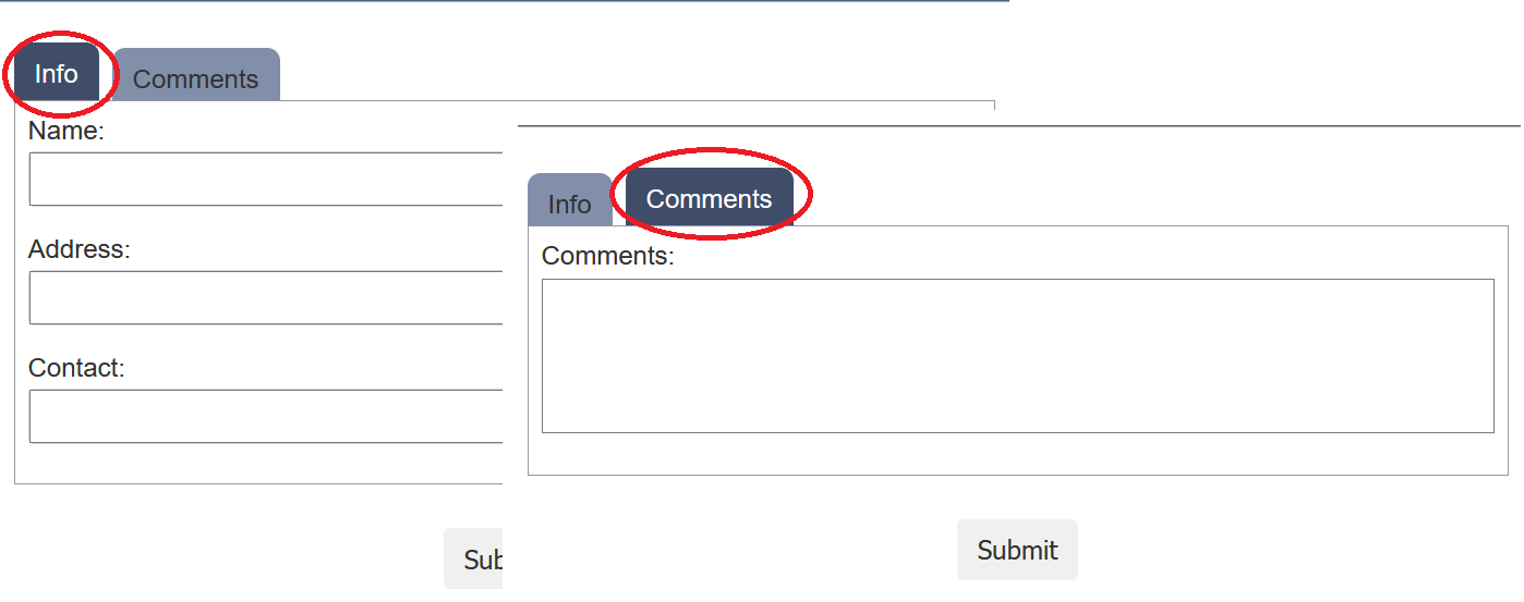

In the tab that the form appears, the default tab will be the first tab, in this case, its the “Info” tab. To go to the next tab, click on the tab “Comments” at the top.

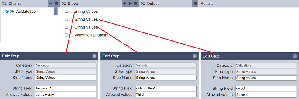

In the ETL module, create an ETL chainset to validate the input from the fields.
The ETL steps specify the values allowed, any other values will return as an error.
In the “root” of the form, select the ETL created above in the “Validator” field. In the “page1” component, select the ETL chainset in the “Validator Chain” field.

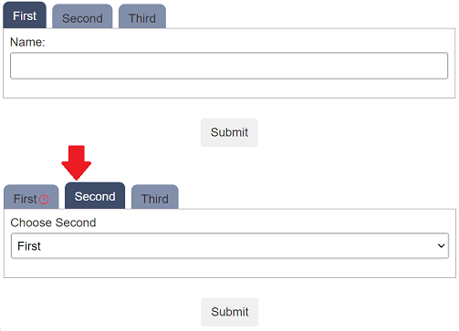

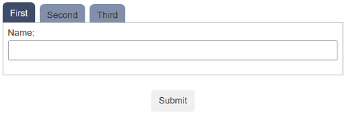

In the “First” tab, do not enter anything into the “Name” field, simply click the “Submit” button. A red exclamation mark will appear in the tab and an error message will appear in red next to the field.
To enhance the error handling, in the “tab-bar1” component, select the field “Validate On Change”.
When this field is selected, will calls the validation ETL each time a tab is changed. However, it does not update all the errors, only the ones in the current tab the user is moving away from.
Run the form again and click on the “Second” tab.
The red exclamation mark appears in the “First” tab. The other two tabs do not show any errors as no values are selected yet.
