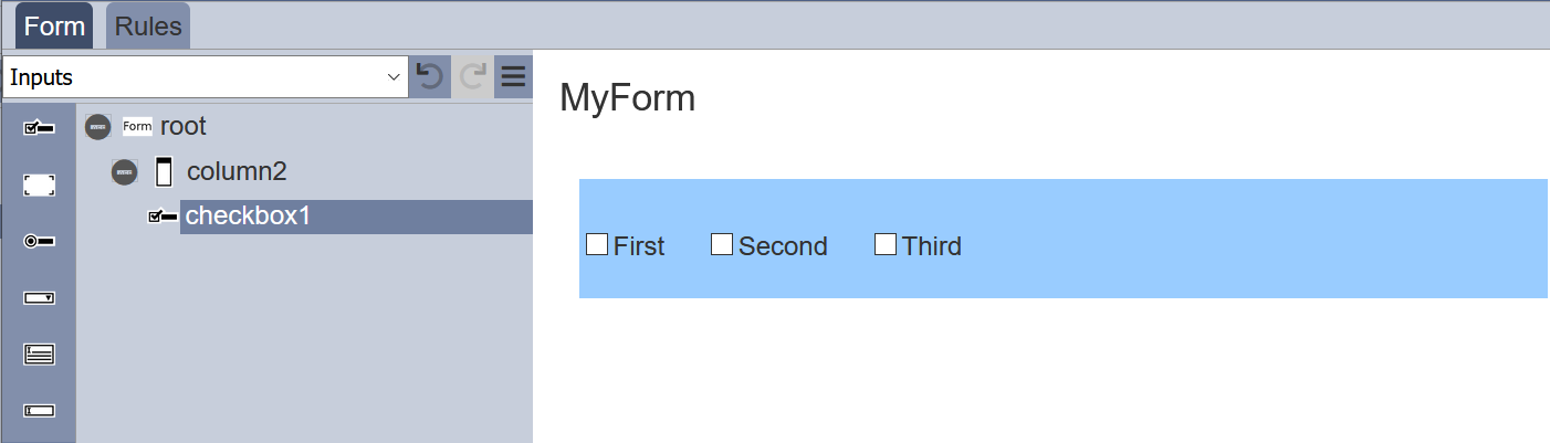

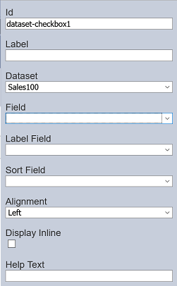

Checkbox

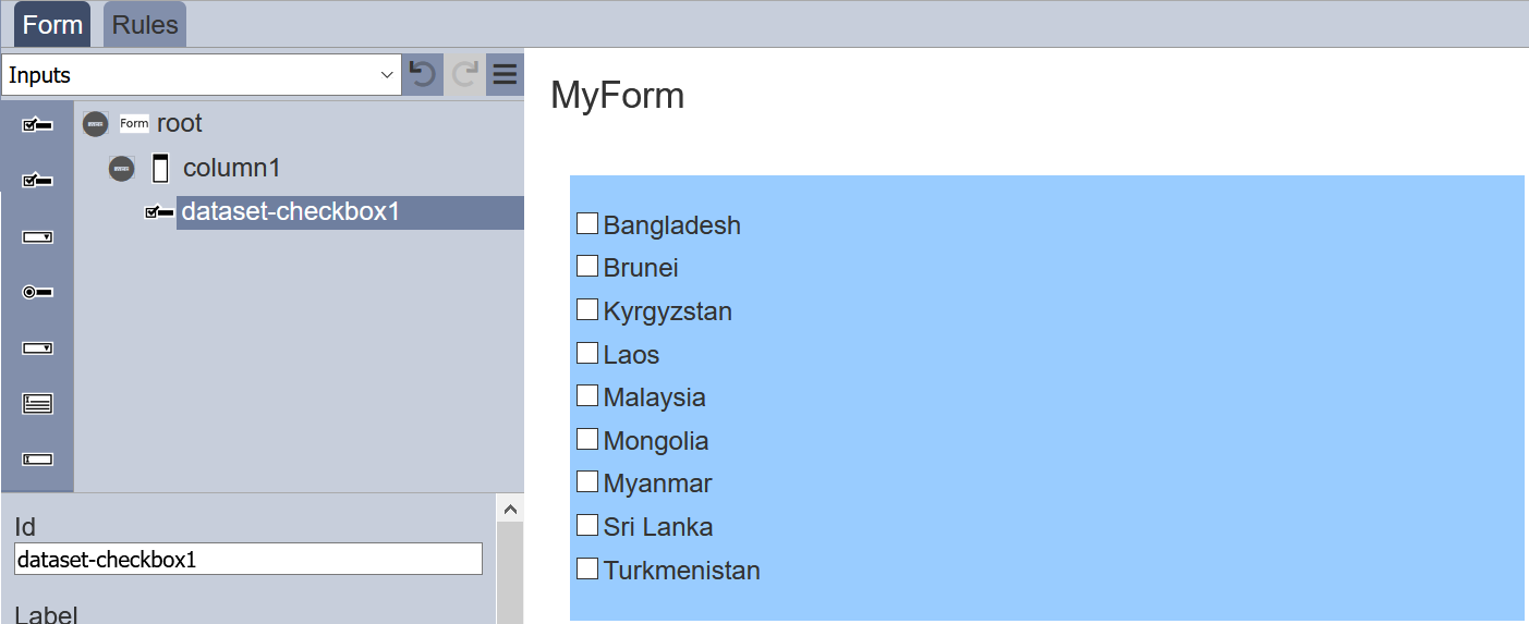

Dataset Checkbox
| Id | Name of the component that will be displayed in the form structure. | “dataset_selectX” |
Left |

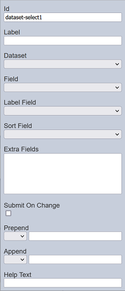

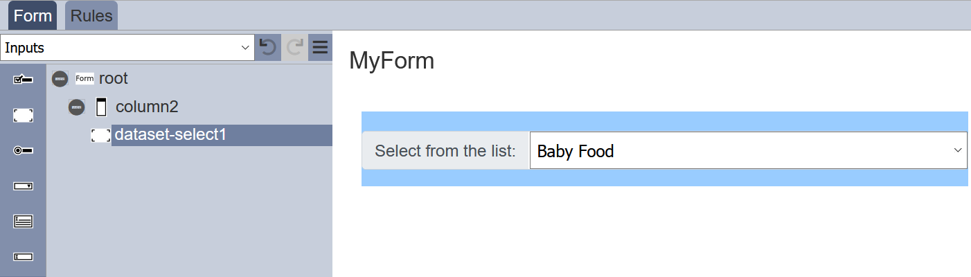

Dataset Select
| Extra Fields | Lists the extra fields to be used by other component (such as Derived Text). | None |

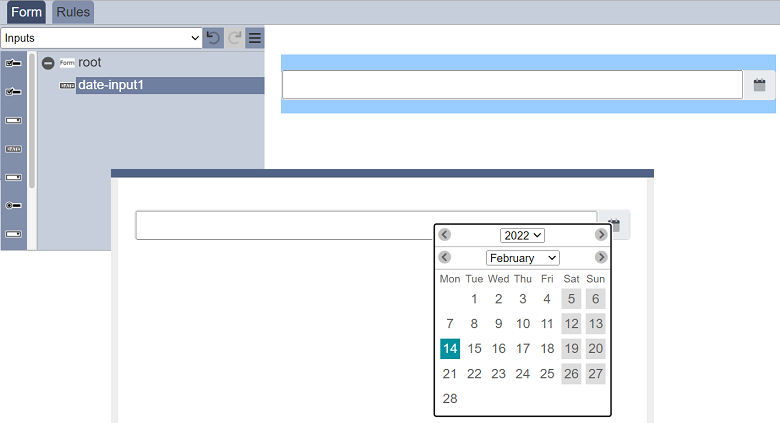

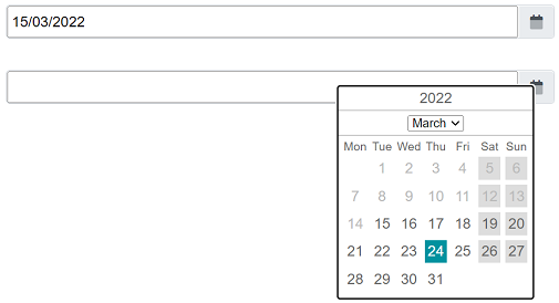

Date Input
The Date Input component allows you to add a date selection option in the form of drop-down list onto the form.

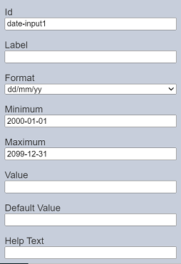

| Id | Name of the component that will be displayed in the form structure. | “date-inputX” |
| Format | Selects the format of the date. Available options: - “yy/mm/dd” - “dd/mm/yy” - “mm/dd/yy” |
“dd/mm/yy” |
| Minimum | Sets the lower date range for selection in the date picker. | “2000-01-01” |
| Maximum | Sets the upper date range for selection in the date picker. | “2099-12-31” |
| Value | Defines the initial value. If left empty, today’s date is used. |
None |
| Default Value | Defines the default value when “Value” field is empty. It can either be a fixed date or a relative date. |
None |
Set Max/Min Dates
The “Value” field defines the initial date value. If it is left empty, today’s date is used. While the “Minimum” and “Maximum” fields set the lower and upper date ranges for selection in the date picker. If these values are not defined or the syntax is wrong, the default values will be used.
All these values can either be absolute dates or as relative offsets. The allowed offsets are:
[+/-][0-9]+[dmy]
You can define the field as a relative value, e.g., +5d, -23y or +3m, etc. If today’s date is 2022-01-01, +5d will constitute 2022-01-06.
Date Range
You can also set a data range using two data input components.
To do so, add two date input components onto the form. Set the “Minimum” and “Maximum” fields in the date input components as below. Do note the “Id” of the components are changed.
The form will appear as a pair of date pickers which limit the available choices.

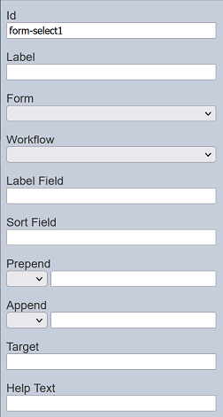

Form Select

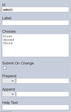

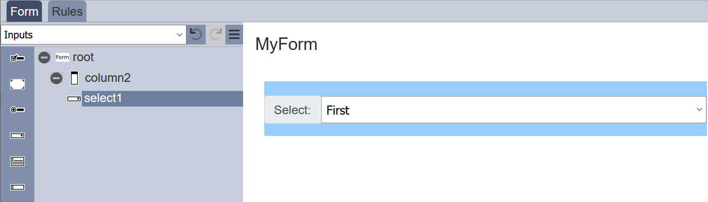

Multiple Selection
| Choices | Defines the drop-down choices on the form. | “First”, “Second”, “Third” |

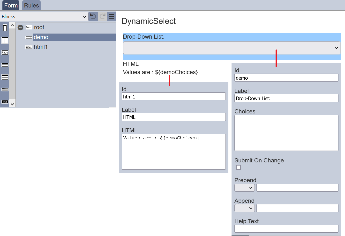

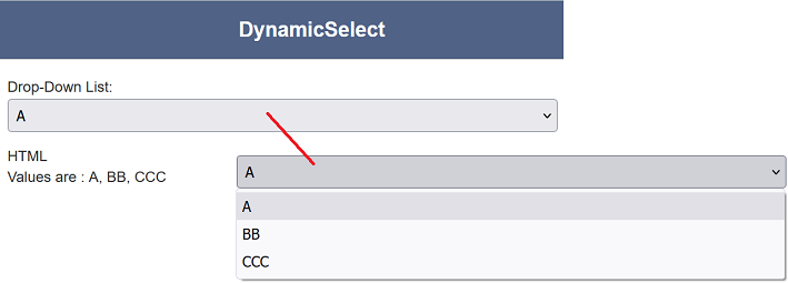

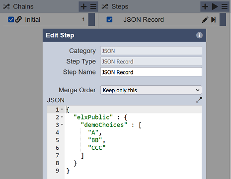

Dynamic Select
The choices for the Multiple Selection component can be edited using the “Choices” field in its properties. This make the choices static, which means it cannot be changed unless the “Choices” field is edited.
First, create an ETL chainset using the ETL module. Add a “JSON Record” ETL step that initialises the elxPublic with the choices for the form.

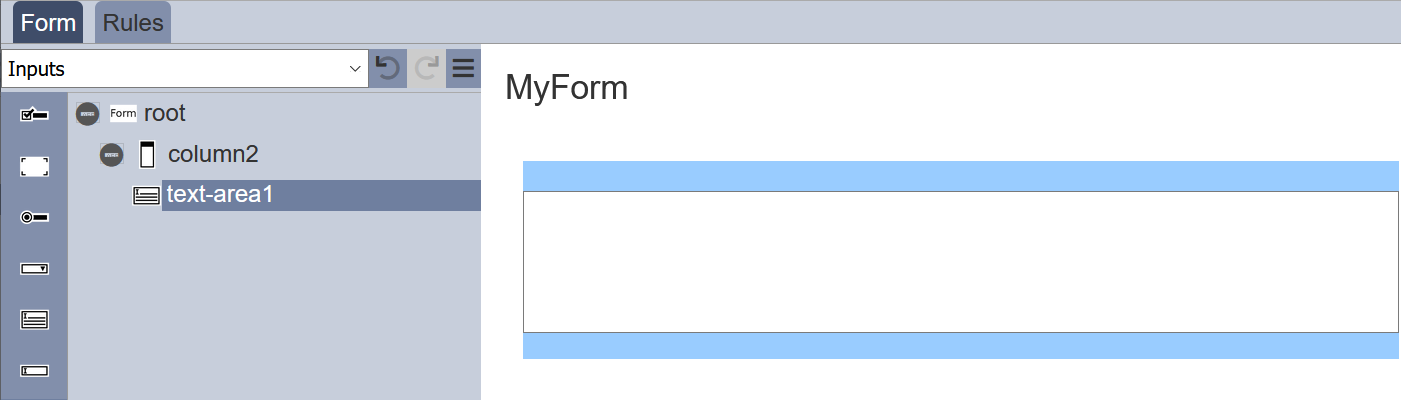

Text Area

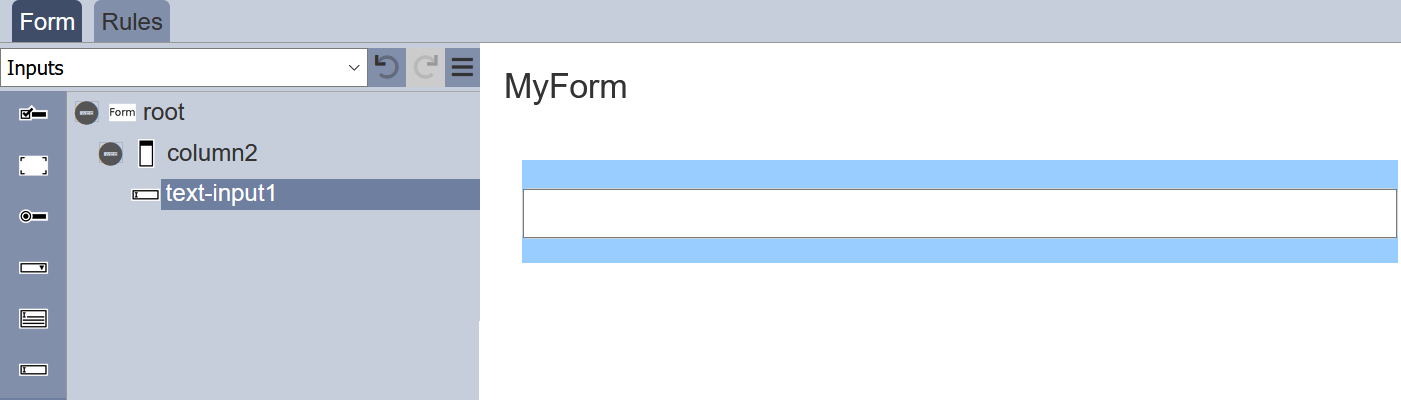

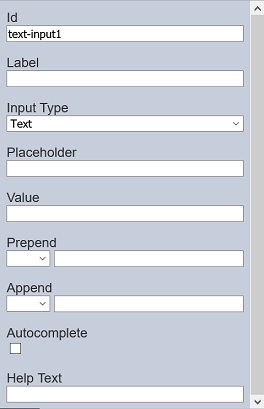

Text Input
| Input Type | Selects the type of input. Available option: - Text - Password - Number - File |
“Text” |
None |

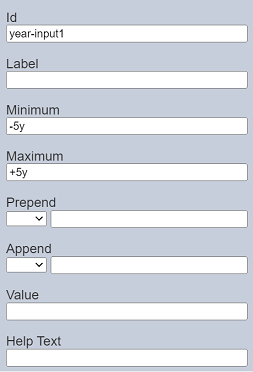

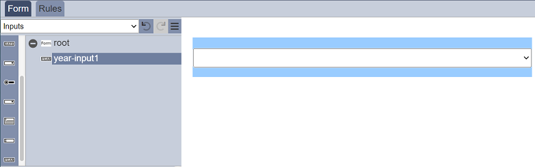

The Year Input component allows you to select a value from a range of years from the drop-down list.
| Id | Name of the component that will be displayed in the form structure. | “year-inputX” |
| Minimum | Sets the lower range in the year selection based on current year. | “-5y” |
| Maximum | Sets the upper range in the year selection based on current year. | “+5y” |
| Value | Defines the initial year value. If undefined, blank is displayed. |
Blank |
The “Minimum” and “Maximum” fields defines the lower and upper range for the year selection based on the current year. The default values are -5y and +5y respectively. If this year is 2022, the year range for selection will be from 2017 to 2027.
