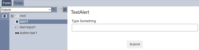

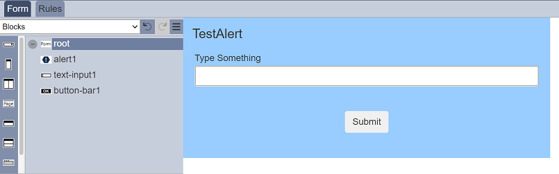

Create Form
In the Forms module, create a simple form named “TestAlert” with the following components:
- Alert component
- Text Input component
- Button Bar component

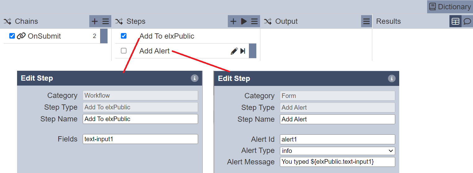

Create ETL
In the ETL module, create an ETL chainset named “OnSubmit” with two ETL steps.

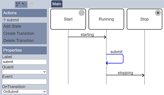

Create Workflow
In the Workflow module, create a simple workflow and name it “AlertWorkflow”.
In the “submit” transition, select “OnSubmit” ETL from the drop-down list in the “OnTransition” field.

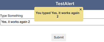

In the form, enter any text in the textbox and click on the “Submit” button. A pop-up box will appear prompting you the text you have entered in the textbox.
Click on the “X” button to close the pop-up box.
