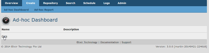

To login and create a new dashboard:
Login to the Adhoc Dashboard application.
Click Create - Ad-hoc Dashboard and then click Cars , to use the Cars universe for your dashboard, as shown in Figure 2.1, “Create Ad-hoc Dashboard”:
Select a location in the repository from the drop-down list, as shown in Figure 2.2, “Select Repository Location”. Enter the file name and click Create.

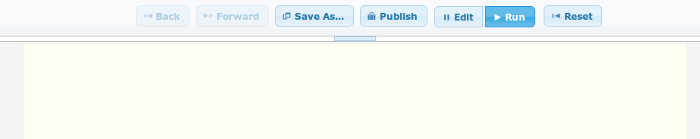

The system creates a blank dashboard and opens it in
Run
mode, in a new browser tab as shown
in Figure 2.3, “System
Creates a Blank Dashboard”.

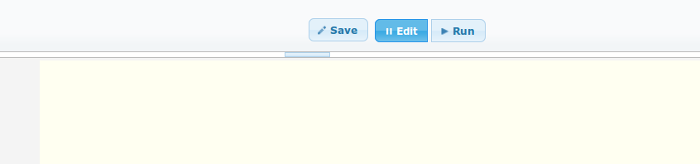

To edit the dashboard, click
Edit. The dashboard changes to Edit
mode as shown in
Figure 2.4, “System
Dashboard
in Edit Mode”.

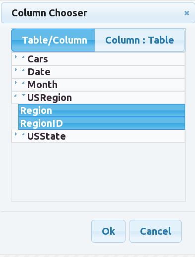

Click the icon.
Select the Region and Region ID columns as shown in Figure 2.5, “Select the Region Table”.
You can select multiple columns across tables as required. The system is smart to figure out the relationships between the entities and present you the data seamlessly.
This populates the grid with the four US regions.

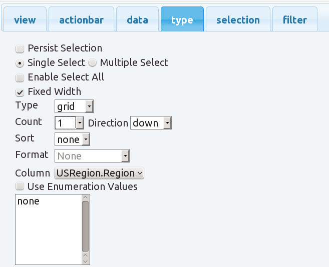

Region
as shown in Figure 2.7, “Set the Type
of the First Grid”.
The Count
and Direction
properties
define the layout of the grid.
The Count value indicates that the grid is to have one row of data. The grid is set as a single selection grid - only one value from the grid can be selected at a time.

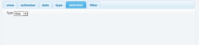

first
as shown in Figure 2.8, “Set the
Selection of the First Grid”.
This indicates that the first value on the grid is selected by default.

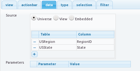

Grid
component to the workspace, and align it below the first grid.Grid
component in the workspace and select Properties.
US State
as shown in Figure 2.10, “Set the Data
Properties of the Second Grid”:

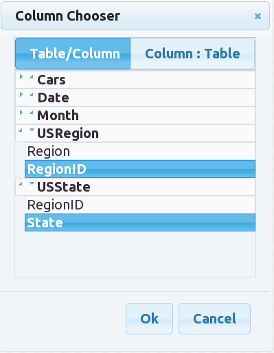

Click the icon.
Select the State and Region ID columns as shown in Figure 2.9, “Select the State Table”.
This specifies that the US States should be displayed on the grid.

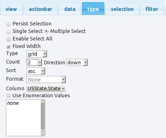

The Count
and Direction
properties
Here, you also set the Count as 2 - indicating that the grid is to have two rows of data, and the direction as Down, which specifies that the rows are to be one below the other.
In addition, the grid is set as Multiple Select. This allows multiple selection of values from the grid.
Set the sort order to ascending. This sorts the State codes in alphabetical order for display.

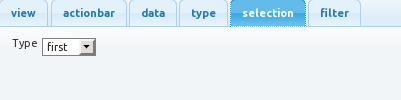

first
as shown in Figure 2.12, “Set the
Selection of the Second Grid”.
This indicates that the first value is selected and highlighted by default.

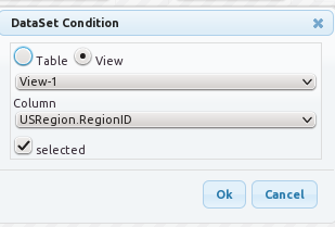

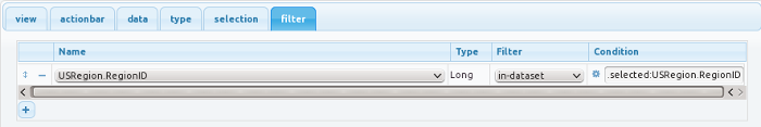

Here, you select to filter values based
on the common column RegionID, that is present in the first grid (the Region
grid), that is named
as View-1
on your dashboard.
The values are then filtered, and only the States that correspond to the Region selected in the first grid, are displayed in this second grid.
The filter after selection, is shown in Figure 2.14, “The Selected Region Filter”

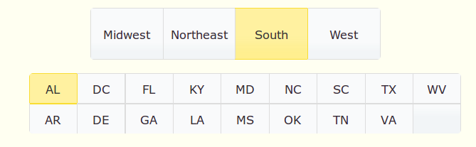

Run
mode and check that your grid selection works.
Select the Regions from the first grid
and watch the second grid automatically
display only those states that correspond to the selected region from the first
grid.

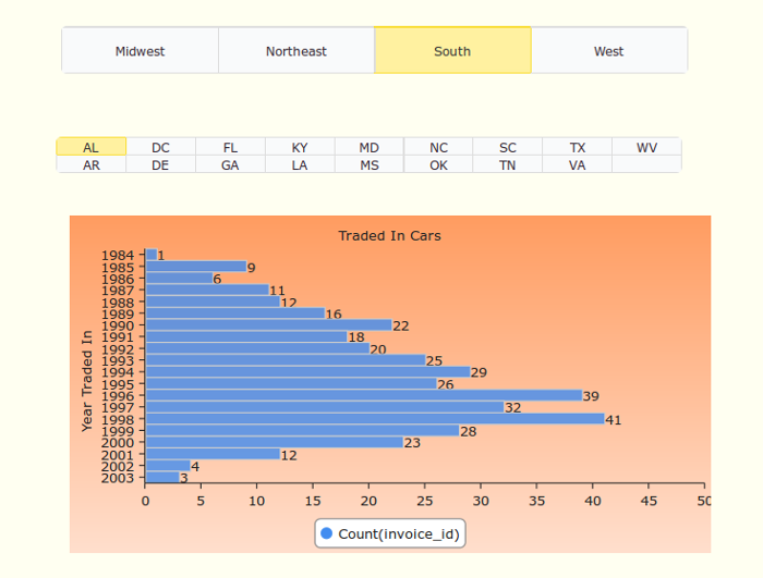

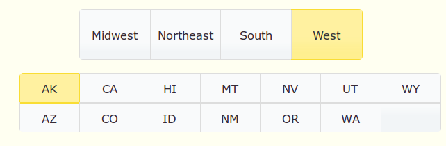

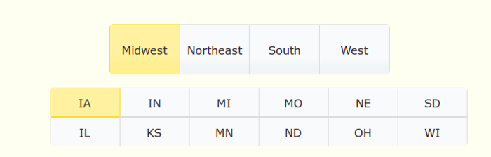

Here are some screen shots that show you how the grid selection works:
Midwest:
Northeast:
South:
West:

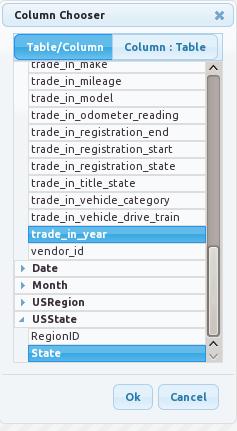

invoice_id
and trade_in_year
columns
from the Cars
table. Also
select the State
column from the
US.State
table.
This is shown in Figure 2.19, “Set the

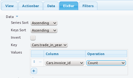

Data Properties of the Bar Chart”Navigate to the
ElxBar tab and set the Key to
trade_in_year
. The years are plotted on the Y-axis.
In the Values table, set the Column
to invoice_id
and the Operation to
Count
The total number of traded-in invoices for each year is plotted on the X-axis. This denotes the number of cars traded-in for the year.
This is shown in Figure 2.20, “Set the ElxBar Properties of the Bar Chart”

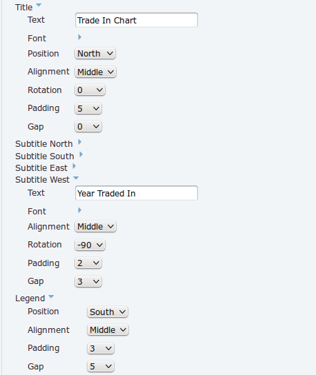

From the ElxBar tab, set the Chart Title, the Y-Axis Title (Subtitle West), and the position of the Legend to West as shown in Figure 2.22, “Set the Title of the Bar Chart”

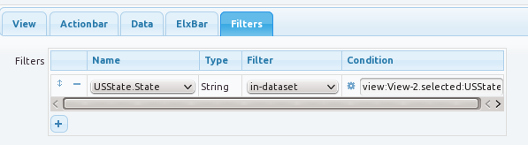

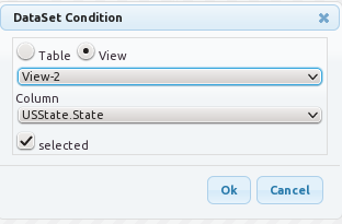

values based on State, that is present in the second grid (the State grid),
that
is named as View-2
on your dashboard.
The values are then filtered, and only the data for the States selected in the second grid, are displayed in this bar chart.
This filter after selection is shown in Figure 2.24, “Set the Filter Properties of the Bar Chart”

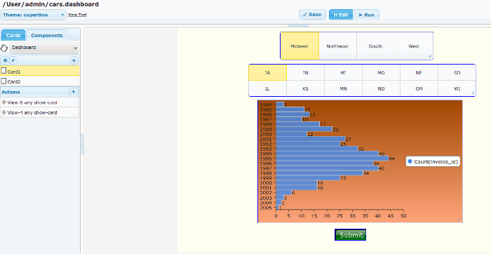

Run
The chart shows the number of old cars that were traded in for new cars each year.

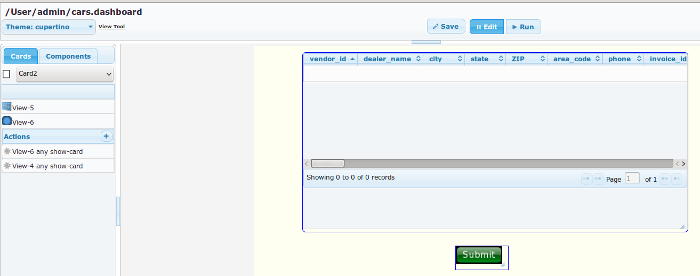

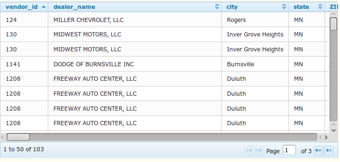

Navigate to the second card and drag and drop a
Table
component on to the workspace.
Right click the Table
component and
select Properties.

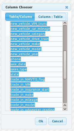

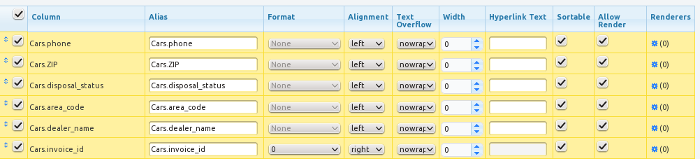

Navigate to the data tab and select
all the columns from the Cars
table as shown in Figure 2.26, “Selecting the Data Columns for the
Table”.
Navigate to the type tab and select
the columns to be displayed in the table. Also, set the
Page Size
as desired.
Page Size indicates the number of rows to display in one page of the table.
For more information on Table, see the section called “Table”.

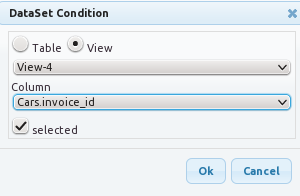

on invoice_id, that is present in the Bar Chart, that is named
as View-3
on your dashboard.

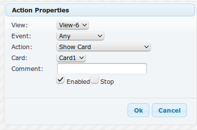

Drag and drop a Button
component on to the workspace of Card2.
Button
component in the workspace and select Add Action.
Any
, the Action as Show Card
and the Card as
Card1
Clicking this button (either a single click or a double click) will navigate back to the first card.
Drag and drop a
Button
component on to Card1.
Button
Any
and the Card as
Card2
Clicking this button (either a single click or a double click) will navigate to the second card.
