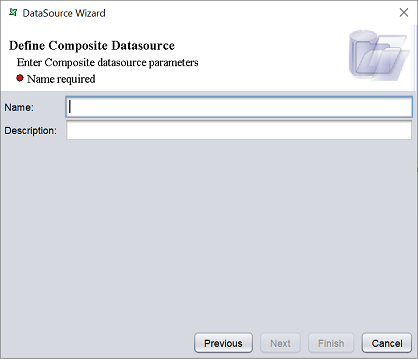

Define Composite Datasource
In this second page, the details of the composite datasource need to be defined.
Name | Name of composite datasource. | Yes |
Description | Brief description of composite datasource. | No |
Fill in the fields as required and click on the “Next” button. Alternatively, if you wish to use the default security options, click on the “Finish” button to complete the process.

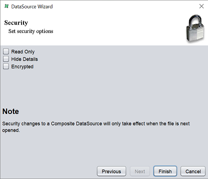

Security Option
The last page in the wizard for the composite datasource allows you to set the security options for the datasource.
There are three options.
Type | Description |
The new datasource will appear in the repository on the left and opened in the workspace. Below is an example of a composite diagram.
