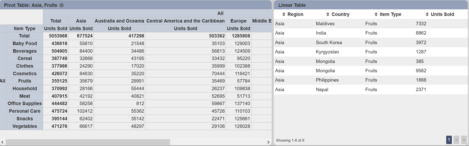

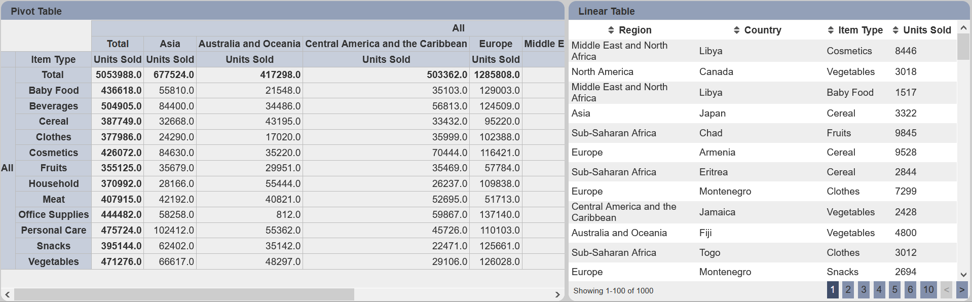

Below is an example of the usage of the Pivot Filter. In this example, a pivot table and a linear table is created. Both uses the same dataset. Create the “Pivot Filter” to use the same dataset. In the pivot table, select the “Pivot Filter” in the “Select to Control” property. In the linear table, select the same filter in the “Controlled By” property. This will allow the pivot table to control the data to be displayed in the linear table.
