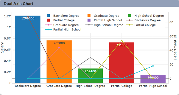

Dual Axis Chart
A dual axis chart allows you to display two types of charts together with the same X axis, using the same dataset.

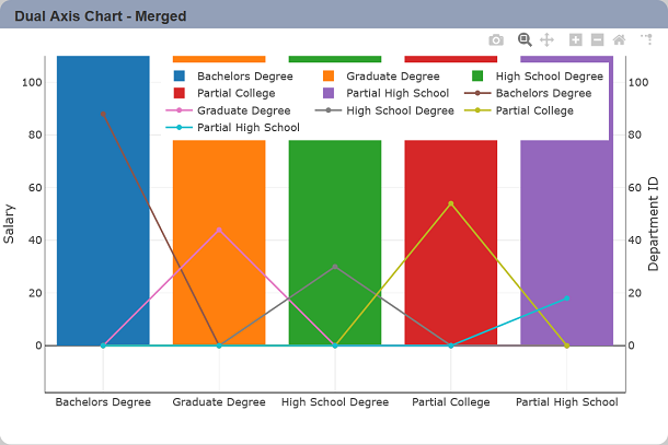

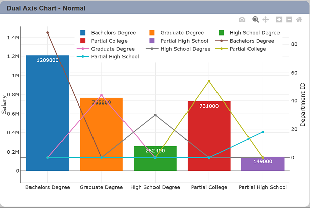

Example: Using YAxis Ranges
The “YAxis Ranges” property works only when the “Autorange” field in the “YAxis” property is set to “false”.
When “YAxis Ranges” is set to “Normal”, both charts will use their respective Y-axis settings. In this example, Chart1 and Chart2 have teh following settings:
- Chart1
- “Autorange” = false
- “Min padding (%)” = 10
- “Max padding (%)” = 25
- Chart2
- “Min padding (%)” = 20
- “Max padding (%)” = 5
When the “YAxis Ranges” is set to “Merged”, the Y-axis settings of both charts will merge together, taking the higher value of the same field. Chart1 and Chart2 now has the following settings: * “Min padding (%)” = 20 * “Max padding (%)” = 25
