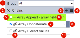

The Chains Panel is the leftmost panel in the ETL Designer page and it displays the list of chains in the chainset.
No. | Description |
1 | Allows you to view the ETL chains that are grouped together. |
2 | Allows inverting selected and deselected chains. |
3 | Allows adding new chains. |
4 | Provides more actions that can be performed. Available options vary depending on the chains selected. |
5 | Checkbox indicating that the chain is selected. |
6 | Color assigned to the chain for aesthetic purposes. |
7 | Unique name of the chain. |
8 | Indicates which chain is displayed on the Steps panel. |
9 | Icon assigned to the chain for aesthetic purposes. |
10 | Number of steps (both enabled and disabled are included in the count) in the chain. |

Once a chain is selected or added, the Steps
panel would display all the steps in that chain.
Select Chain
Selecting a single chain and multiple chains are supported in the Chains
panel.
To perform a single-value selection, tick on the checkbox on the left of the chain name and ensure that only 1 chain is ticked.
Another option is to click on any part of the chain’s row. This automatically removes the ticks on the checkboxes of all other chains, if any. The difference between ticking on the checkbox and the entire row is that the former does not change the chain displayed on the Steps
panel, whereas the latter changes the steps displayed on the said panel to the ones corresponding to the selected chain. Note that performing the latter also adds a colored indicator on the right part of the selected row, specifying that the steps displayed on the Steps
panel belong to the selected chain.
To select multiple chains, tick on the checkboxes on the left of the chain names. To deselect a chain, simply un-tick the checkbox corresponding the designated chain. To invert the selection, simply click on the checkbox on the panel header.

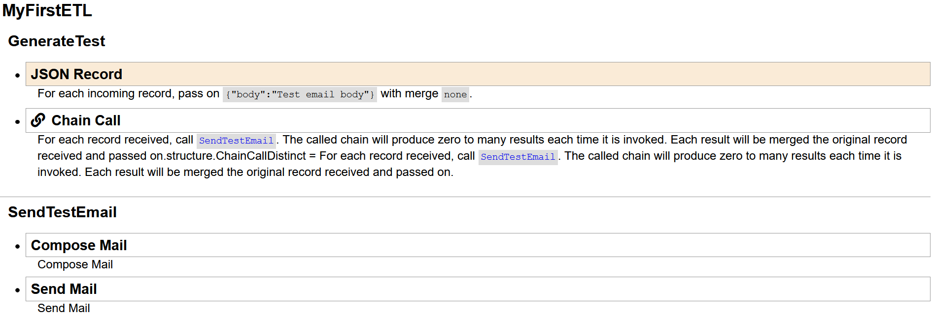

Explain Chain
To generate a brief summary the chainset, click on the button then click on the
Explain
option. It opens another browser tab and displays descriptions of each step in each chain. It includes the parameters and values for each step, providing a narrative-like overview of the chainset.
