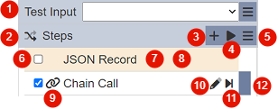

The Steps Panel is the second panel from the left in the ETL Designer page and it displays all the steps of a selected chainset. This also allows the user to run the chain or partially run it up to a specific step. Below are the different components of the panel:
No. Description
1 Allows input to be tested.
2 Allows inverting selected and deselected steps.
3 Allows adding new steps.
4 Runs the entire chain.
5 Provides more actions that can be performed.
Available options vary depending on the steps selected.
6 Checkbox indicating that the chain is selected.
7 Name given to the step.
8 Color assigned to the chain for aesthetic purposes.
9 Icon assigned to the step for aesthetic purposes.
10 Allows modifying a step’s parameter values and properties.
11 Runs the chain from the first step up to the step corresponding the this Run to Step button.
12 Indicates which chain is in focus.
Selecting the step makes its Edit Step (10) button and Run to Step shortcut (11) button available. Also, the Run to Step option under More Actions (5) runs the entire chain up to this step.

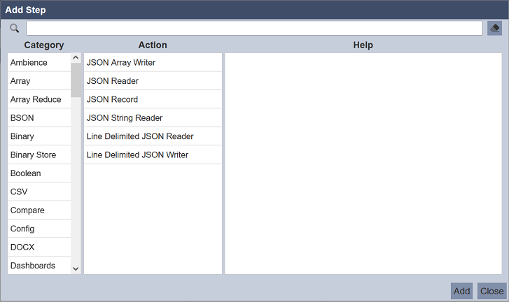

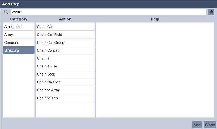

Add Step

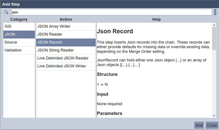

If more steps are needed, simply continue selecting other steps then click on the Add button. Click on the Close button after adding steps. If any step was added, closing would instantly open the Edit Step dialog box corresponding to the last step added. Do note that step input parameters are required to be entered and saved before closing the Edit Step dialog box, else the steps will not be saved.

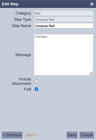

To configure an existing step, click on the Edit Step button corresponding the step.

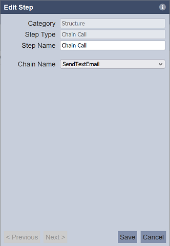

Chain Call Steps

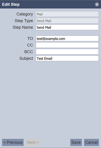

  • the GenerateText chain creates a text
  • the SendEmail chain sends an email

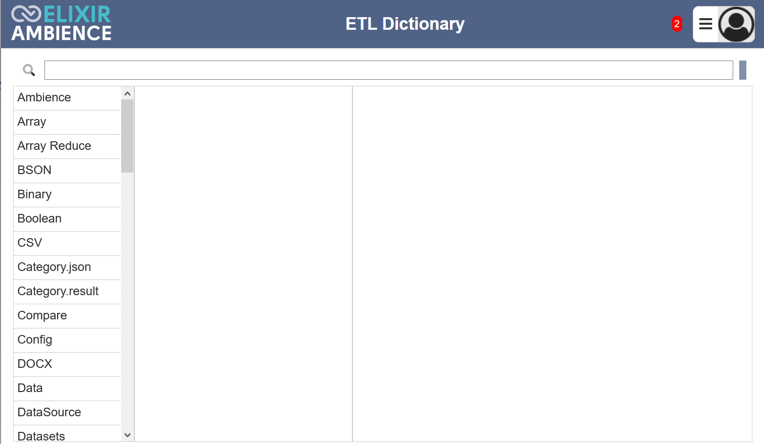

There are many other related steps, serving different purposes. For more information on these steps, refer to the Dictionary provided.

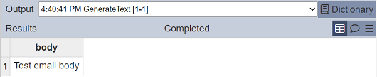

Run Steps

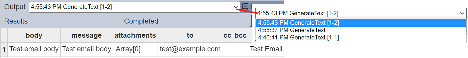

Right after triggering the chain to run, a record appears on the Output panel. Each run adds a record in the Output panel. The Results panel displays the actual results of the executed steps.

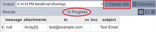

If the execution is ongoing, the result will not be displayed and the status In Progress is shown. A Cancel Job button will appear, allowing you to cancel the job.
If the same chain or chain subset has already been executed before and is still listed on the Output panel, new records are labeled with a timestap appended before the chain or chain subset.

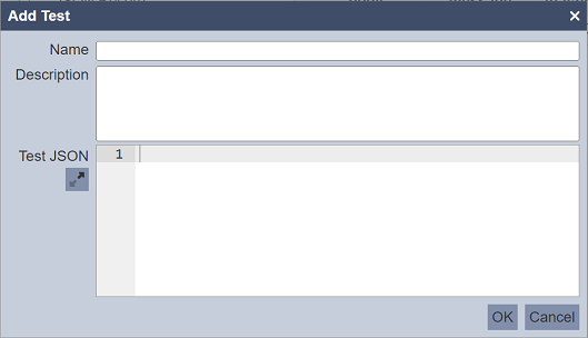

Add Test
To add a test input, click on the button and select the only option Add Test. The “Add Test” dialog box will appear.

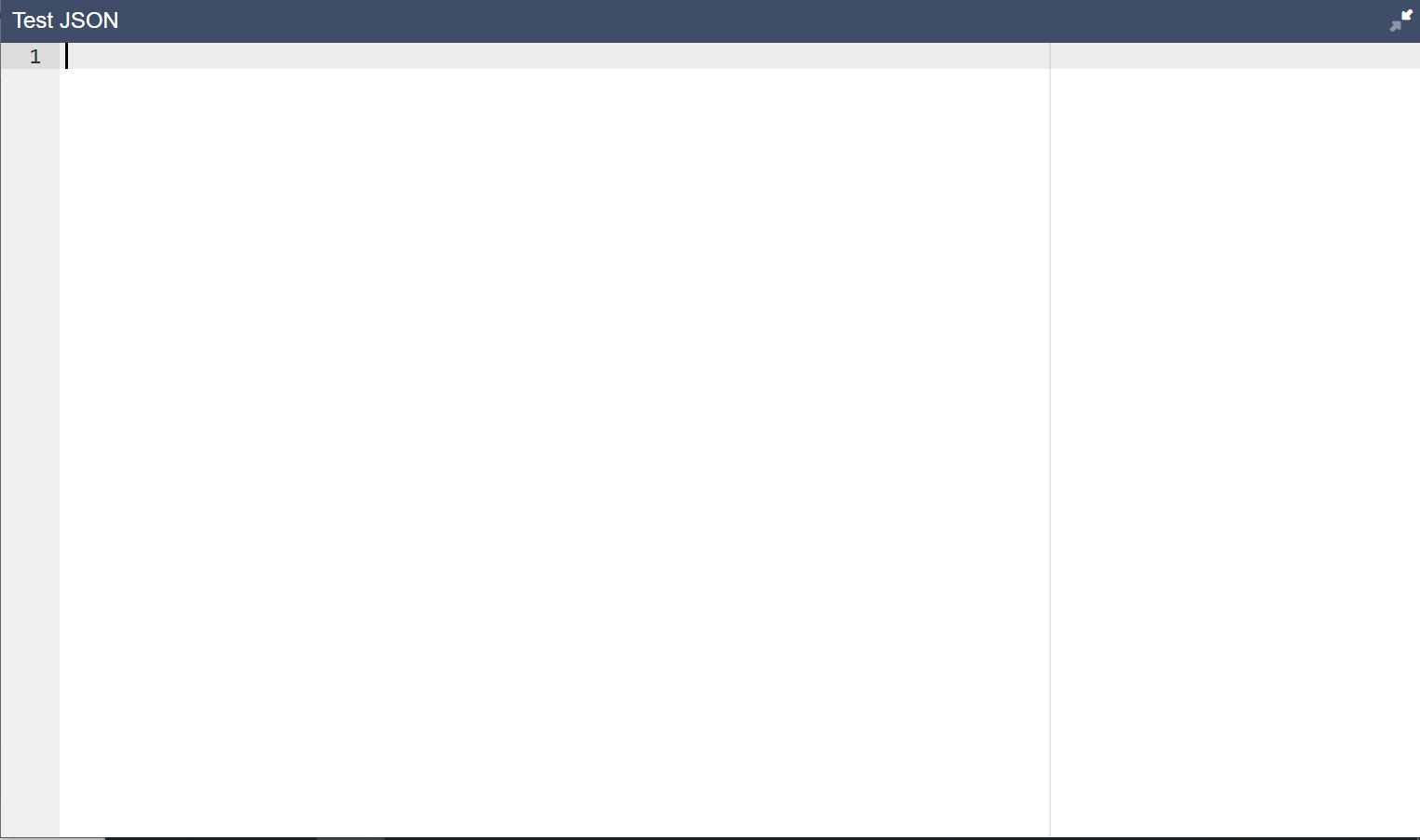

In the Name field, key in an unique name for the test input and a brief description in the Description field (optional). In the Test JSON field, key in the test input. The Maximise button next to the textbox allows you to maximise the textbox to a full screen.
To revert back, click on the Rest0re button at the upper right corner of the page.
Click on the OK button to save the new test. A message will appear once the new test is saved successfully.

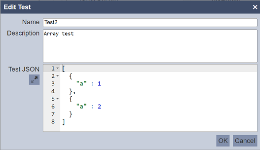

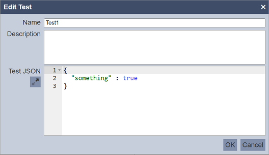

To edit a test input, select the desired test input from the drop-down list and click on the button. In the pop-up menu, select the Edit Test option. THe “Edit Test” dialog box will appear.
Edit as desired and click on the OK button to save the changes. A message will appear once the test input is saved successfully.

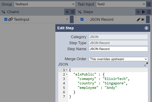

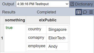

In this example, a simple ETL chain with one JSON record step is used.

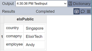

When the ETL step is run without test input, the result returns as such:
Create a simple JSON for the test input and label it as Test.
Select the Test1 from the drop-down list and run the ETL step again. The result returns with the test JSON as an input.

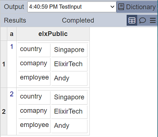

Create another test input and label it as Test2 This test input uses an array of records.
Select Test2 from the drop-down list and run the ETL step. The result return as below.
