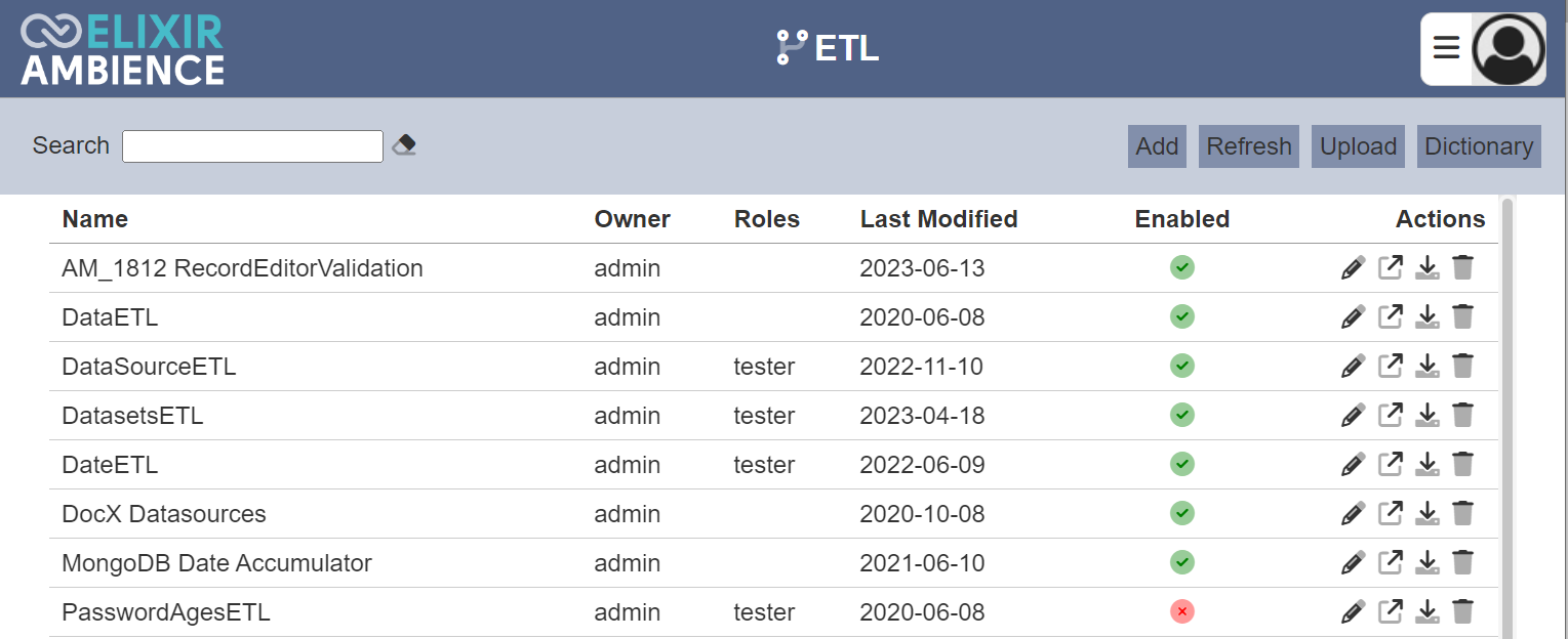

ETL Management
In larger systems, it is useful to be able to share common chains across multiple chainsets. This is achievable by creating a chainset and then importing that chainset into others. This allows those importing to be able to call on any of the imported chains as if they were locally defined.

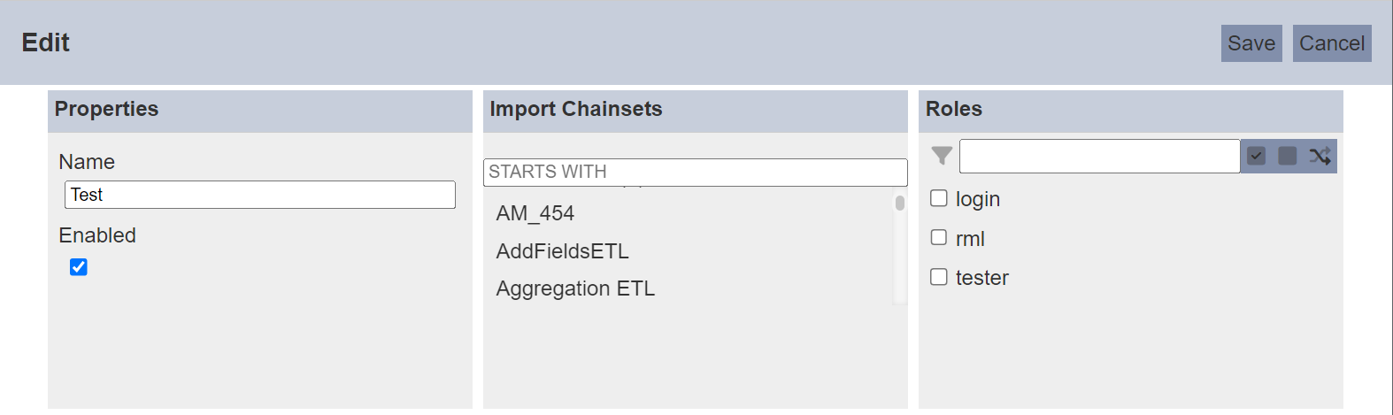

To modify an existing chainset’s attributes, click on the “Edit” icon under the “Actions” column corresponding the said chainset.
Properties | |||||
Name | Unique name assigned to the chainset that would be used as its identifier. | Y | Text field | Any text. The value must not exist in the current list, regardless of status (enabled or disabled) and ownership. The value is case-sensitive. | Empty string |
Enabled | Indicates if the chainset is enabled (selected) or disabled (unselected). | Y | Checkbox | True (selected) or false (unselected) | True (selected) |
Import Chainsets | |||||

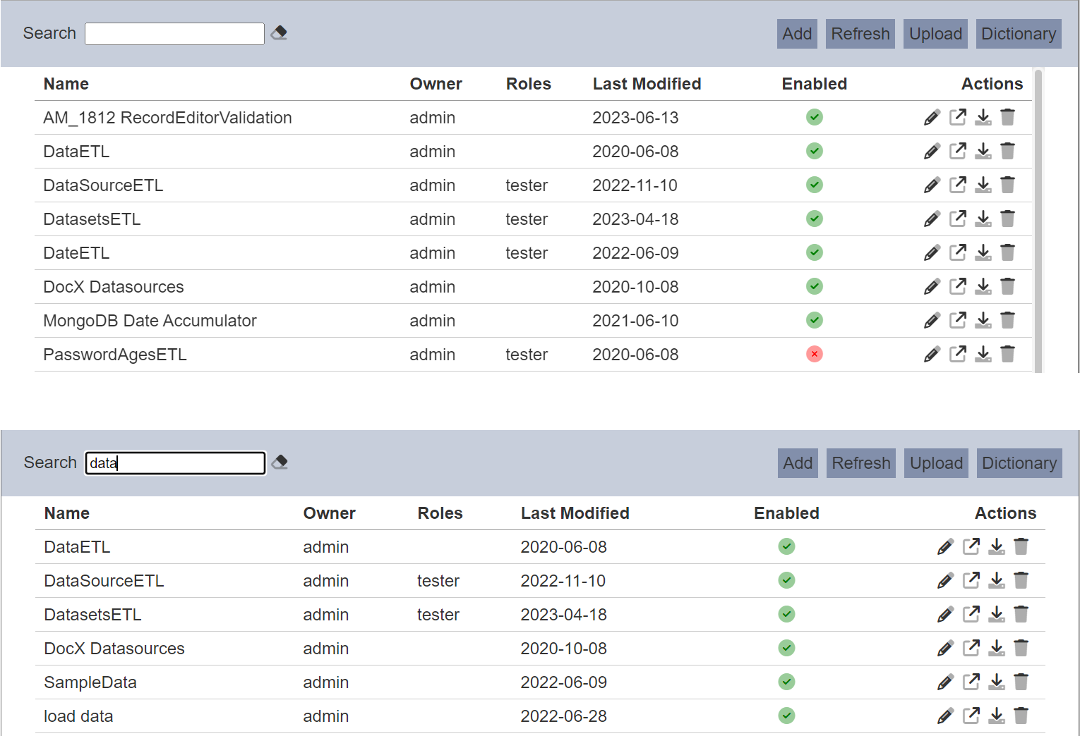

Search Function | Allows you to search for the ETL chainsets that starts with the string defined in this field. | N | Text field | Any text. The value is upper case and is not case-sensitive. | Blank |
Chainsets | List of ETL chainsets. | N | Drop-down list | Multiple values can be selected. | Not selected |
Roles | |||||
Roles | List of roles that are granted read-only access to the chainset. Users who have the selected roles would be able to view the chainset, assuming they have the appropriate privilege to the ETL Designer interface. | N | Checkbox | Multiple values can be selected. All roles are listed as available options. | No value selected |
Import Chainsets
In the “Import Chainsets” panel, the search function allows you to define the string to filter the ETL chainsets in the the drop-down list that starts with the string defined. The characters in the string appears as upper case and is not case sensitive. For example, key in “ETL” and all ETL chainsets that starts with “ETL” will appear in the drop-down list.
To select the ETL chainset, click on the desired ETL chainset in the drop-down list and it will appear above the search function.
To remove any of the selected ETL chainset, click on the “x” on the right of the ETL chainset.

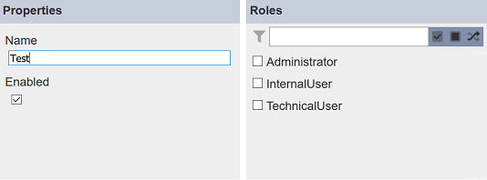

Roles
In the “Roles” panel, there is a search function, as well as Select All
, Select None
and Invert Select
buttons above the role options.
Similarly, deselect the checkbox to disable an enabled chainset. Disabling a chainset also disables using it with the ETL Designer interface for the designated roles. The owner can still access the chainset via the ETL Designer interface.

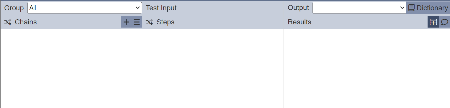

Click on the “Open ETL Designer” button to load the ETL Designer.

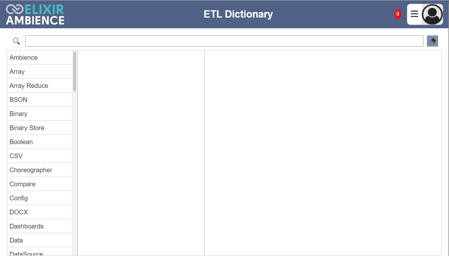

Dictionary

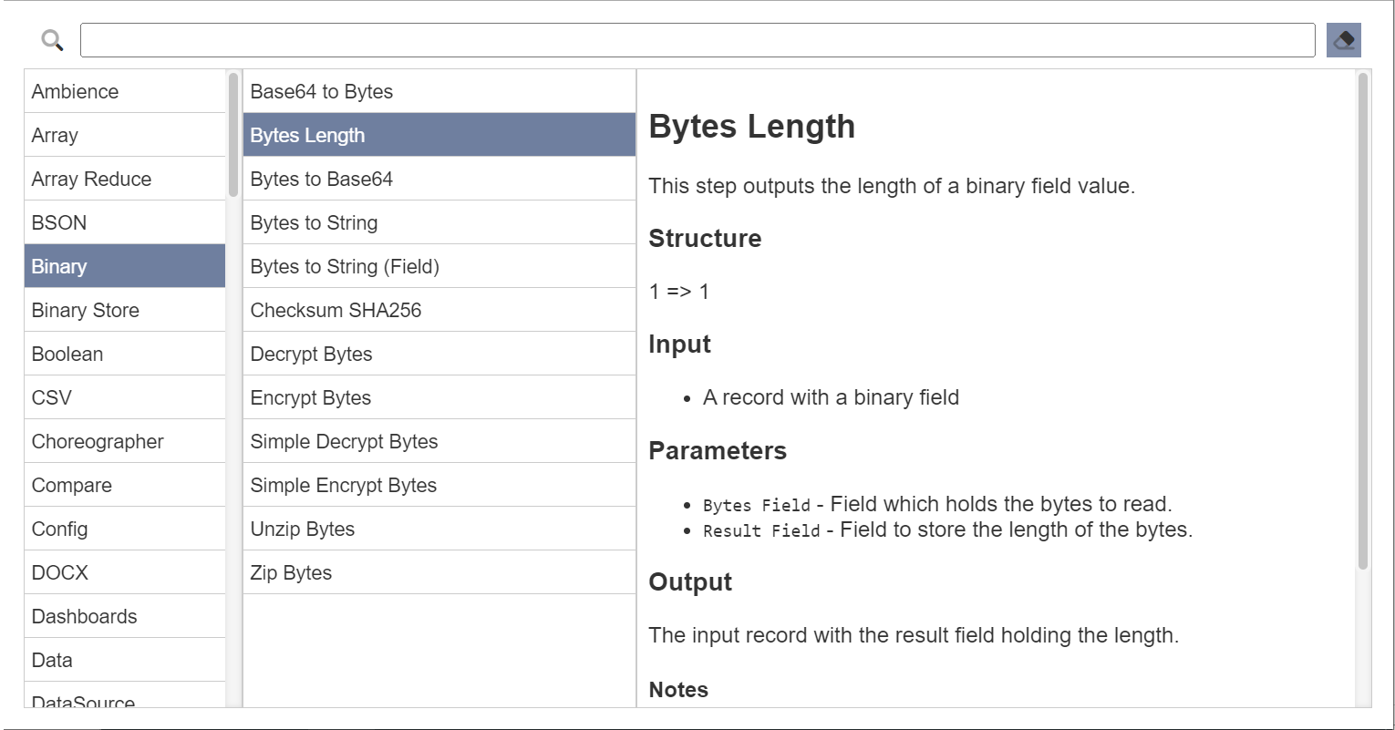

The “Dictionary” button at the upper right corner of the page when clicked, displays a page which allows you to search for the ETL step along with their description.
The page can be divided into several parts: The search function at the top of the page allows user to key in keyword to search for the ETL step. The left panel displays the categories of ETL. The centre panel displays the ETL steps of the category selected. The right panel displays the description of the ETL selected.

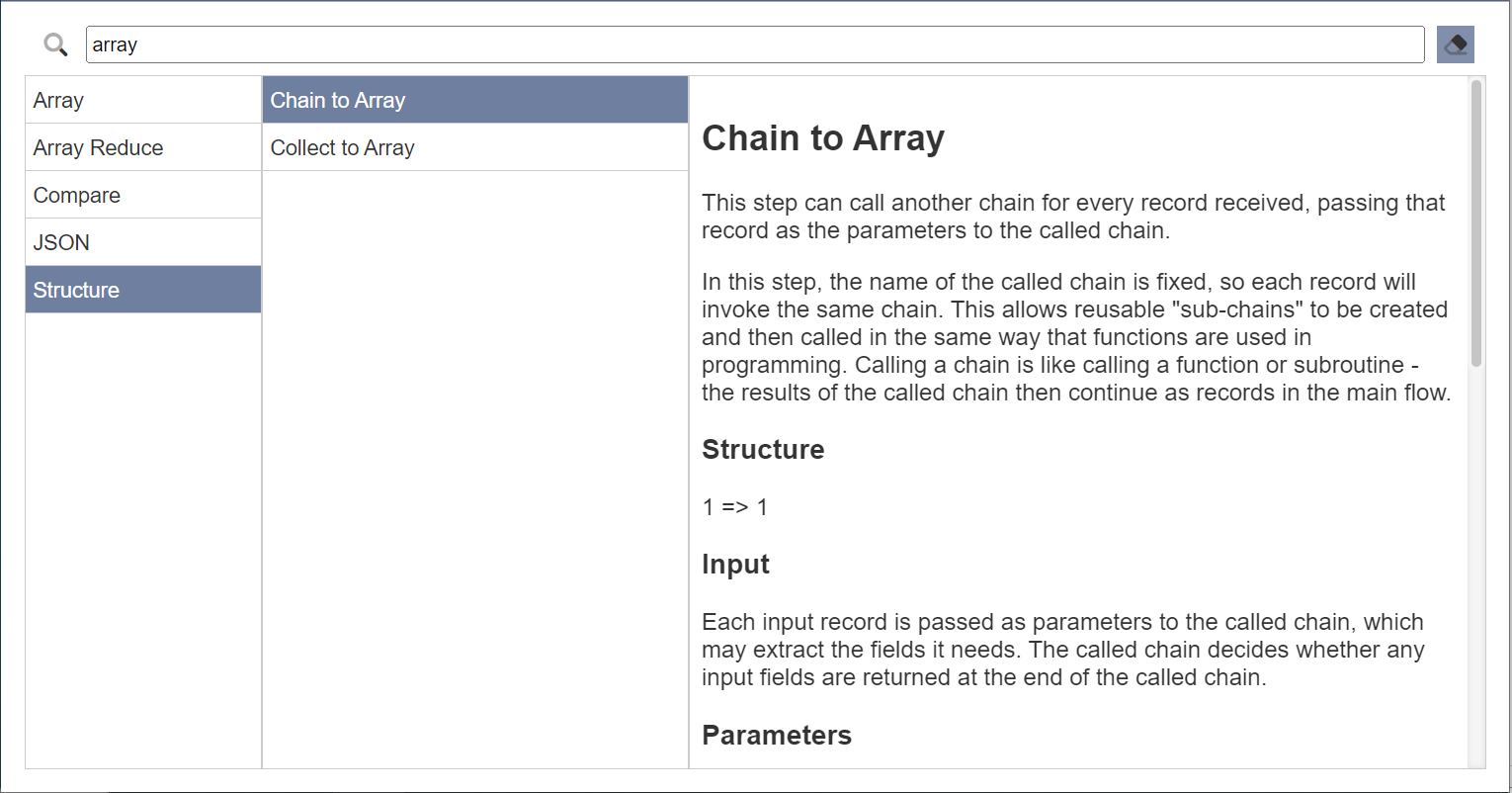

Keyword Search
To use the search function to search for a ETL step, key in a keyword, e.g. “array”. The left panel will display the categories that have ETL step(s) containing the keyword “array”. Select the desired category and the centre panel will display the list of ETL steps containing the keyword “array”. Select the desired ETL step in the centre panel and the description for the ETL step will appear in the right panel.
Category Search
To search using category, scroll and select the desired categroy from the list of categories in the left panel. The list of ETL steps for that category will appear in the centre panel. Scroll and select the desired ETL step. The description for the selected ETL step will appear in the right panel.
