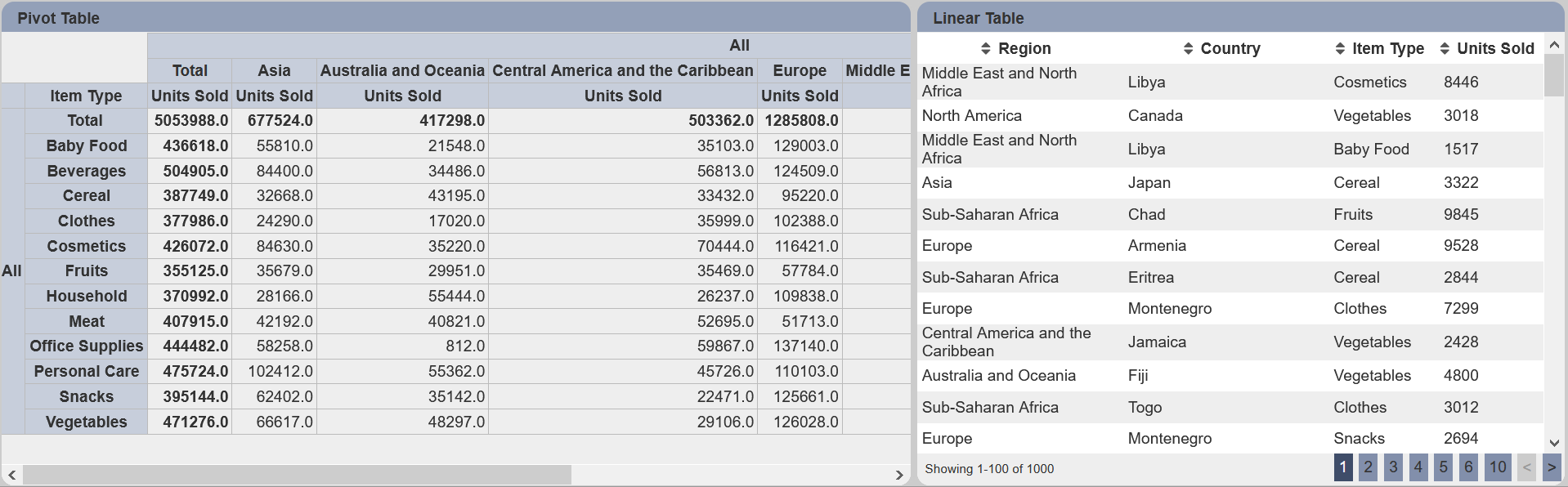

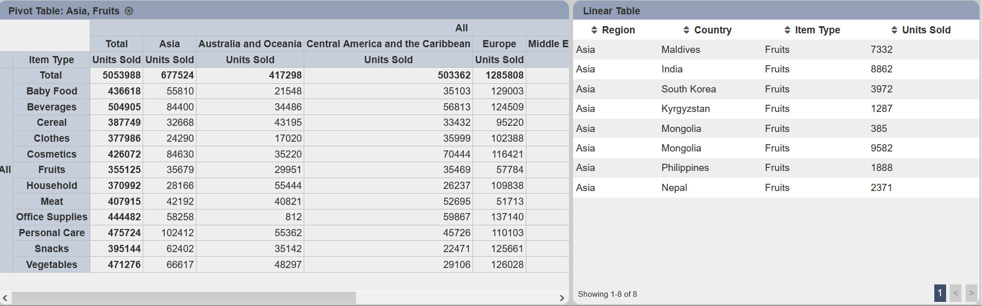

Below is an example of the usage of the Pivot Filter. In this example, a pivot table and a linear table are created. Both are configured to use the same dataset. Create the “Pivot Filter” using the same dataset. In the pivot table, select the “Pivot Filter” in the “Select to Control” property. In the linear table, select the same filter in the “Controlled By” property. This will allow the pivot table to control the data to be displayed in the linear table.

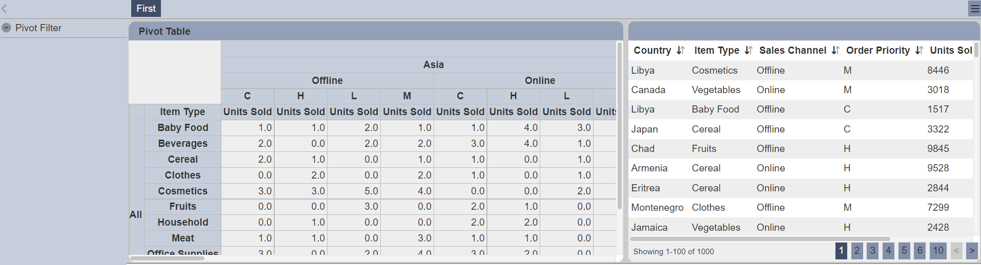

The example below shows two tables, a pivot table and a linear table. The pivot table has the columns showing “Region”, “Sales Channel” and “Order Priority” and the rows showing “Item Type”. The linear table shows details. A Pivot Filter is crated, with the “Discard” field set as “Sales Channel”.
In the pivot table, select the Pivot Filter in the “Select to Control” field and in the linear table, select the same filter in the “Controlled By” field.
Select the first cell in the pivot table, that is, Baby Food, C.
You can notice that the linear table displays records that are in “Asia”, “C” and “Baby Food”, disregarding the value of “Sales Channel”. Try selecting the cell under “Asia”, “Online” under “Baby Food”. The result in the linear table is the same.

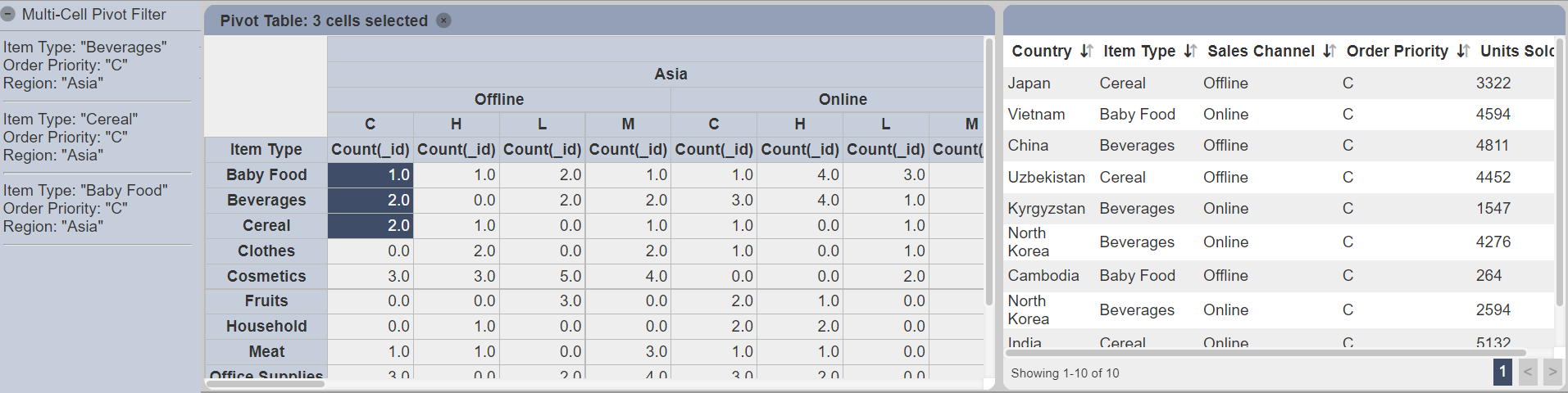

For Multi-cell Pivot Filter, multiple cells can be selected by holding down the CTRL key and click on the desired cell in the pivot table. The linear table will display the records according to the values of the selected cells.
In the example above, the linear tables shows the records of three item types selected (Baby Food, Beverages and Cereal) under order priority C, disregarding the values of “Sales Channel”.
