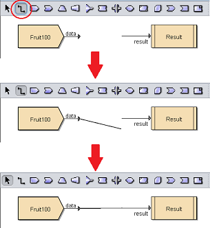

Add Flow
The simple example below connects a DataSource processor to the Result processor. To do so, ensure no processor is selected at the moment. Select the
button on the menu bar and click on the DataSource processor. While holding down the mouse, move towards the Result processor. A line will appear from the DataSource processor towards the direction of your mouse. Click onto the Result processor to join the two processors together.

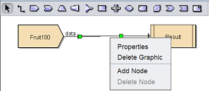

Pop-up Menu
To access the pop-up menu of the Flow connector, right-click on the connector.
There are four functions in the pop-up menu.
| Function | Description |
| Properties | Launches the DataFlow Wizard that allows you to edit the dataflow properties. |
| Delete Graphic | Deletes the Flow connector. |
| Add Node | Adds a node of the line in the designer diagram. This allows the line to have extra points to draw angular lines. |
| Delete Node | Deletes the selected node of the line in the designer diagram. |

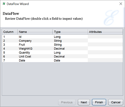

The “Properties” option in the pop-up menu when selected will display the “DataFlow Wizard” that allows you to review the dataflow from the datasource.
To inspect the values of the data, double-click on the desired field and the “Values Inspector” dialog box will appear. These values are not editable. Click on the “Close” button to exit the dialog box.

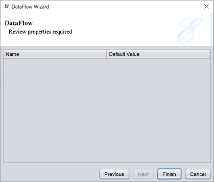

Click on the “Next” button reviews the next page that allows you to review the properties (if any).
Click on the “Finish” button to complete reviewing the dataflow or click on the “Previous” button to go back to the previous page. To abort, click on the “Cancel” button.
