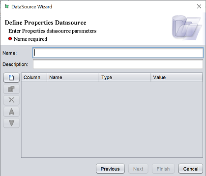

Define Parameters
In this second page, the two parameters of the properties datasource need to be defined.
- Details
- Schema
Define Details
This part requires you to define a name and a brief description (optional) for the properties datasource.
| Name | Name of properties datasource. | Yes |
| Description | Brief description of properties datasource. | No |
The mandatory field must be filled, else an error message will appear in the page with a red dot and the “Next” button will not be enabled.

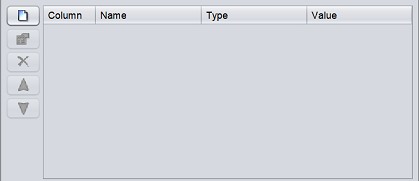

Define Properties
This part requires you to define the properties for the properties datasource.
To add a property, click on the
“Add” button at the left of the page. The “Add Column” dialog box will appear.
Key in the name of the property in the “Name” field and select the data type from the drop-down list in the “Data Type” field. The “Value” field is optional. Click on the “Ok” button to add the column.
Repeat the same process until all desired properties as added.
The order of the properties are according to the sequence they are added. To re-order the properties, select the desired property, then click on the
“Move Up” or
You can also edit the property by selecting the desired property, then clicking on the
“Edit” button. The “Edit Column” dialog box will appear.
If a field is added by mistake, you can remove the property by selecting it, then click on the
“Delete” button.
