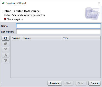

Define Datasource Parameters
In this second page, the two parameters of the tabular datasource need to be defined.
- Details
- Schema
Define Details
This part requires you to define a name and a brief description (optional) for the tabular datasource.
| Name | Name of tabular datasource. | Yes |
| Description | Brief description of tabular datasource. | No |
The mandatory field must be filled, else an error message will appear in the page with a red dot and the “Next” button will not be enabled.

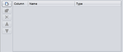

Define Schema
This part requires you to define the schema for the tabular datasource.
To add a field, click on the
“Add” button at the left of the page. The “Add Column” dialog box will appear.
The order of the fields are according to the sequence they are added. To re-order the fields, select the desired field, then click on the
“Move Up” or
You can also edit the field by selecting the desired field, then clicking on the
“Edit” button. The “Edit Column” dialog box will appear.
If a field is added by mistake, you can remove the field by selecting it, then click on the
“Delete” button.

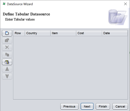

Create Tabular Values
In this page, you can enter values for the columns created in the previous page (i.e., create records).
You can also choose to skip this page by clicking on the “Next” button to continue to the security page or click in the “Finish” button to use the default security settings.
There are several actions that can be performed in this page. By default, only the
“Add” button is available since there are no records. The buttons will become enabled when the function can be performed.
Add Record
To add a record, click on the
“Add” button at the left of of the page. The “Add Record” dialog box will appear with all the column fields created in the previous page.
Key in the required values and click on the “Ok” button to add the record.

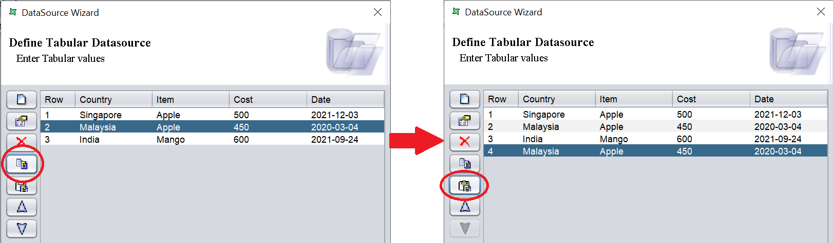

Copy/Paste Record
To copy a record, select the desired record and click on the
“Copy” button to copy the record onto clipboard. Then click on the
“Paste” button to add the record from clipboard.
