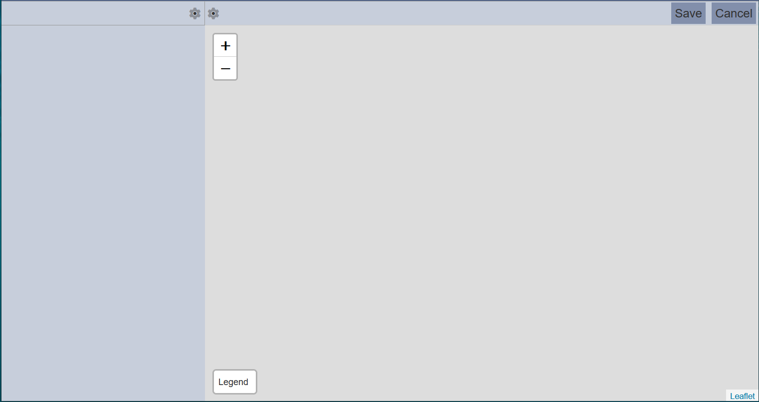

Edit Mode
To create these layers and filter controls, you need to be in the GIS Explorer Designer page or edit mode. To go into edit mode, click on the “Edit” button at the upper right corner of the page.
icons:

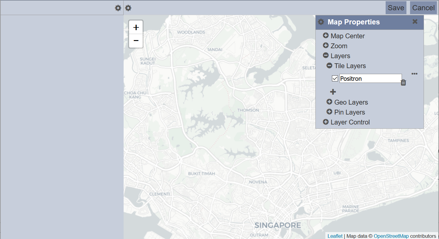

Tile Layer
To add a tile layer to display a map, click on the
icon on the right panel. The “Map Properties” dialog box will appear.
In the “Map Properties” dialog box, click on the
icon next to “Layers” section to show the sub-sections. Click on the
icon next to “Tile Layers” sub-section.
To add a new tile layer, click on the “+” icon below the “Tile Layers” sub-section.
When the new tile layer is added, it is enabled by default (checkbox is selected). To edit the tile layer, click on the “…” icon to display the “Tile Layer” dialog box.
| Name | Unique name of the tile layer. | Text field | Any text | “[New Tile Layer]” |
| Attribution | Defines the attribution text to be displayed at the bottom of the map (optional). | Text field | Any text | Empty |
| Opacity % | Defines how opaque the tile layer outline are in percentage. | Text field | Integer from 0 to 100 | “100” |
Drop-down list | Select from drop-down list | Not selected (blank) |
| URL | Defines the location of the map. | Text field | Any text | Empty |
| Control As Layer | If selected, allows tile layer to be controlled as a layer. | Checkbox | Selected or not selected | Not selected |
Key in an unique name for the tile layer in the “Name” field.
The “Attribution” field is an optional field which allows you to add an attribution text at the bottom of the map.
The default value for the “Opacity %” field is 100. A lesser value will make the tile layer more transparent and able to see through other layers.
The “User Predefined” field by default is not selected. If any of the values in the drop-down list is selected, it will automatically fills up the fields in the dialog box, replacing any previously values entered. If you wish to enter your own values, ensure to select “blank” for this field.
Key in the location of the tile in the “URL” field.
For the “Control As Layer” field, if unselected, allows for single selection of the tile layer. To allow multiple selection, select this field to treat the tile layer as any other layers. In this case, you may want to reduce the opacity of the tile layer to allow other tile layer to show through.
Click on the “OK” button in the dialog box to save the changes.
In the example below, the predefined value “Positron” is selected and “Control As Layer” field is unselected. Upon saving the settings, the tile layer will appear on the GIS Explorer. If the tile layer is disabled (that is, checkbox on the right of “Positron” is unselected), the map will not be displayed.
You can add more tile layers using the above steps.

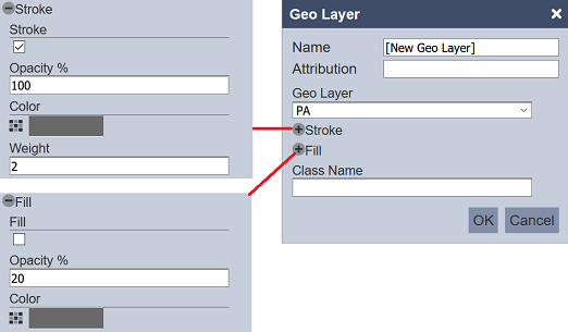

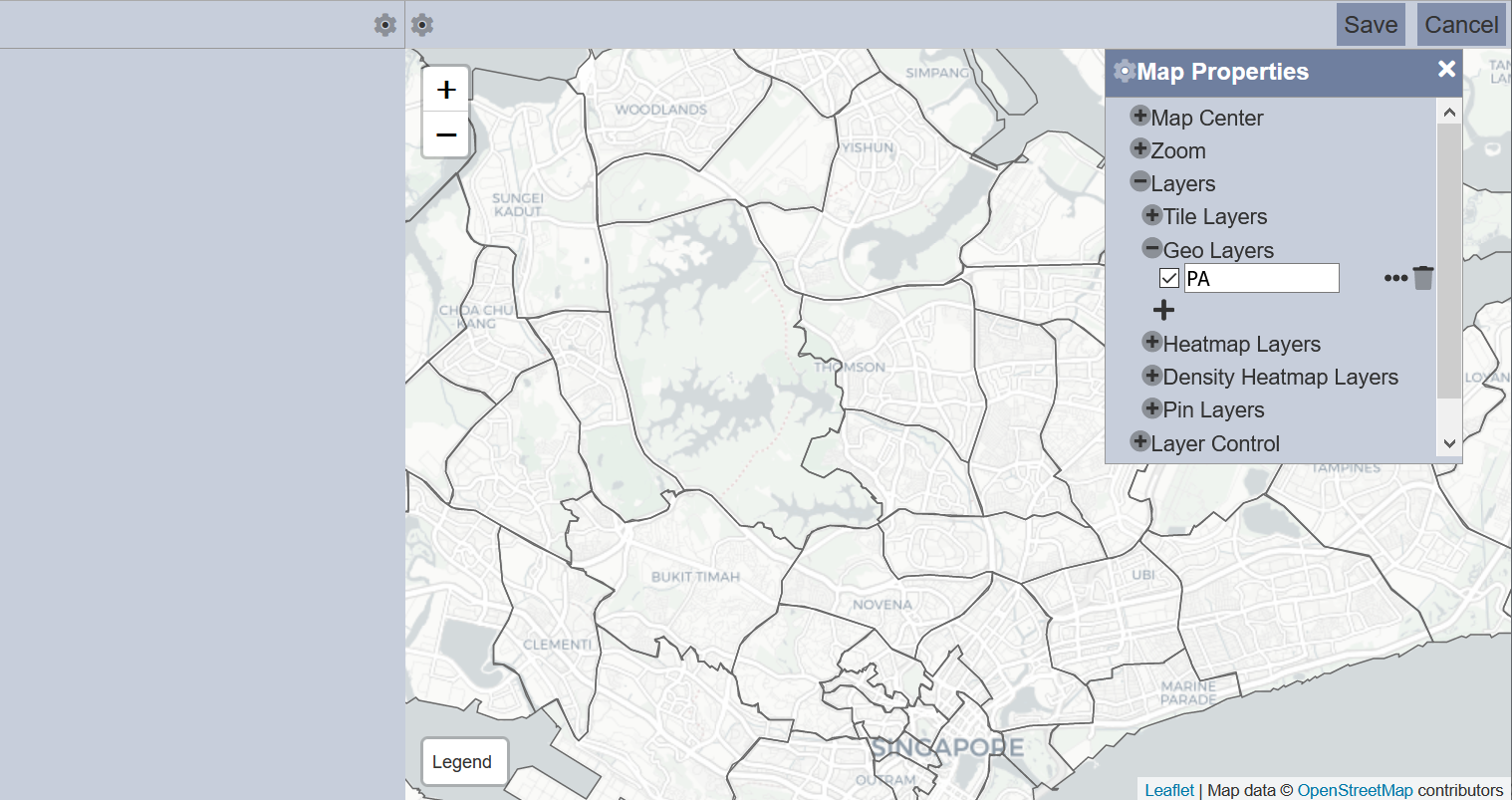

Geo Layer
icon next to “Geo Layers” sub-section.
To add a geo layer, click on the “+” icon below the “Geo Layers” sub-section.
When the new geo layer is added, it is enabled by default (checkbox is selected). To edit the geo layer, click on the “…” icon to display the “Geo Layer” dialog box.
| Name | Defines the name of the geo layer. | Text field | Any text | “[New Geo Layer]” |
| Geo Layer | Selects the geo layer. | Drop-down list | Select from drop-down list | Not selected |
| Stroke | ||||
| Stroke | If selected, adds a geo layer outline onto the map with the defined properties. | Checkbox | Enable or disable | Selected |
| Opacity % | Defines how opaque the geo layer outline are in percentage. | Text field | Integer from 0 to 100 | “100” |
| Color | Selects the colour of the geo layer outline. | Colour map | Select from map | “Dim grey” |
| Weight | Defines the weight of the outline of geo layer. | Text field | Integer from 1 to 50 | “2” |
| Fill | ||||
| Fill | If selected, fills the geo layer with the colour selected in colour palette. | Checkbox | Enable or disable | Not selected |
| Color | Selects the colour of the geo layer. | Colour map | Select from map | “Dim grey” |
| Class Name | Defines the CSS class. | Text box | CSS class name | None |
Key in an unique name for the geo layer in the “Name” field.
Selects the desired geo layer from the drop-down list in the “Geo Layer” field. The options available for this field depends on the GeoJson file loaded into Ambience.
The “Stroke” field allows you to define the outline of the geo layer, such as its colour, opacity and weight. The “Fill” field allows you to define the fill-in of the geo layer, such as colour and opacity.
Both fields can be enabled or disabled by selecting or unselecting the checkbox of the “Stroke” and “Fill” fields respectively.
The default value for the “Opacity %” field is 100. A lesser value will make the geo layer more transparent and able to see through other layers. This may be useful if more than one geo layer is displayed.
Click on the “Color” field to display the drop-down list and select the desired colour. Alternatively, you can search for the desired colour using the search bar.
Key in the desired thickness of the geo layer in the “Weight” field.
If the “Fill” field is selected, it will fills the geo layer with the selected colour. By default it is unselected.
Click on the “OK” button to save the changes. Upon saving the settings, the geo layer will appear in the map. If the geo layer is disabled (that is, checkbox on the right of “PA” is unselected), the layer will not be displayed.
Setting up the geo layer is optional. You can add more geo layers using the above steps.

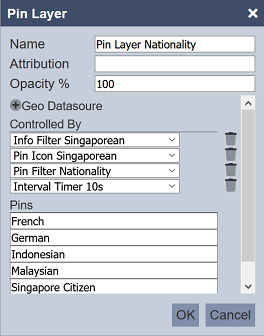

Pin Layer
icon next to “Pin Layers” sub-section.
To add a pin layer, click on the “+” icon below the “Pin Layers” sub-section.
When the new pin layer is added, it is enabled by default (checkbox is selected). To edit the pin layer, click on the “…” icon to display the “Pin Layer” dialog box.
| Name | Defines the name of the pin layer. | Text field | Any text | [New Pin Layer] |
| Opacity % | Defines how opaque the pin layer outline are in percentage. | Text field | Integer from 0 to 100 | “100” |
| Geo Datasource | ||||
| Dataset | Selects the geo dataset. | Drop-down list | Select from drop-down list | Not selected |
| Subset | Selects the geo subset. | Drop-down list | Select from drop-down list | Not selected |
| GeoJson Field | Selects the geo JSON. | Drop-down list | Select from drop-down list | Not selected |
| Group Field | Places the output of the dataset./subset into separate groups or data traces based on field selected. | Drop-down list | Select from drop-down list | Not selected |
| Selection Field | Defines the field for selection in the GIS View (optional). | Drop-down list | Select from drop-down list | Not selected |
| Controlled By | Add or remove filter controls for the explorer (optional). | Drop-down list | Select from drop-down list | Not selected |
| Pins | Displays the pins according to the value selected in Group Field. | Text field | Not editable | Empty |

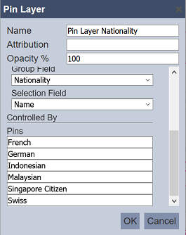

Key in an unique name for the pin layer in the “Name” field.
The default value for the “Opacity %” field is 100. A lesser value will make the pin layer more transparent and able to see through other layers. This may be useful if more than one pin layer is displayed.
For the “Geo Datasource” field, select the appropriate dataset, subset and GeoJSON in their respectively fields. Select the output field in the “Group Field” field. By defining the optional “Selection Field” field, it allows you to use this field for filter control in GIS View in the dashboard. The “Group Field” field can also be used in the same manner.
If there are filter controls being set up, you will see a “+” icon below the “Controlled By” field. In this example, no filter controls has been set up yet. Therefore, no options are available for this field.
The “Pins” field(s) is not editable and it will be automatically populated when the “Group Field” field is defined. It allows you to preview the different types of pins available for this pin layer.
Click on the “OK” button to save the settings. Upon saving the settings, the pins will appear in the map. If the pin layer is disabled (that is, checkbox on the right of “Pin Layer Nationality” is unselected), the pins will not be displayed.
You can add more pin layers onto the map using the above steps.

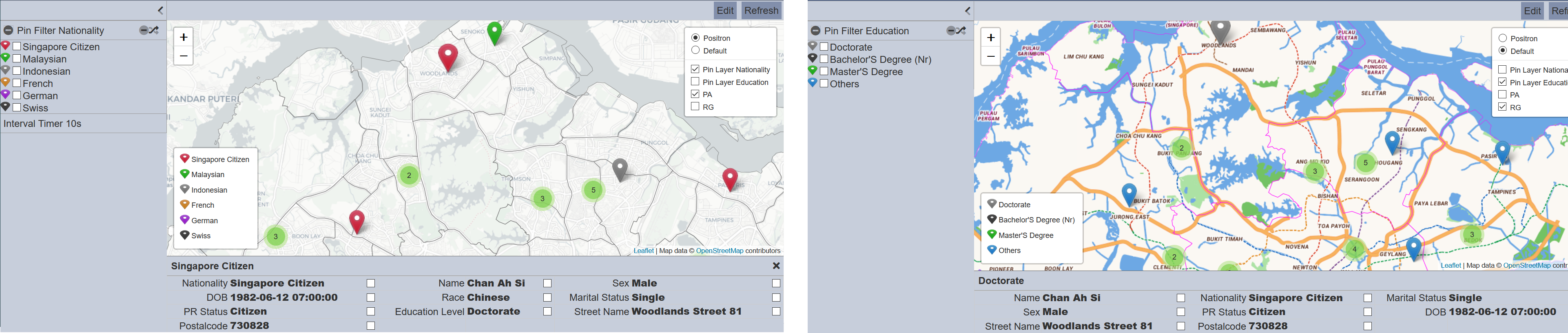

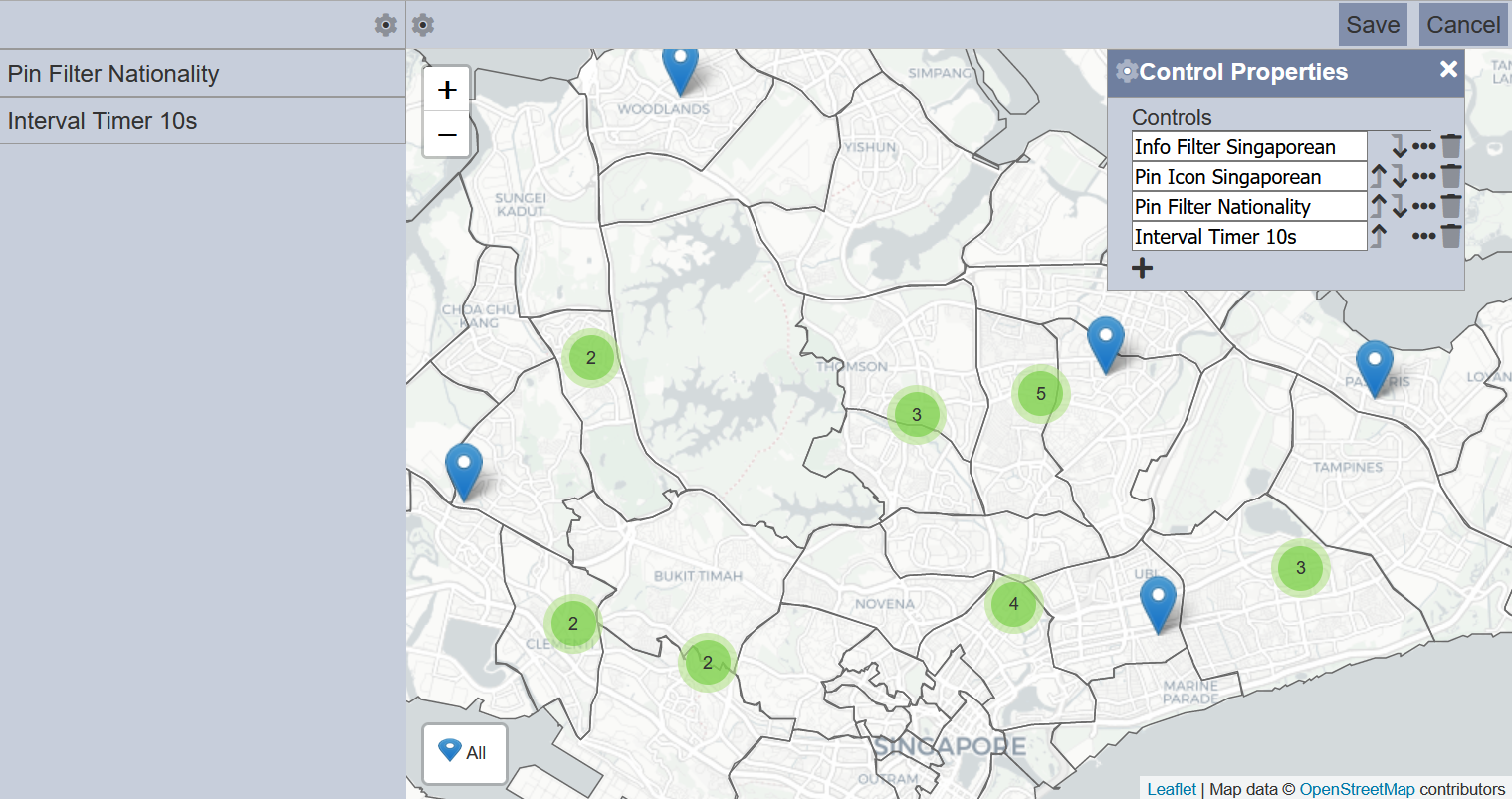

Info Filter
Adding the pin onto the map allows you to view the location of pins. The pins do not provide any information except its location. To provide information on the pins, you can use the “Info Filter” filter controls. One filter control for each type of pin. The “Info Filter” filter controls display the selected information of the pin on the Information Panel at the bottom of the page when the pin is selected.

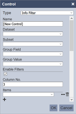

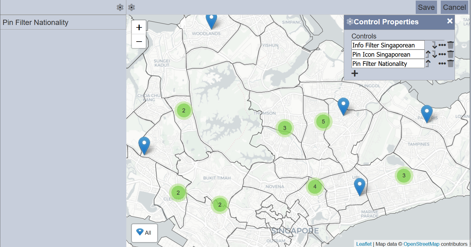

To add a “Info Filter” filter control, enter into the edit mode. Click on the
icon in the Filter Control Panel on the left of the page. The “Control Properties” dialog box will appear.
Click on the “+” icon to add a new filter control.
Click on the “…” icon on the left of the filter control to display the “Control” dialog box. In the “Type” field, select “Info Filter” from the drop-down list. The fields in the dialog box changes according to the selection.
| Type | Selects the type of filter control. | Drop-down list | Select from drop-down list | “Info Filter” |
| Name | Unique name of the filter control. | Text field | Any text | “[New Control]” |
| Dataset | Dataset to be used in the filter. | Drop-down list | Select from drop-down list | None |
| Subset | Subset of the dataset selected. | Drop-down list | Select from drop-down list The dataset must be selected first. |
None |
| Group Field | Field of the selected dataset to be filtered. | Drop-down list | Select from drop-down list | None |
| Group Value | Value of the field selected in Group Field. | Drop-down list | Select from drop-down list | None |
| Enable Filters | If selected, checkboxes will appear in Information Panel for filtering of the pins. | Checkbox | Enable or disable | Enabled |
| Column No. | Defines the number of columns in the Information Panel. | Text field | Integers from 1 to 25 | “3” |
| Items | Defines the info to be displayed in the Information Panel. If none is defined, by default all info are displayed. |
Drop-down list | Select from drop-down list (more than one can be selected) |
In the “Name” field, key in an unique name for the filter control.
Selects the same dataset, subset, and group field as in the Pin Layer. In the “Group Value” field, select a value from the drop-down list.
By default “Enable Filters” field is selected. Checkboxes will appear in the Information Panel, allowing filtering of the pins on the map by selecting these checkboxes. Unselect this field if you do not want the filtering function. The checkboxes will not appear in the Information Panel.
In the “Columns No.” field, key in the desired number of columns to display the pin information in the Information Panel.
To display all information on the pin, do not define any items in the “Items” field. The Information Panel will display the information according to the order in the dataset. In the case where there may be sensitive information that you do not wish to show users, you can selective choose the information using the “Items” field.
To do so, click on the text box to display the drop-down list and select a field. To add more items, click on the “+” icon below the text box. A new row will be added. Click on the text box to select another field. Repeat these actions until all desired fields are added.
These fields can be re-ordered by clicking on the
and
icons. Do note that this will affect the order of the information that will be displayed in the Information Panel.
Repeat the above steps for the different values in the “Group Value” field for different types of pin (if desired). In this example, there are five different Nationalities in the dataset, one “Info Filter” filter control for each nationality.
Once the “Info Filter” filter controls are created, they can be added into the pin layer.

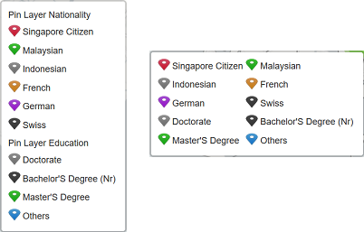

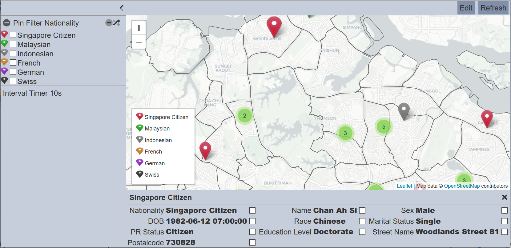

Pin Icon
The “Pin Icon” filter controls allows you to define the pin colour of a particular group of pins.

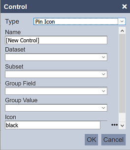

Click on the “n+” icon to add a new filter control.
Click on the “…” icon on the left of the filter control to display the “Control” dialog box. In the “Type” field, select “Pin Icon” from the drop-down list. The fields in the dialog box changes according to the selection.
| Type | Selects the type of filter control. | Drop-down list | Select from drop-down list | “Pin Icon” |
None |
| Icon | Selects the colour of the pin icon. | Popup dialog box | Select from popup dialog box | “black” |
Key in an unique name for the filter control in the “Name” field.
Click on the “…” on the right of the “Icon” field to display the “Icon” dialog box.
In the “Name” field, change to the desired colour (that is, if red is desired, change the name to “Red”). In the “Icon” field, click on the
icon to display the available colours and select the desired colour. You can also search for the desired colour using the search bar.
Click on the “OK” button to save the changes and close the “Icon” dialog box. Click on the “OK” button on the “Controls” dialog box to save the changes.
Repeat the above steps for the different values in the “Group Value” field for different types of pin (if desired). In this example, there are six different Nationalities in the dataset, one “Pin Icon” filter control for each nationality.
The “Pin Icon” filter controls are created and is ready to be added into the pin layer. Do note that the “Pin Icon” filter control works in the background and will not appear in the Filter Control Panel.

Include Filter Control to Pin Layer
Once the filter controls are created, they can be added into the pin layers.
icon of the Map Properties. The “Map Properties” dialog box will appear. Select the “Pin Layers” sub-section in the “Map Properties” dialog box. Click on the “…” of the desired pin layer.
In the “Pin Layer” dialog box, you may noticed that the “+” icon is displayed below the “Controlled By” field. If there are no filter control created, the “+” icon will not appear.
To add a filter control, click on the “+” icon. Select the desired filter control from the drop-down list. Repeat until all desired filter controls are added.
Upon saving the changes, the map will change according to the filter controls added.
In this example, all different nationalities have a different pin colour (using the “Pin Icon” filter controls). One “Pin Icon” filter control for each nationality.
The Information Panel at the bottom of the page displays the the selected information of the selected pin (enlarged red pin on the right of the map). The selected information is filtered using the “Info Filter” controls. One “Info Filter” control for each nationality.
In the Filter Control Panel, there are two filter controls. The “Pin Filter Nationality” filter control is created using the “Pin Filter” control and using the “Pin Icon” filter controls as options to filter the pins on the map. The “Interval 10s” filter control refreshes the map every ten seconds. The interval timer filter control does not have any selection.
You can add more to the GIS Explorer, such as proximity search into the Information Panel, tooltip or popups when hovered over the pins.

| Enabled | If selected, displays the legend onto the map. | Checkbox | Selected |
| Position | Defines the location of the legend to be displayed. Available options: - Top Left - Top Right - Bottom Right - Bottom Left |
Drop-down list | “Bottom Left” |
| Collapsed | If selected, allows the legend to be collapsed when not in use. | Checkbox | Not selected |
| Group By Layers | If selected, groups the legend by layers on the map. | Checkbox | Selected |
| Columns | Displays the legend in the number of columns defined. | Text box | “1” |
The “Enabled” field allows to enable or disable the display of the legend on the map by selecting or unselecting the checkbox respectively.
By default the legend is placed at the bottom left of the map. You can change the location by selecting one of the available options in the “Position” field.
It may not be desirable to display the legend on the map all the time as it may obstruct the view of the map. In this case, you may want to collapse the legend by selecting the “Collapsed” field. In this way, the legend will only be displayed when hovered over.
The list of items in the legend can be grouped together by their respective layers. To do that, select the checkbox in the “Group By Layers” field. That will group the items together according to their respective layer, with a title
The “Columns” field allows you to define how many columns are to be used to display the items in legend. By default, one column is used.

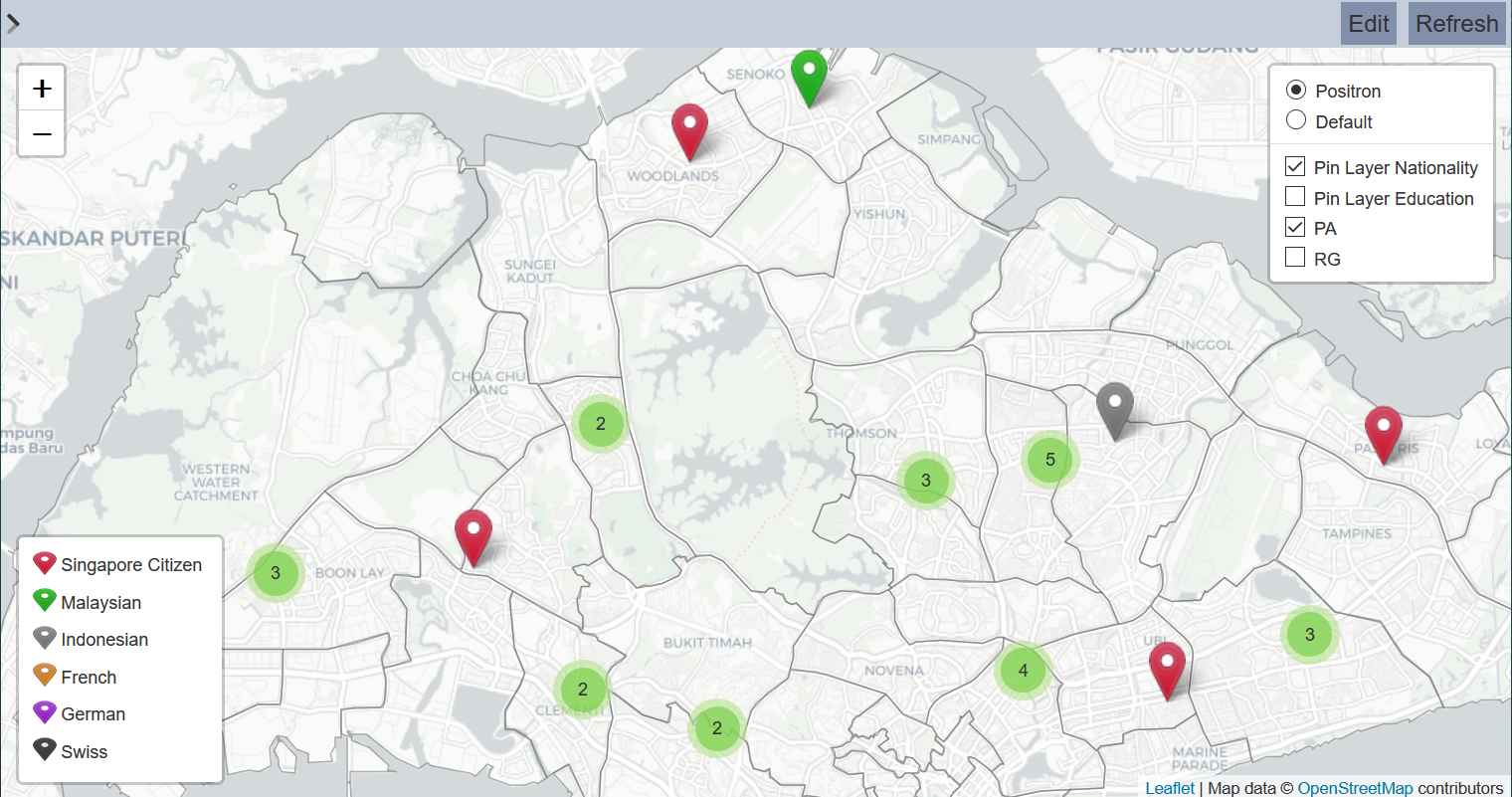

GIS Explorer
The GIS Explorer now has two tile layers, two geo layers, two pin layers and the appropriate filter controls for each pin layer. Upon landing in the GIS Explorer, the Positron tile layer, PA geo layer and Nationality pin layer are displayed.
To switch to or turn on other layers, simply click on the desired radio button or select the checkboxes.
Depending on the selection of the layers, different sets of demographic information can be presented in a single GIS Explorer.
