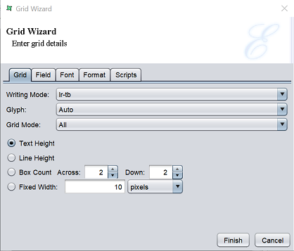

To add a Data Grid element, select the “Data Grid” button and click onto the location in the report where the element is to be placed. The “Grid Wizard” will appear.
There are five tabs. The last four tabs are similar to the Data Field element.
For the first tab, it has the following fields.
| Field | Description |
| Writing Mode | Defines the intrinsic direction rendering for a block of content. Default is “lr-tb”. |
| Glyph | Selects the orientation of the glyph. Default is “Auto”. |
| Grid Mode | Selects the type of grid. Default is “All”. |
| Radio Buttons | Selects one of the four radio buttons. By default, “Text Height” is selected. |
| Text Height | If selected, grid height is defined by height of text. By default, this field is selected. |
| Line Height | If selected, line height is defined by height of text |
| Box Count - Across - Down |
If selected, defines the number of boxes that fits the Data Grid element with the Across and Down fields. The value entered in the fields indicates the number of boxes to be placed across and downwards inside he grid element. |
| Fixed Width | If selected, width of each cell in the grid is defined by the value entered in the textbox. |

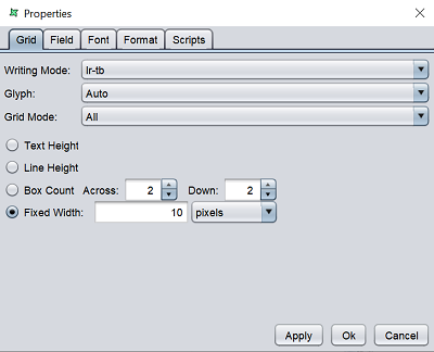

To edit the Data Grid element in the report template, double-click on the Data Grid element to display the “Properties” dialog box.
The tabs are similar to the Data Grid Wizard.
