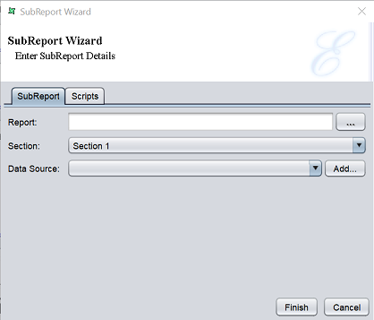

To add a sub-report in the report, select the “Sub-Report” button and click on the location where the sub-report is to be placed. A “SubReport Wizard” will appear.
The wizard consists of two tabs:
- SubReport - Allows you to define the sub-report
- Scripts - Allows you to add Java scripts for “Render If”, “On Render Begin” and “On Render End”
In the “SubReport” tab, either key in the path to the report or click on the
button to select the desired report from the repository for the “Report” field. Select the desired section for the sub-report to render in from the drop-down list for the “Section” field. By default “Section 1” is selected. In the “Data Source” field, select the desired datasource from the drop-down list or click on the
button to select a datasource from the repository. This field can be left blank to indicate the default datasource defined by the chosen section.

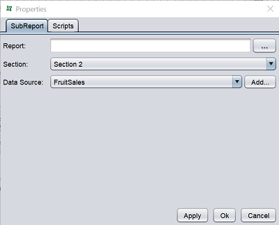

Edit Sub-Report
To edit the Sub-Report element in the report template, double-click on the Sub-Report element to display the “Properties” dialog box.
The tabs in the dialog box is similar to the Sub-Report Wizard.
