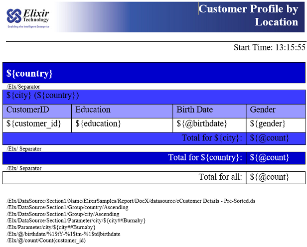

Example of DocX File
Below is an example of a DocX file. The upper part of the DocX file defines the format of the report. The first line below the table defines the location of the datasource file. The rest defines the order and the format of the fields used.
The datasource file must reside in the location defined in the DocX file, otherwise an empty report will be generated.

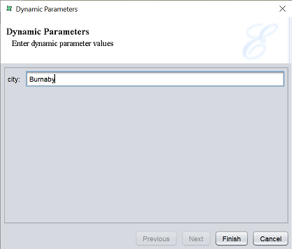

To render the report, select the DocX document from the Repository and right-click it. Select the “Render” option from the pop-up menu.
The “Dynamic Parameters” dialog box will appear.

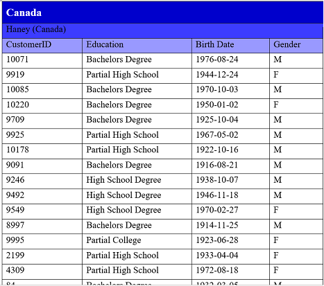

Key in the desired city in the “city” field. Click on the “Finish” button to render the report. The output report will be rendered and displayed in Microsoft Word.
In the example below, the city defined is “Haney”. The report is generated using the DS file as content and the DocX file as template.
