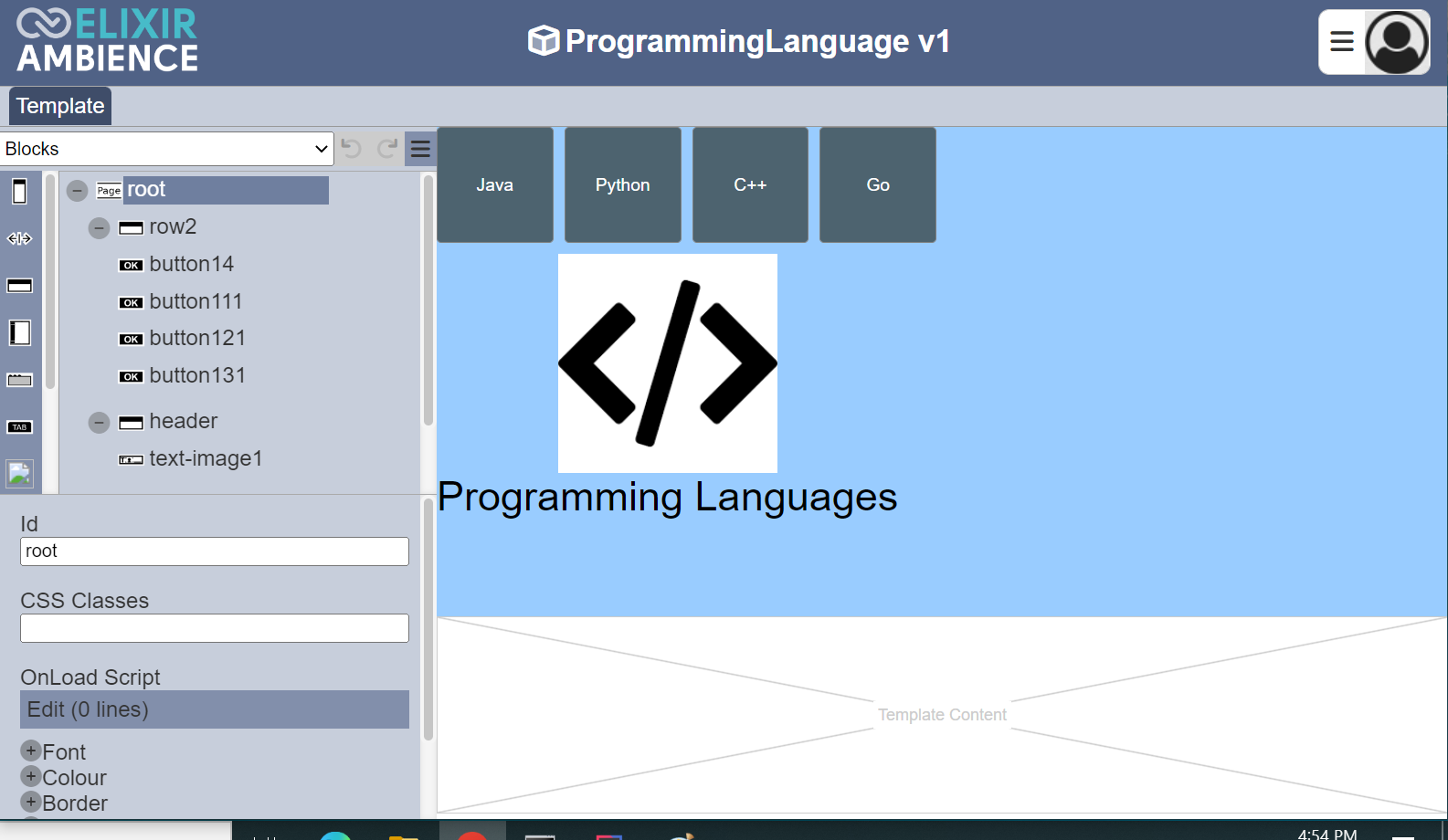

The Designer consists of two panels. The left panel displays the hierarchy, the components and their properties. The right panel displays the template/page, allowing you to visualise the template/page as you design it.
The left panel displays the available actions for the selected component in the template/page. It has three parts; the top row, tree structure in the middle and component properties at the bottom.

Root
Every template/page has a root, this is by default. The root presents the blank template/page itself until components are added onto it.
You can define the root using its properties. The properties for root
is different for template and page. Below are the screenshots for template and page respectively.
