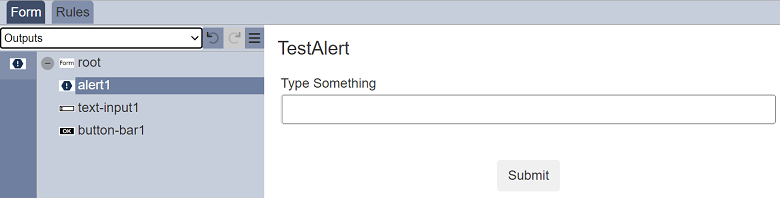

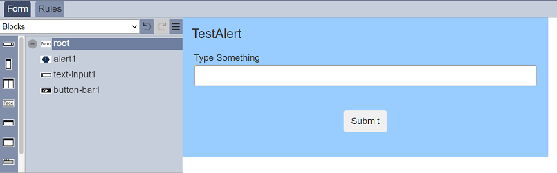

Create Form
In the Forms module, create a simple form named “TestAlert” with the following components:
  • Alert component
  • Text Input component
  • Button Bar component

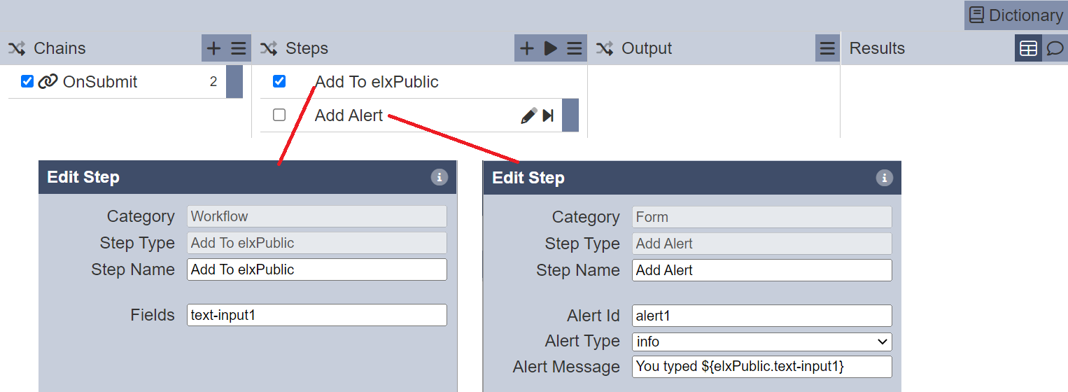

Create ETL
In the ETL module, create an ETL chainset named “OnSubmit” with two ETL steps.

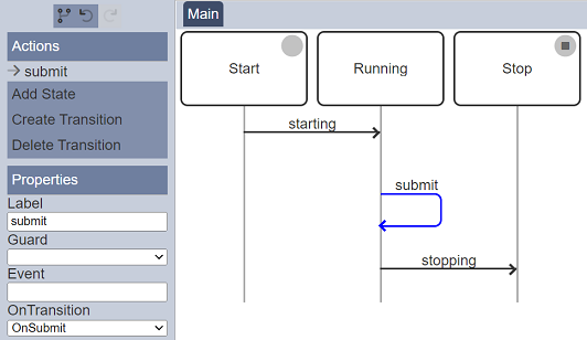

Create Workflow
In the Workflow module, create a simple workflow and name it “AlertWorkflow”.
In the “submit” transition, select “OnSubmit” ETL from the drop-down list in the “OnTransition” field.

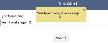

Run Form
In the Forms module, run TestAlert with the AlertWorkflow created earlier.
In the form, enter any text in the textbox and click on the “Submit” button. A pop-up box will appear prompting you the text you have entered in the textbox.
Click on the “X” button to close the pop-up box.
