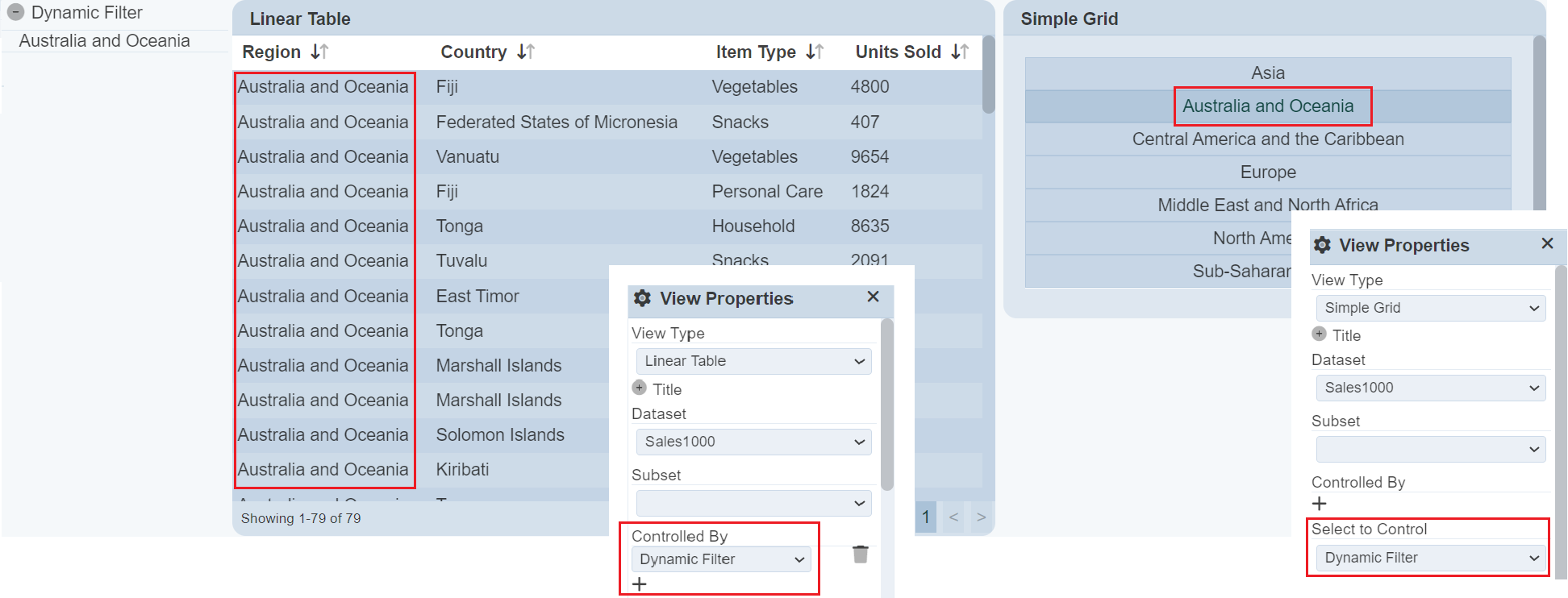

First, in the Dynamic Filter properties, select the desired dataset in the “Dataset” property and the desired field as the control in the “Filter” property.
In the Simple Grid view, select the newly created Dynamic Filter in the “Select to Control” property.
In the Linear Table view, select the same Dynamic Filter in the “Controlled By” property.
Ensure the two views are using the same dataset as the Dynamic Filter.

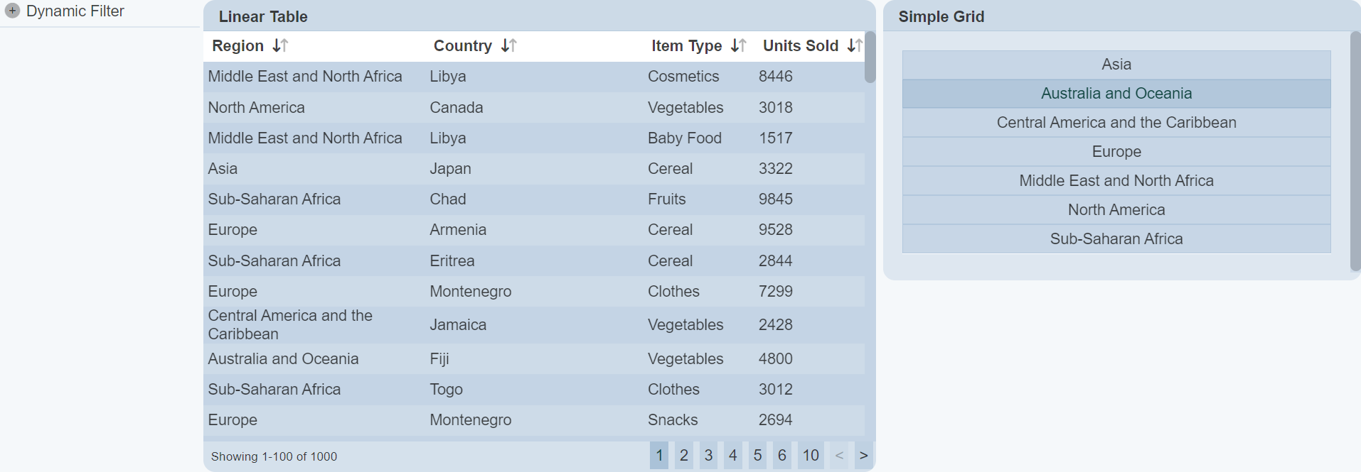

By default, when no value is select in the Simple Grid view, the Dynamic Filter will not display any value in the Filter Control Panel. The Linear Table displays the contents on all regions in the dataset.
Select a region in the Simple Grid, in this case “Australia and Oceania” is selected. The Dynamic Filter displays “Australia and Oceania” in the Filter Control Panel and Linear Table displays only the content of Australia and Oceania.
In this case, the values in the Simple Grid view act as radio buttons that controls the content of the Linear Table. To unselect the value in the Simple Grid view, click on the value again.
