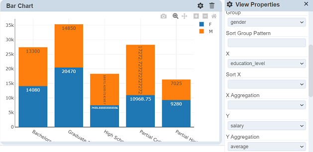

Below is an example. Create a bar chart as in the screenshot below.

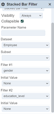

Set the Stacked Bar Filter control by selecting the bar chart’s Group By
field as “Field #1”. Set the bar chart’s X
field as “Field #2”.

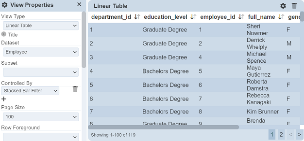

Next create a linear table using the same dataset. Add the Stacked Bar Filter control to the Linear Table’s Controlled By
property.

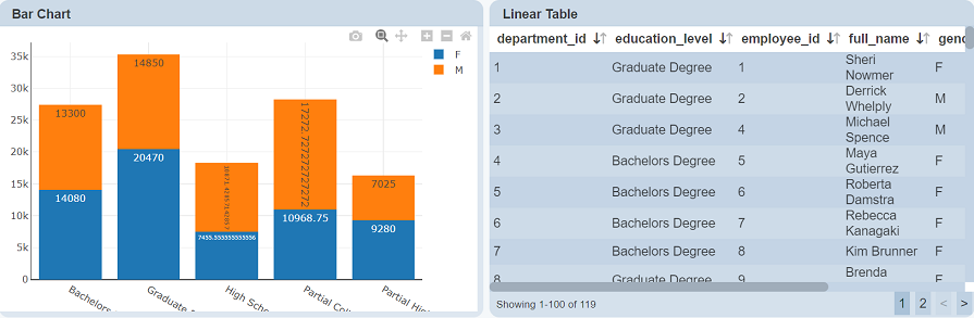

In this example, the selection on the bar chart view controls the displayed records on the linear table view. If exactly the same dataset is used on both bar chart and linear table views, the latter would effectively display all records that are aggregated into the selected bar.
Once all are set up properly, the bar chart and line table shows all the records in the dataset.

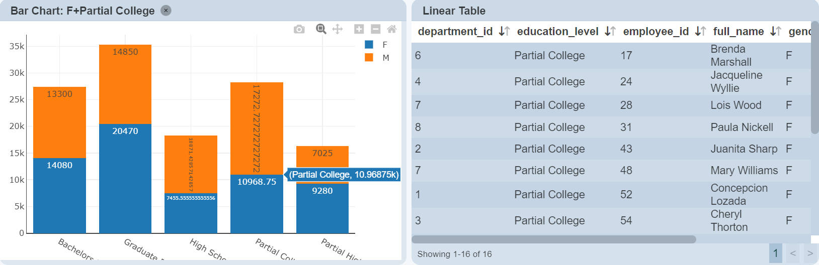

Click on any bar on the bar chart view. The displayed records on the linear table displays only the records for the selected bar.
In this case, the bar for gender “F” and education_level “Partial High School” are selected. This is also reflected on the bar chart view’s title as shown above. It appends the title given to the view, if any.
If the Stacked Bar Filter control is displayed on the control panel, the fields also reflect the selected bar’s values.

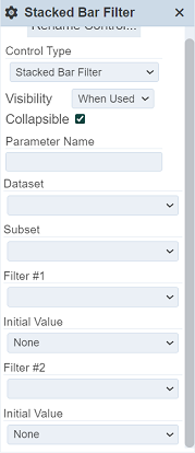

Group | Dataset field used to group the values of the field selected in the “Filter” property. | Y | Select | One value can be selected. All fields of the selected dataset/subset combination. The dataset and subset (optional) must be selected first. | “None” |
Initial Values (first) | Determines the initial set or selected values upon loading in the Dashboard Viewer. This corresponds to the field selected for the “Filter #1” property. | Y | Select | One value can be selected. Available options are: - None (all options are deselected) - First (only the first displayed option is selected) - Last (only the last displayed option is selected) - All (all of the options are selected) - Values (first element of comma-separated values entered in the field that appears below this property; spaces are allowed before and after the comma) ![]() |
“None” |
Initial Values (second) | Determines the initial set or selected values upon loading in the Dashboard Viewer. This corresponds to the field selected for the “Filter #2” property. | Y | Select | One value can be selected. Available options are: - None (all options are deselected) - First (only the first displayed option is selected) - Last (only the last displayed option is selected) - All (all of the options are selected) - Values (first element of comma-separated values entered in the field that appears below this property; spaces are allowed before and after the comma) ![]() |
“None” |
