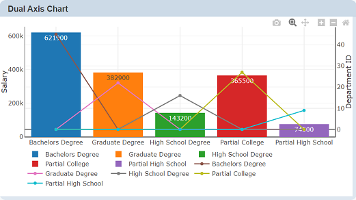

Dual Axis Chart
A dual axis chart allows you to display two types of charts together with the same X axis, using the same dataset.

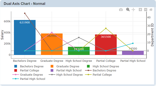

When “YAxis Ranges” is set to “Normal”, both charts will use their respective Y-axis settings. In this example, YAxis 1 and YAxis 2 have the following settings:
- YAxis 1
- “Autorange” = false
- “Min padding (%)” = 10
- “Max padding (%)” = 25
- YAxis 2
- “Min padding (%)” = 20
- “Max padding (%)” = 5

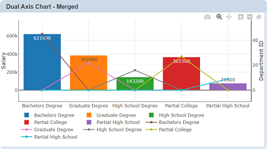

When the “YAxis Ranges” is set to “Merged”, the Y-axis settings of both charts will merge together, taking the higher value of the same field. YAxis 1 and YAxis 2 now has the following settings: * “Min padding (%)” = 20 * “Max padding (%)” = 25
