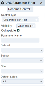

Parameter Name | Parameter defined in dataset aggregation pipeline. | Y | Textbox | Align with the parameter in aggregation pipeline of dataset | Empty |
Filter | Selects the field to control from the dataset. | Y | Drop-down list | Select from drop-down list | Empty |
Default Select | Defines whether to display all or no data initially in the Dashboard Viewer. Available options: - All - None |
Y | Drop-down list | Select from drop-down list | “All” |

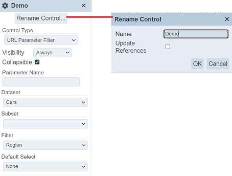

In the URL Parameter filter, select the desired dataset and field to filter in their respective fields. If it is desired to display all records, select “All” in the “Default Select” field. Selecting “None” in this field will display an empty table. In this example, select “None”. Rename the filter to a desired name. In this case, “Demo” is used.
For diagnostic purpose, select “Always” in the “Visibility” field. This will shows the selection in the Control Panel.

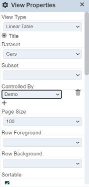

In the properties of the Linear table, select “Demo” in the “Controlled By” field.

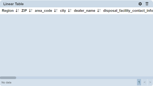

Save the changes. The linear table should display empty.

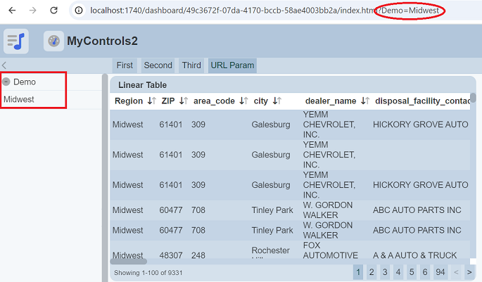

In the address bar, key in ?Demo=Midwest
at the end of the URL and hit the “Enter” key. The linear table now display the records in the “Midwest” region. The URL Parameter filter in the Control Panel shows the value used in the URL.

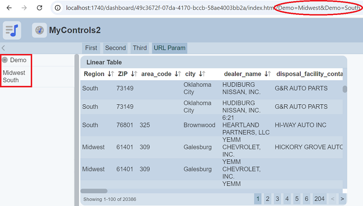

Multiple values can be used in the URL using the &
operator. Try ?Demo=Midwest&Demo=South
and the table display records from “Midwest” and “South”. The values are ORed together.
