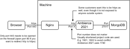

Deployment
Simple Deployment
For simple deployment, a single host is used. Below is an example using Ambience.
Below is a sample Nginx configuration.
server {
listen 442 ssl;
server_name bladnoch.elixirtech.com;
ssl on;
ssl_Certificate /opt/cert/elixirtech.pem;
ssl_certificate_key /opt/cert/elixirtech.key;
location / {
proxy_pass http://localhost:8080/;
In this case, the internal port is set to 8080.

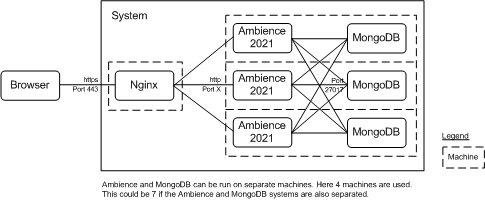

High Availability Deployment
High Availability (HA) refers to systems that are durable and likely to operate continuously without failure for a long time. If the system gets split, one side will have the majority of the machines, and that side will continue until the problem is resolved. Taking Ambience for example, the simplest HA setup will be two Ambience servers and a MongoDB server with a load balancer. A full HA setup will be two+ Ambience server and one MongoDB replica set with load balancers. A load balancer (typically Nginx) is on a separate machine. The diagram below shows a HA deployment.
The Ambience and MongoDB can be run on separate machines. To avoid the single point of failure, another Nginx machine can be added and the DNA name server can be setup with an A record for each Nginx machine and a short TTL. For cost saving, the three MongoDB servers can be replaced by two with one lightweight “Arbiter”, which does not store data, but acts as the third machine in the case of a split. Docker can be used to simplify deployment of these machines, and higher-level tools (such as, Docker Compose, Kubernetes, etc.) can be used to deploy an entire set of machine configurations at once. If the management of the deployment becomes tedious, then it might be worth investing that time to use these tools.
