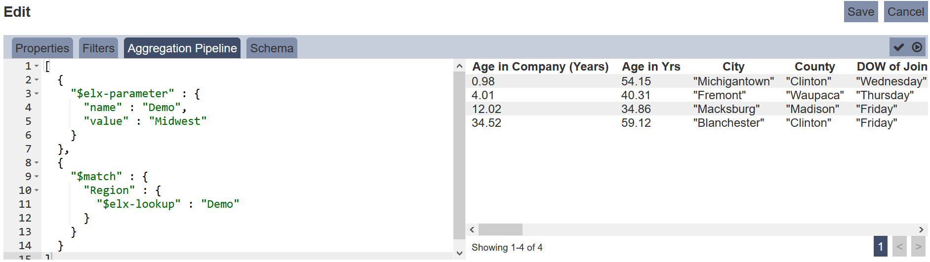

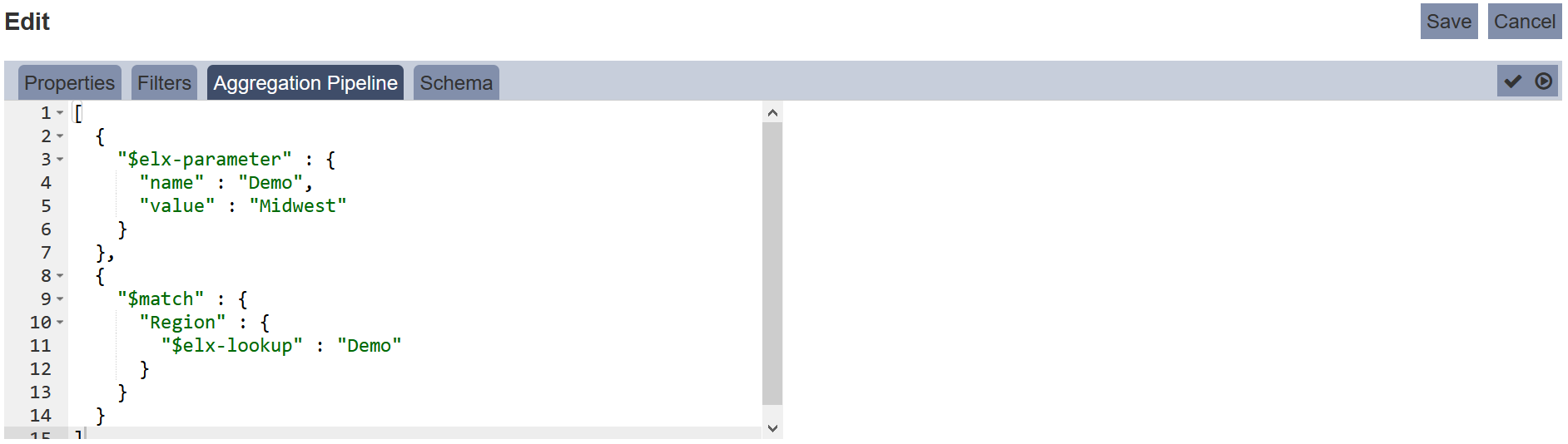

In the Dataset Management, select the desired dataset and click on the “Edit” icon under the “Actions” column. In the “Edit” panel, select the “Aggregation Pipeline” tab. Key in the code as required. Click on the “Save” button to save the code. Click on the “Cancel” button to abort the action.
In the above code, the parameter “Demo” will look for the matching “Region” field as in the data collection. The value for parameter “Demo” is set as “Midwest”.
To test the code, click on the “Test Aggregation” icon at the upper right corner of the panel. The result is displayed on the right side of the panel, showing all data records with the value “Midwest” in the “Region” field.

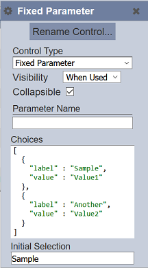

Fixed Parameter Control Specific Properties
Parameter Name | Parameter defined in dataset aggregation pipeline. | Y | Textbox | Align with the parameter in aggregation pipeline of dataset | Empty |
Choices | Determines the selectable values in the control filter in the Dashboard Viewer. | Y | Textbox | Must align with the values of the field defined in aggregation pipeline of dataset | Sample code |
Initial Selection | Determines the initial value of the filter control upon expanded for selection. | N | Textbox | One of the choices in the “Choices” field | Sample Corresponds to the first label in “Choices” field |

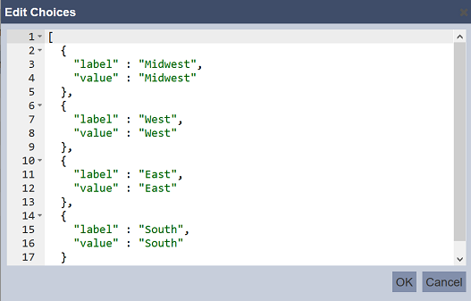

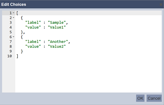

In the “Parameter Name” field, key in “Demo” as defined in the aggregation pipeline example. To edit the code in the “Choices” field, click on the textbox and the “Edit Choices” dialog box will appear with a sample code.
The “label” field will be the label that will appear in the drop-down list in the filter control in the Dashboard Viewer. The “value” field will be the value for “label”.
For the example above, the below code is added into the “Choices” field.
