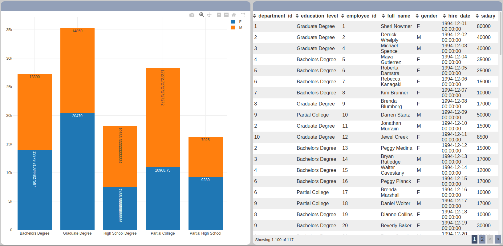

To use as a mechanism that allows a selecting a bar on a bar chart to control the data displayed on another view, both views must have relatable datasets. This means that both datasets used on both views must at least have the same two fields and data types.

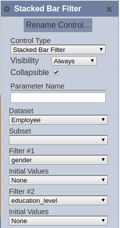

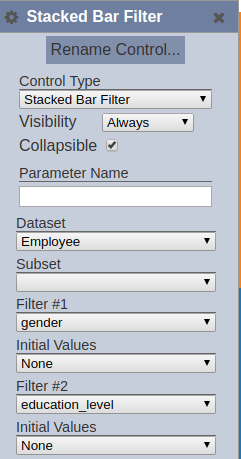

Set the Stacked Bar Filter control by selecting the bar chart’s Group By
field as “Field #1”. Set the bar chart’s X
field as “Field #2”.

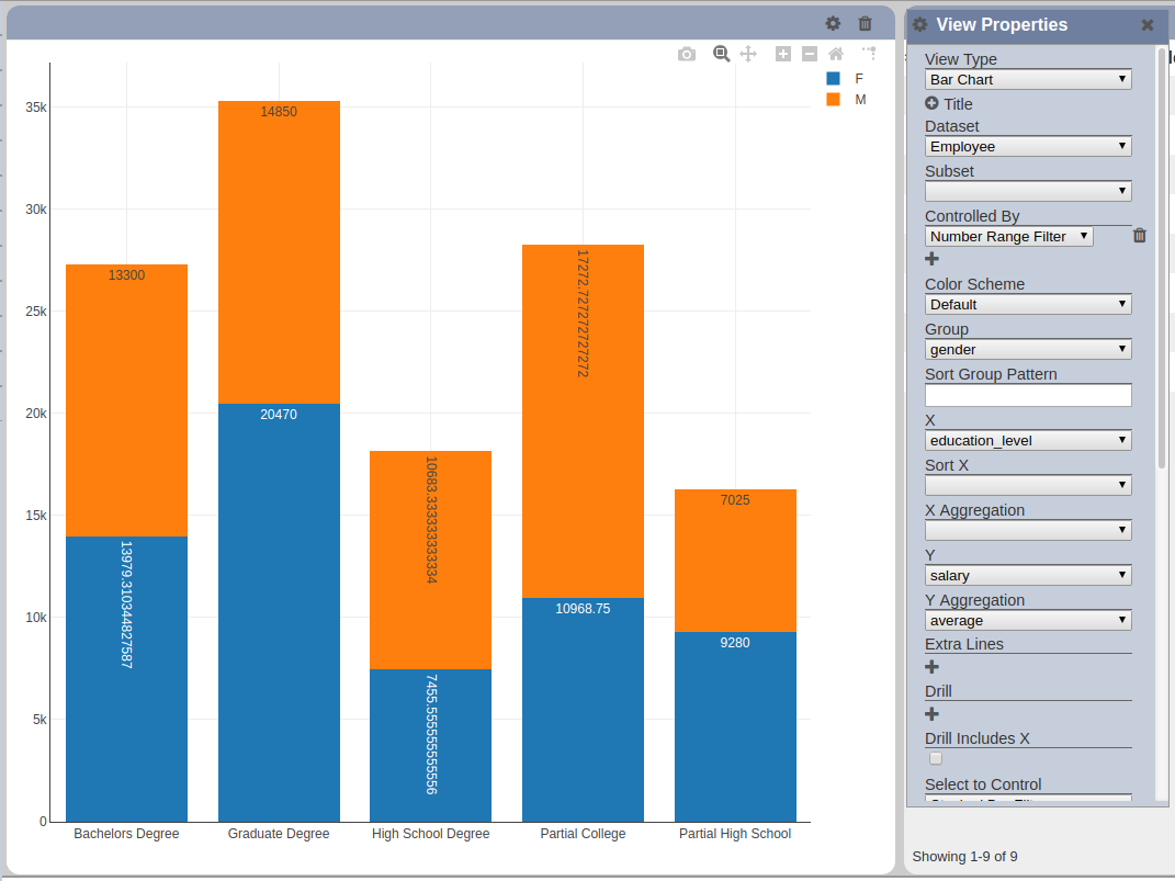

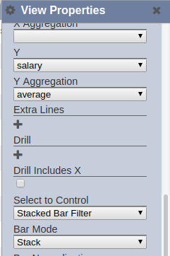

Add the created Stacked Bar Filter control to the bar chart view’s Select to Control
property. Sample of the bar chart’s set properties is shown below.

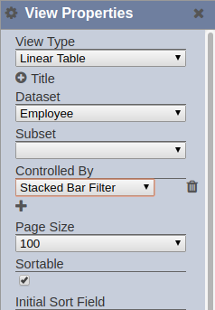

In this example, the selection on the bar chart view controls the displayed records on a Linear Table view. If exactly the same dataset is used on both bar chart and Linear Table views, the latter would effectively display all records that are aggregated into the selected bar. Add the new control to the Linear Table’s Controlled By
property.

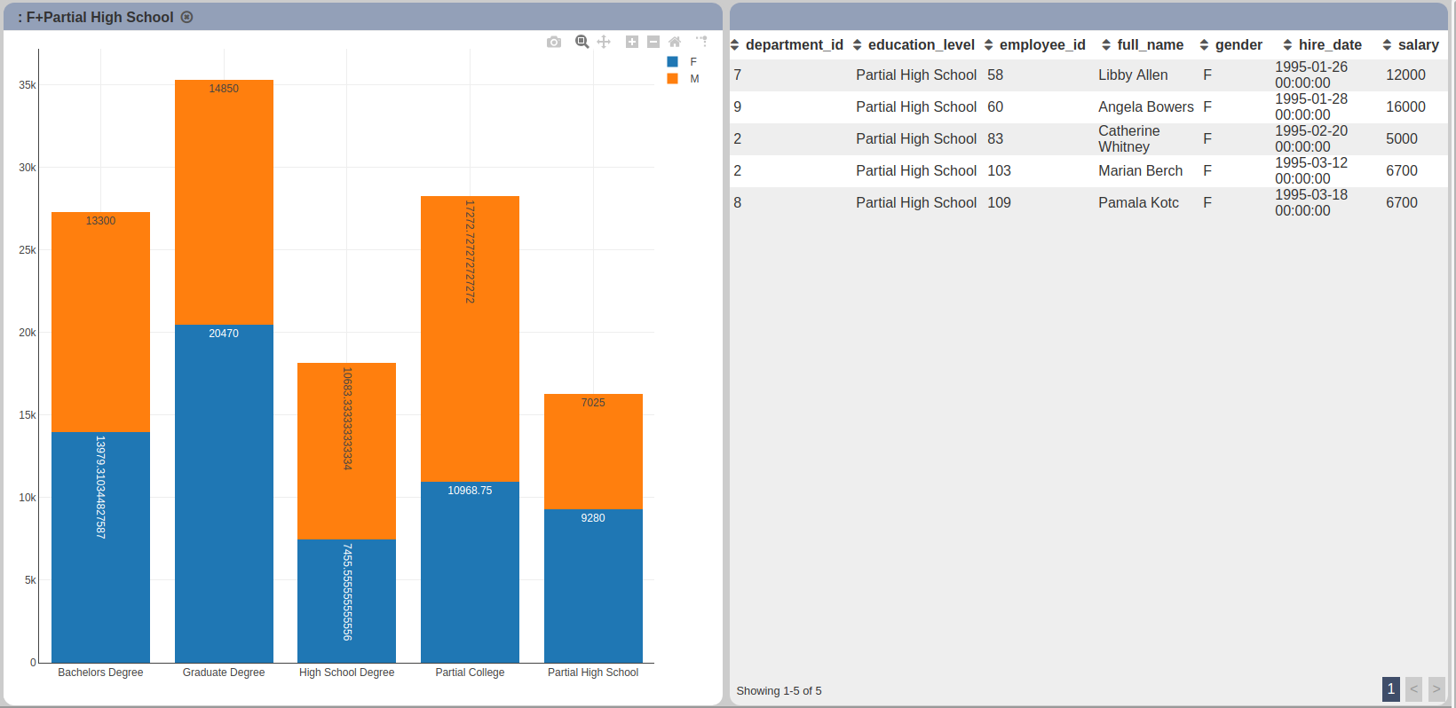

Once saved, click on any bar on the bar chart view. The displayed records on the Linear Table displays only the records for the selected bar.
The bar for gender “F” and education_level “Partial High School” has been selected. This is also reflected on the bar chart view’s title as shown above. It appends the title given to the view, if any.
If the Stacked Bar Filter control is displayed on the control panel, the fields also reflect the selected bar’s values.
