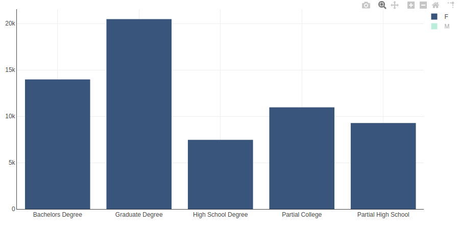

Clicking on a legend key deselects/selects it. Deselecting a legend key excludes its corresponding data trace from being displayed on the view.
Note that toggling the display of data traces through the legend does not affect selected values for any filter associated to the view. It also does not involve any fetching or refreshing of data.

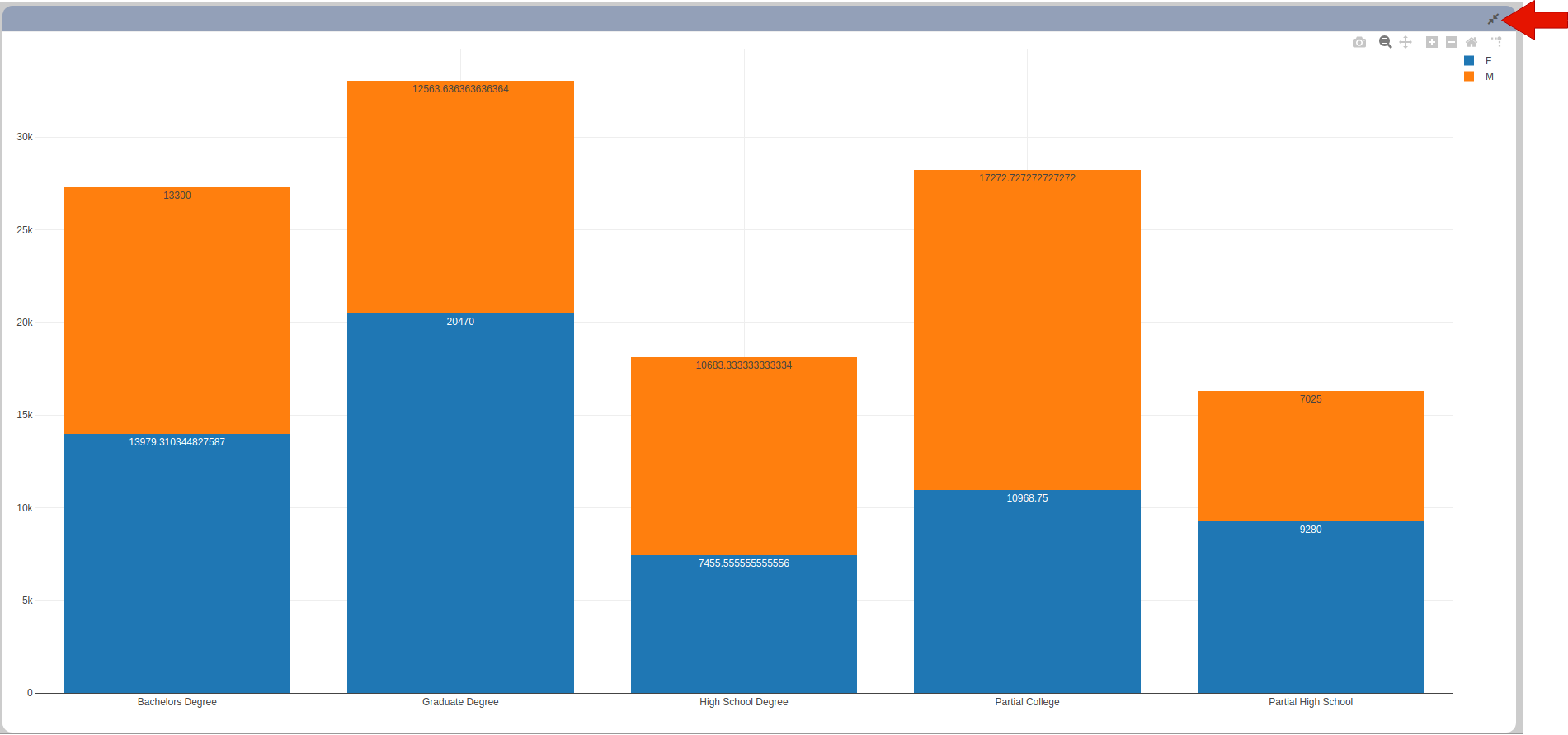

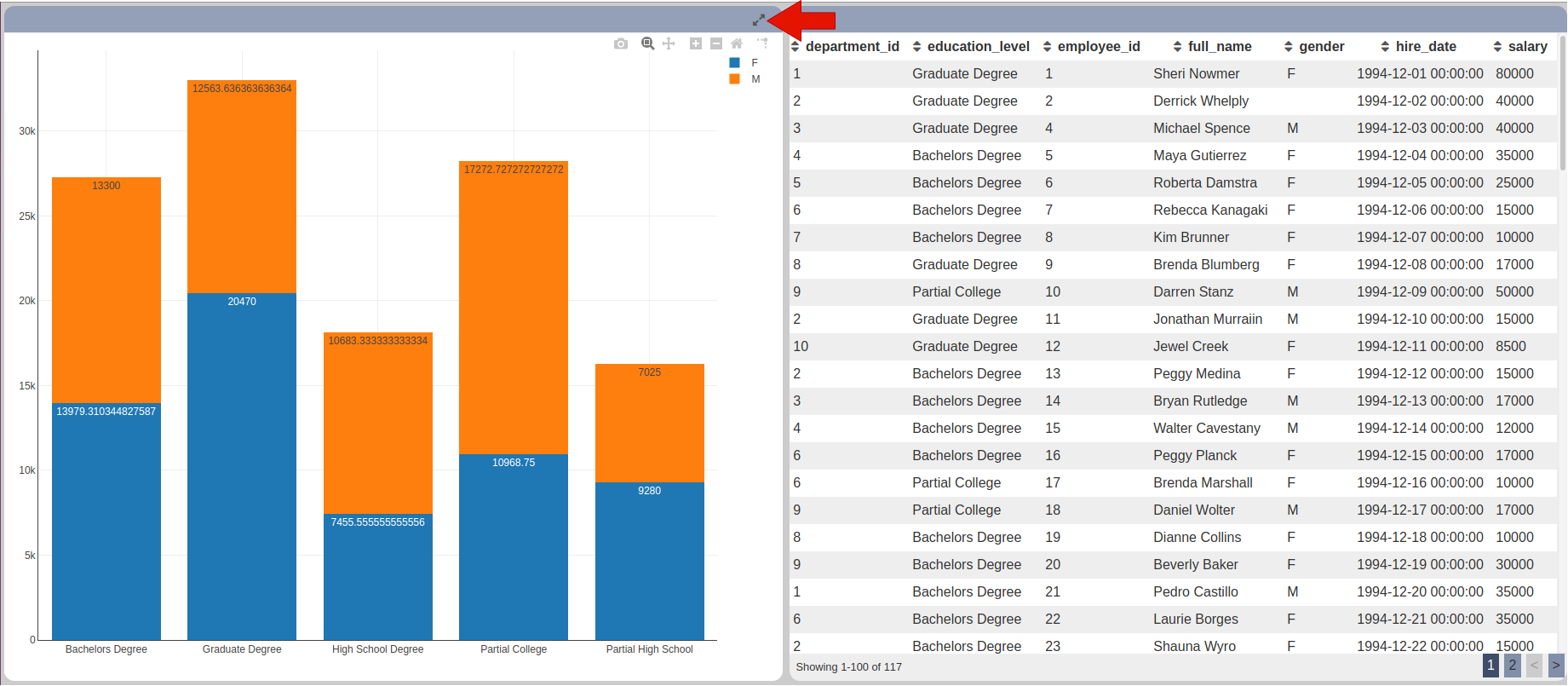

Maximisable
This allows the view to be maximised and restored (revert to original size) on the viewer.
If enabled, a “Maximise” button appears on the view’s grid box title bar.
When the button is clicked on the Viewer, the view would be displayed on the entire dashboard view area.
To revert, click on the “Restore” button.
The property is disabled by default.

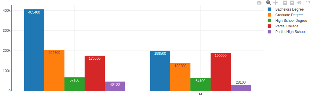

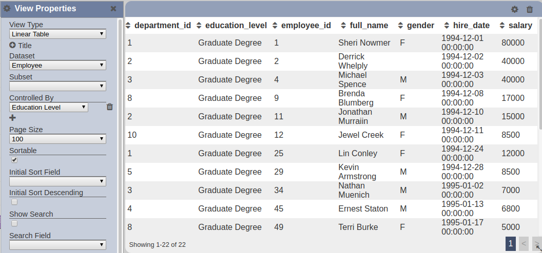

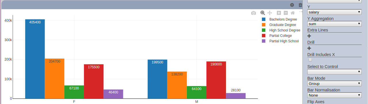

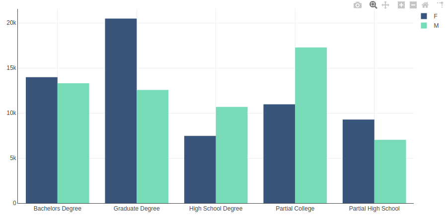

Select to Control
This property allows the view to manipulate the selected value of a select filter control. This is typically used to add an interaction on the dashboard. A chart type of view is usually used with this property to enable selecting a data group/trace (field used in the legend displayed) on it to change the value of a select filter control, which subsequently filters the data on the views that are linked to the control.
Field | Input Type | Constraints | Default Value | Dependency |
Select to Control | Select | One value can be selected. Names of all “Select Filter” controls are available options. |
None | None |

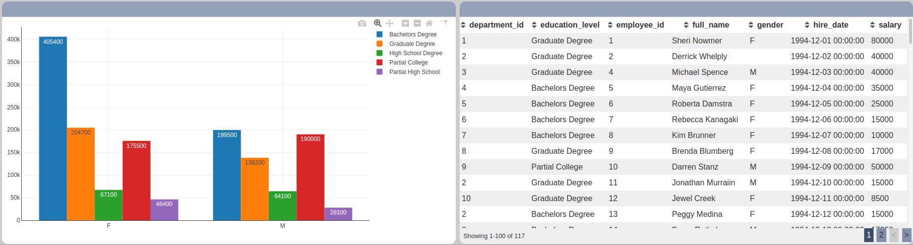

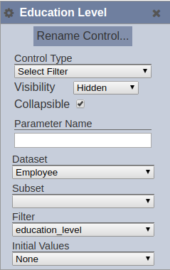

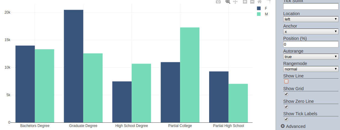

To set up this type of interaction, know what data and field should be used. A minimum of three dashboard components are required to complete this:
- view (View 1) that controls the select filter control
- select filter control (Filter 1)
- view (View 2) that is linked to the select filter control
The datasets used in each of these do not have to be the same but they would have to have the same field name, at the very least. If datasets used for each are different, the list of distinct values for the said field should ideally be the same.
In this example, the field selected to be used is “education_level”. To simplify the example, all three components would use the same dataset, the “Employee” dataset.
Start by setting a select filter control first. Refer to the guide here for adding a select filter control. Setting the control’s visibility to “Hidden” makes the interaction appear more seamless on the Viewer.

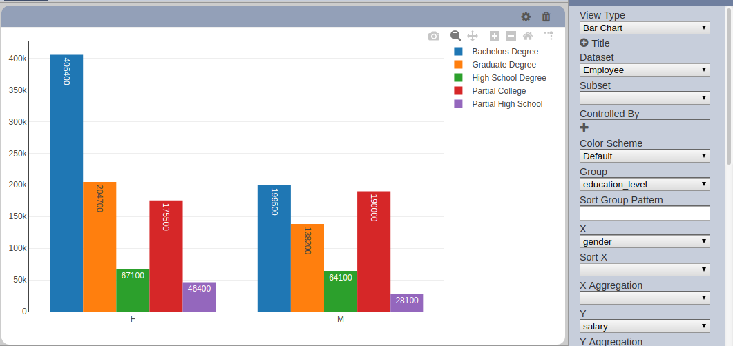

On View 1, set it to a view type that has this property. For this example, a bar chart is used.
Set the bar chart’s properties and ensure the data grouping is using the identified field, “education_level”.
Set the “Select to Control” property to the name given to Filter 1.
On View 2, select any view to be linked to Filter 1. For this example, a linear table would be used for simplification. Set the “Dataset” property and add Filter 1 to the “Controlled By” property.
Save the changes to exit the Designer and to view it on the Viewer.
Click on a data group/trace in View 1. View 2 subsequently re-renders the data to display only the records that are under the same data group (“education_level”).
In the example, the “Partial High School” data trace is selected on View 1.
Note that the this property takes precedence over the “Drill” property if both are enabled. This effectively means that the “Drill” property won’t be enabled if “Select to Control” is set.

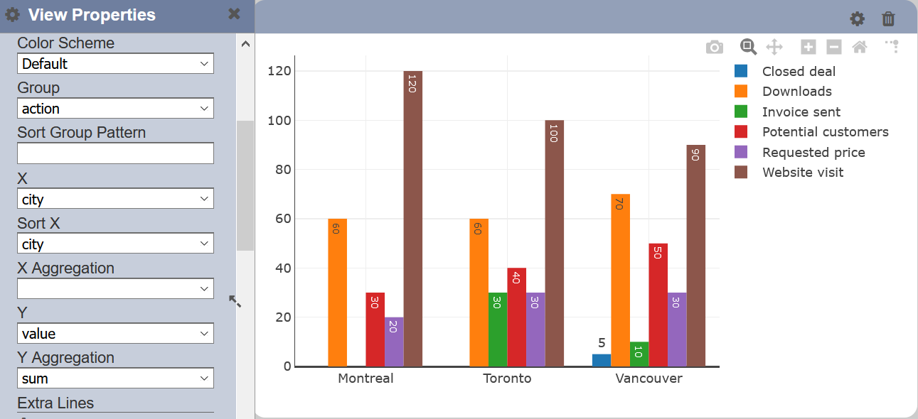

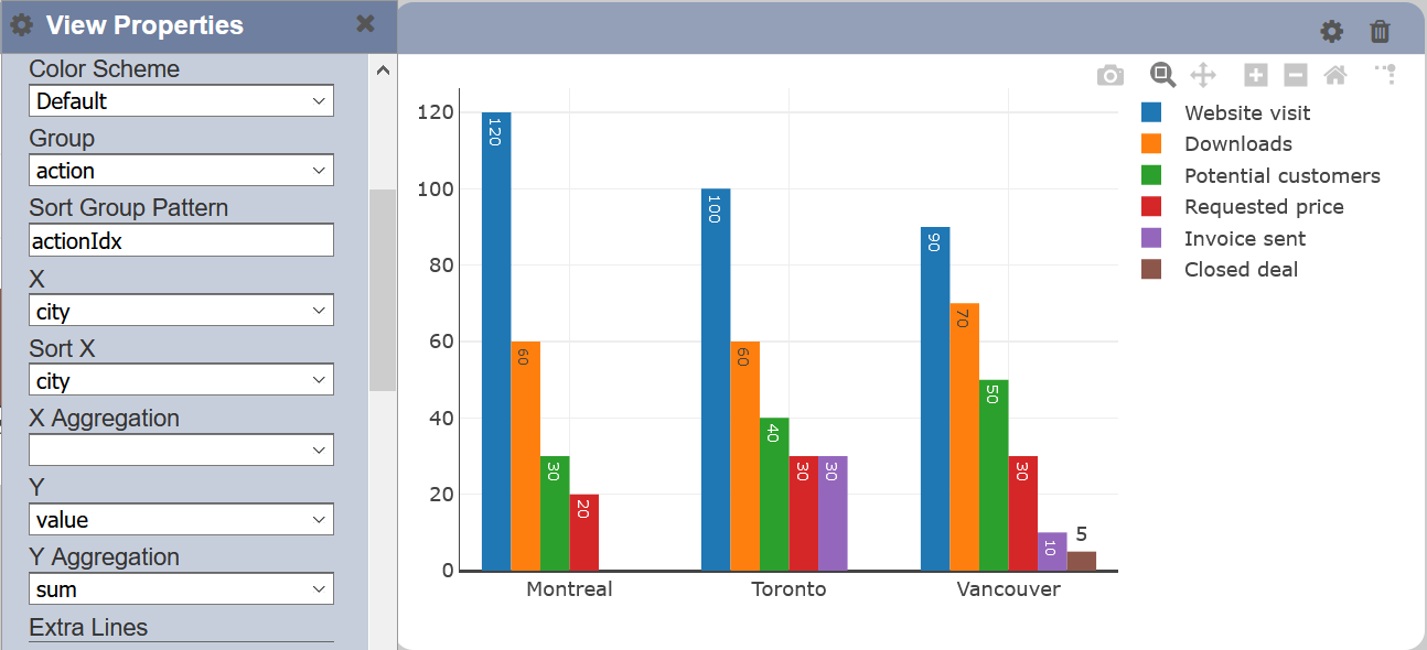

Sort Group Pattern
This sets the field to be used to sort the “Group” field. It is most useful to have a 1:1 correspondence between the “Group” and “Sort Group Pattern” values to ensure proper sorting of the values. If this property is not available, the “Group” field value will be used for sorting.
Sort Group Pattern | Textbox | Name of field to be used for sorting. | None | Group must first be set |
This is useful if the “Group” values have corresponding indices or codes that must be used for ordering.
To support drill down, a string with the format prefix:suffix
can be used.
For example, set the Pattern to :Idx
and actionIdx
will be used because the “Group” field is action
. That way, if you drill down to XXX
, then the system will expect a sorting field called XXXIdx
, so sorting can be supported while drilling down.
You can supply both a prefix and suffix. For example, if there is a hidden field _actionABC
(starting with an underscore), by keying in _:ABC
, you will find the _actionABC
column. Note that this field is not shown as an available field anywhere, thus it allows adding of sort columns without the user being confused by them.

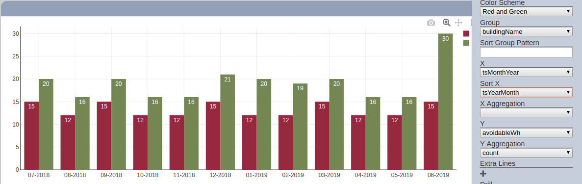

Sort X
This sets the field to be used to sort the X axis values. It is most useful to have a 1:1 correspondence between the “X” and “Sort X” values to ensure proper sorting of the X values.
X | Select | One value can be selected. All fields of the selected dataset/subset are available. |
This is useful if the X axis values have corresponding indices or codes that must be used for ordering. Another usage would be for displaying dates in different formats but must still be sorted chronologically.

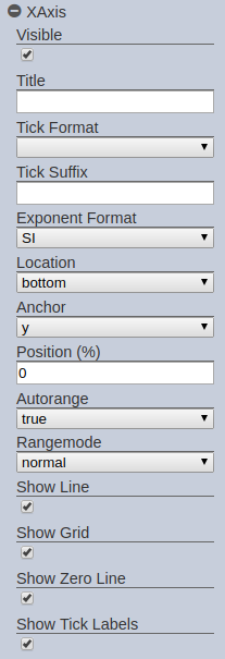

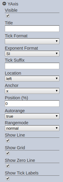

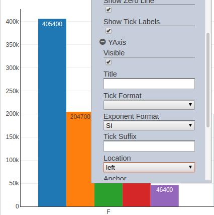

XAxis and YAxis
Each group of properties allows setting various display-related aspects of the X and Y axes, respectively. This includes formatting, sorting, titles, labels, positioning, axis display, etc.
The X and Y axes property groups have the same set, with some varying choices for some properties, such as “Anchor” and “Location”. For simplicity, the properties in this group would be demonstrated for the Y axis.
Visible
This property allows toggling between displaying and hiding its corresponding associated axis. If selected, which is the default set value, the associated axis is displayed entirely.
If deselected, the associated axis is hidden entirely, including the grid lines, title, labels, etc.
Note that the rest of the X and Y axis properties below would only be visible if this property is enabled.
Title
This property allows adding a title to the associated axis.
Field | Mandatory | Input Type | Constraints | Default Value | Dependency |
Title | N | Text field | Any text | Empty string | None |

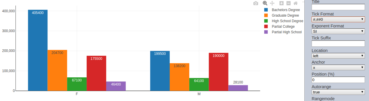

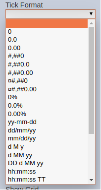

Tick Format
This property allows setting the format of the labels on the associated axis. These formats are available for numeric and date values.
Tick Format | Select | One value can be selected. | None | None |

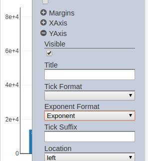

Exponent Format
This property allows setting the exponent format of the labels on the associated axis. This affects only numeric values.
Exponent Format | Select | One value can be selected. Available options are: - Exponent - SI - B |
“SI” | None |

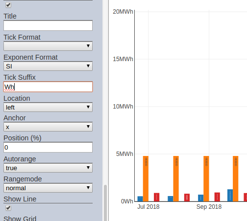

Tick Suffix
This property allows adding a static text as a suffix to the labels on the associated axis.
Tick Suffix | Text field | Any text | Empty string | None |

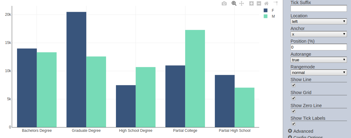

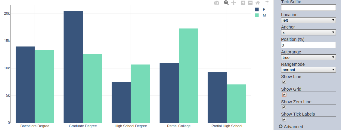

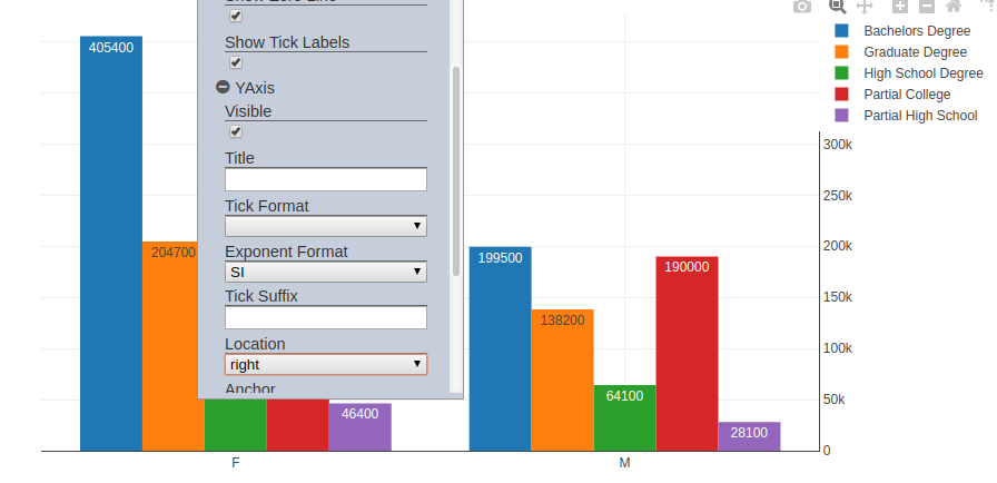

Location
This property determines where the associated axis labels and line should be displayed.
Location | Select | One value can be selected. For the X axis, “left” and “right” are available options, while “bottom” and “top” are available for the Y axis. |
“left” for X axis. “bottom” for Y axis. |
None |

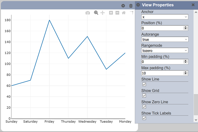

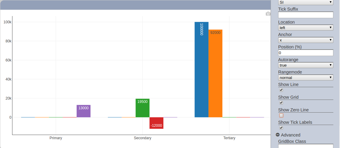

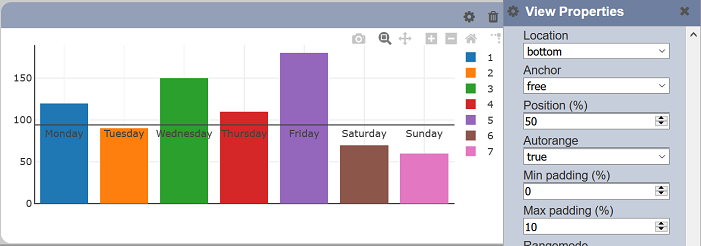

Anchor

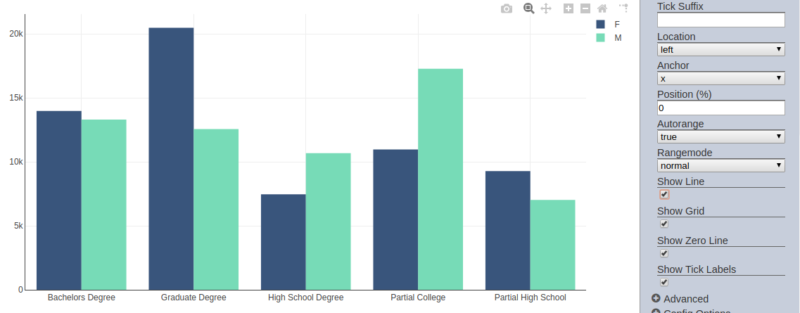

This property allows you to determine the location of the axis line.
Anchor | Select | One value can be selected. For the X axis, “y” and “free” are available options. For the Y axis, “x” and “free” are available options. |
“y” for X axis. “x” for Y axis. |
Position(%) |

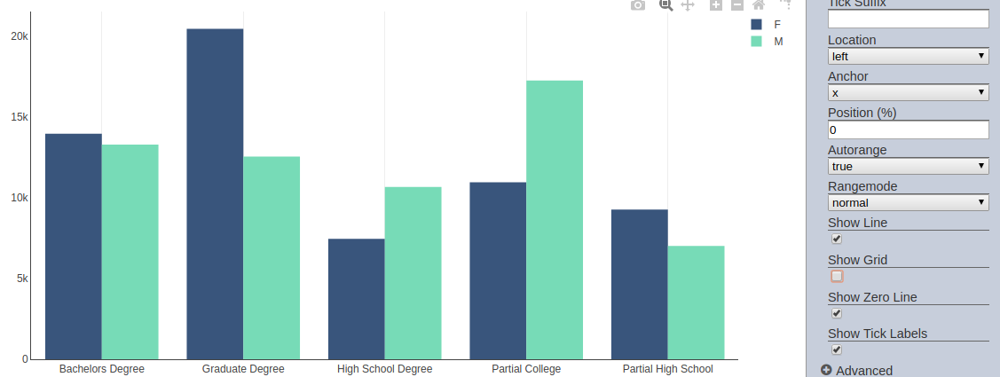

If “x” or “y” is selected in the “Anchor” field, the axis line will be fixed to the “0” value of the XAxis or YAxis respectively. If “free” is selected in the “Anchor” field, the location of the axis line will depends on the value selected in the “Position (%)” field.
Position (%)
This property determines the location of the axis line in the chart or view (in terms of percentage) and it is only effective if “Anchor” field selects the value “free”.
Position (%) | Numeric | One value can be selected. Values from 0 to 100. |
0 | Anchor |

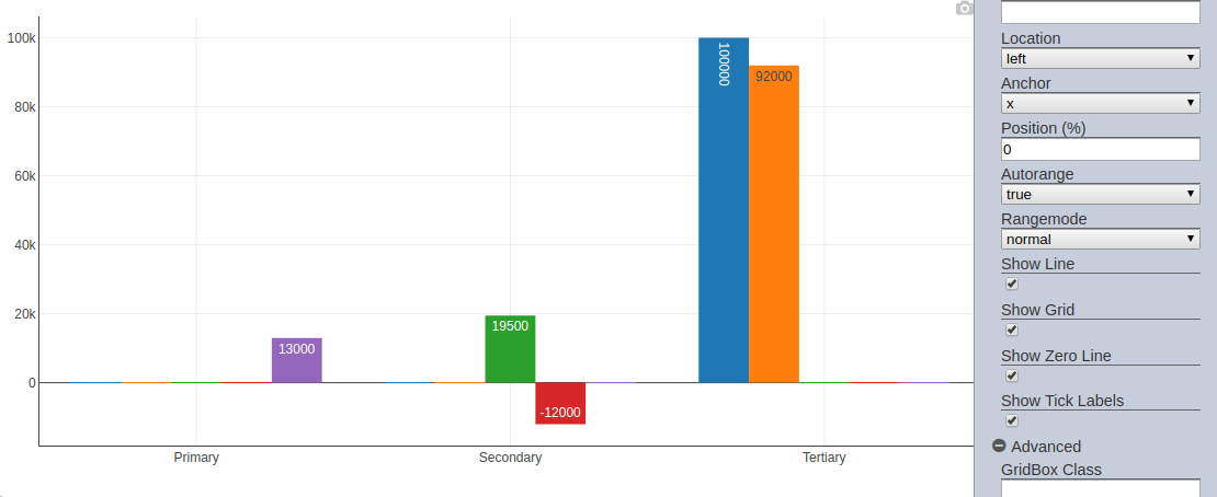

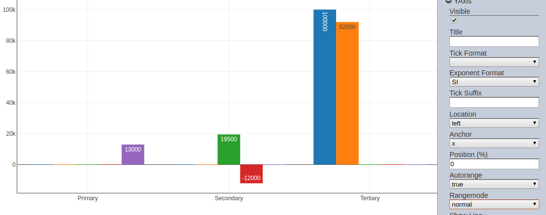

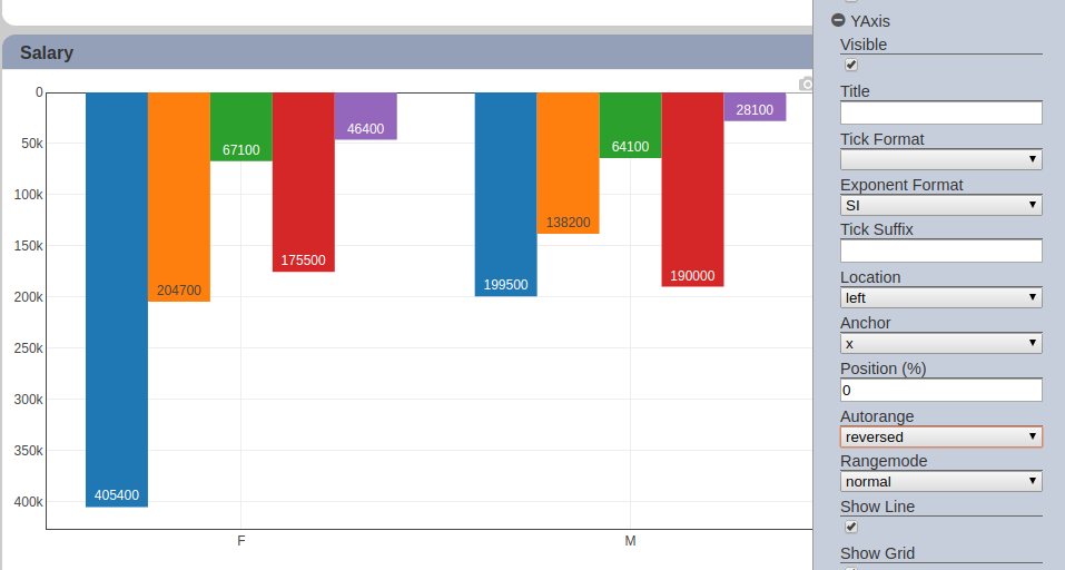

Autorange
This property determines how the associated axis range would be displayed by default.
Autorange | Select | One value can be selected. Available values are: - true - sets default axis range to include both floor and ceiling values on display; sorting is done in ascending order (left to right for X axis; bottom to top for Y axis). - false - sets the default displayed axis range to a fixed range - reversed - sets default axis range to include both floor and ceiling range values on display (similar to “true”; sorting is done in descending order (right to left for X axis; top to bottom for Y axis). |
“true” | None |

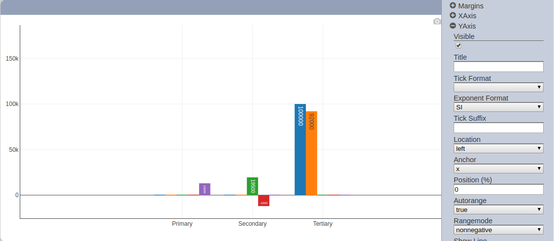

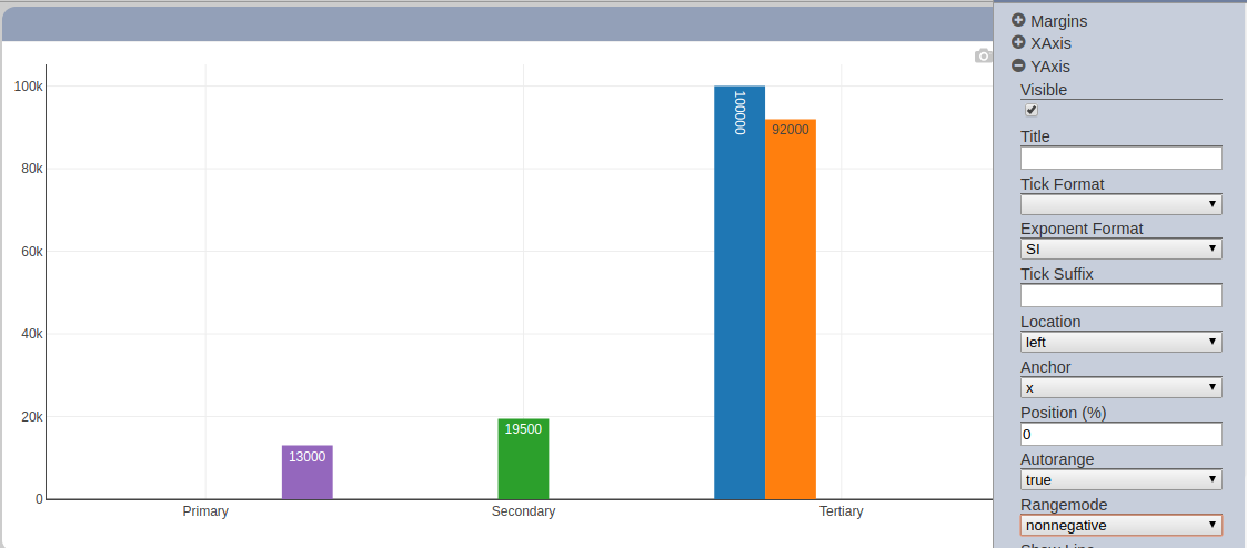

Range Mode
This property sets the default displayed starting point of the associated axis.
Range Mode | Select | One value can be selected. Available values are: - normal - tozero - nonnegative |
normal | None |
By default, “normal” is selected, which sets default display from starting range to floor value. Below are the available options:
- normal - sets default displayed starting range to floor value (may not start from zero)
- tozero - sets default displayed starting range to zero
- nonnegative - sets default displayed starting range to zero (negative values will not be displayed by default)
Note that negative values can still be viewed on the rendered view by zooming out.

Y
This sets the field to be used as the Y axis. Similar to other data-based properties, any record that does not contain the said field gets excluded from rendering.
Y | Select | One value can be selected. All fields of the selected dataset/subset are available. |
Y Aggregation
This determines the operation to be applied on the values of the field identified in “Y”. This works in conjunction with the “Y” property and is dependent on the option selected for it.
Y Aggregation | Select | One value can be selected. Available options depend on the data type of the selected “Y” field. |
“count” | “Y” property must first be set |
This property, where applicable, is usually required to be set to render the view. Usually numeric types are used for the Y axis.
If the Y field data type is numeric, the following options are additionally available:
- sum (sum of all values in a specific data group)
- average (simple average applied to all values in a specific data group)
If the Y field data type is non-numeric, only “count” is additionally available. This counts the total number of records for the data group.
In some views, such as the scatter chart, selecting no value for this property is available to plot each data point on the view. It may affect loading times though, especially if there are numerous data points.
