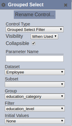

| Dataset | Name of the dataset that contains the data to be used as the control’s selector options. | Y | Select | 1 value can be selected. All enabled datasets are available options. | None |
| Subset | Subset of the dataset selected. | N | Select | 1 value can be selected. All enabled subsets of the selected dataset. The dataset must be selected first. | None |
| Group | Field of the selected dataset which would be used to group the “Filter” field values. | Y | Select | 1 value can be selected. All fields of the selected dataset/subset combination. The dataset and subset (optional) must be selected first. | None |
| Filter | Field of the selected dataset which contains the values to be used as the control’s selector options. | Y | Select | 1 value can be selected. All fields of the selected dataset/subset combination. The dataset and subset (optional) must be selected first. | None |
| Initial Values | Determines the initial set or selected values upon loading in the Dashboard Viewer. This corresponds to the field selected for the “Filter” property. This setting is applicable only for the second-tier options. | Y | Select | 1 value can be selected. Available options are: - None (all options are deselected) - First (only the first displayed option is selected) - Last (only the last displayed option is selected) - All (all of the options are selected) - Values (first element of comma-separated values entered in the field that appears below this property; spaces are allowed before and after the comma) |
“None” |
