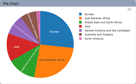

Pie Chart
A pie chart uses “pie slices” to show relative sizes of data.

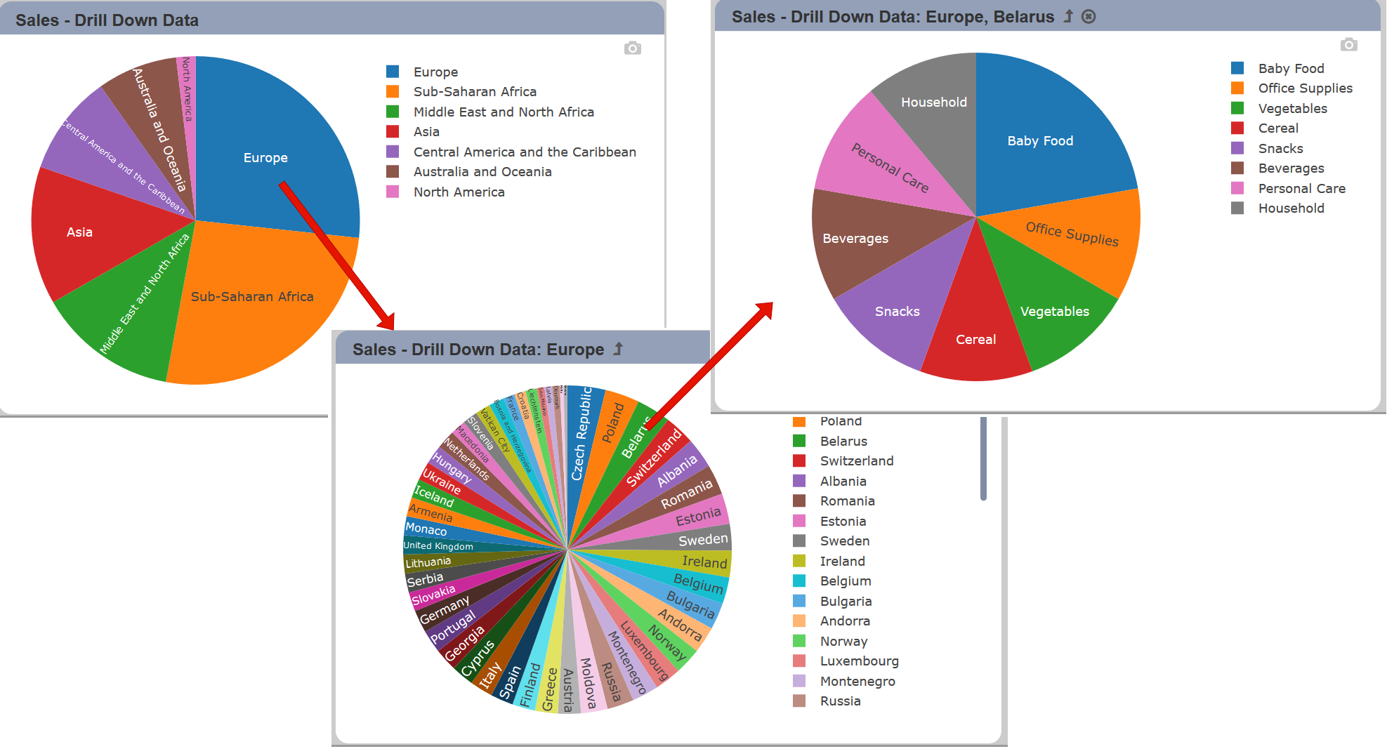

Example: Drill Down Data
You can use the “Drill” property to view the subset of the data, and the sub-subset of the data. In this example, the view displays the pie chart by region. You may want to drill down on the countries in a particular region, and drill down further to the item types of a particular country in that region. To do so, add “Country” and “Item Type” to the “Drill” property.
By clicking on the portion labelled “Europe”, all countries in the Europe region are displayed. To view the types of items sold in a country in Europe, click on any of the countries in the pie chart. In this case, Belarus is selected and the pie chart displays all items sold in Belarus.
icon on the title bar to return to the previous view or click on the
icon to return to the main view (if available).

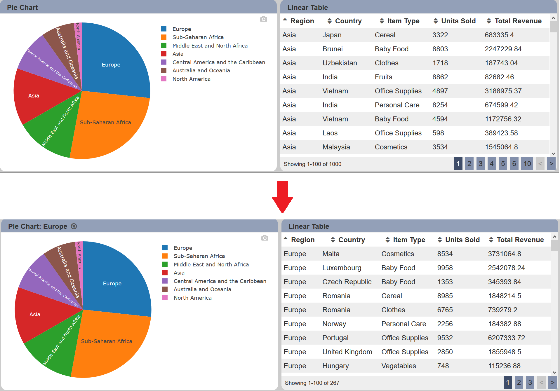

Example: Select to Control
You can use the “Select to Control” property to interact and control other dashboard views. In this example, there are two views, a pie chart and a linear table that uses the same dataset. You can use “Select to Control” property in the pie chart to control the content of the linear table.
To do so, first create a control filter that uses the “Region” field. In the View Properties of the linear table, select the control filter that was created earlier in the “Controlled By” property. In the View Property of the pie chart, select the same control filter in the “Select to Control” property.
By clicking on the portion labelled “Europe”, all the data in the Europe region are displayed in the linear table.
You can click on other portion in the pie chart and the linear table will display the data of the portion. To reset the selection, click on the
icon in the pie chart and the linear table all data in the dataset.
