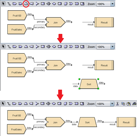

The simple example below sorts the records for the DataSource processor.
To do so, select the
button on the menu bar and click on the location in the designer diagram. Use the Flow connector to connect the Sort and DataSource processors together.
The Sort processor is present but the sorting method is not defined yet.

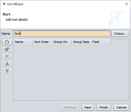

Either one method will launch the Sort Wizard.
On the left of the page, there are a column of buttons, namely “Add”, “Edit”, “Delete”, “Move Up” and “Move Down”. These buttons allows you to add/edit/delete fields for sorting and the sorting order.

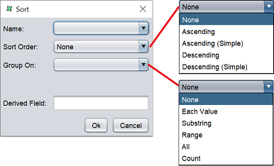

To add a field to sort, click on the “Add” button on the left. A “Sort” dialog box will appear.
| Field | Description |
| Name | Selects the field to sort from drop-drop list. |
| Sort Order | Selects the sorting order from drop-down list. Default value is “None”. The “Simple Ascending” and “Simple Descending” sort compares unicode character values literally and does not ignore spaces. |
| Group On | Selects how the records are grouped from drop-down list. Default value is “None”. |
| Derived Field | Defines a name for the derived field from the sorted list. A new field will be created in the output schema for this field. |
The common options available for the “Group On” field varies according to the type of field selected in the “Name” field.
| Type vs Option | Description | Numerical Data | String | Date Data |
| Each Value | Consecutive records (After sorting) with same selected field value are grouped together. | Y | Y | |
| Substring | A “[Start,End]” textbox will appear to specify the starting and ending character of the string. For example, [0,3] is specified, then the grouping will be based on 3 characters starting from the first character of the string (indexes are zero-based). |
Y | Y | Y |
| Range | A “Range” textbox will appear to specify one of the two types of syntax for the range. First type of syntax is [condition]:label. For example, <x:A, where x is threshold value based on which grouping is done and A is the label name assigned for the group. The other type of syntax is step(value,value,value). For example, step(x,y,z), where x is start value, y is increment and z is stop value. A number of ranges can be specified for both types. |
Y | Y | |
| All | All records are grouped together irrespective of selected field value. | Y | Y | Y |
| Count | Records are grouped with a fixed number of records in each group. | Y | Y | Y |

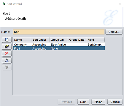

Select as desired and click on the “OK” button to exit the “Sort” dialog box.
The sort details will appear in the Sort Wizard.
Once all desired sort details are added, click on the “Next” button.

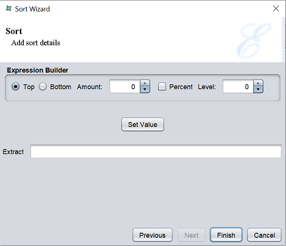

This page allows you to create an expression builder and display the command string.
| Top | If selected, the top n number of records are to be retained. |
| Bottom | If selected, the bottom n number of records are to be retained. |
| Amount | Defines the n number. |
| Percent | If selected, the “Amount” value represents a percentage of the total number of records flowing through. |
| Level | Indicates the level at which the extraction algorithm applies. A value of 0 indicates all records. A value of 1 indicates the top n records of each group level 1 will be retained. The value can vary between 0 and the number of grouping levles identified on the previous page. |
Set up the expression builder as desired and click on the “Set Value” button. The command string will be displayed in the “Extract” field.
Click on the “Finish” button to save and exit the Sort Wizard. Click on the “Previous” button to go back to the previous page. To abort, click on the “Cancel” button.
