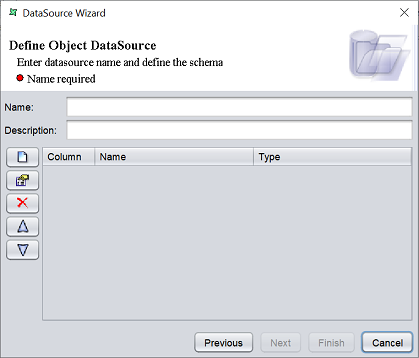

Define Details
This part requires you to define a name and a brief description (optional) for the object datasource.
| Name | Name of object datasource. | Yes |
| Description | Brief description of object datasource. | No |
The mandatory field must be filled, else an error message will appear in the page with a red dot and the “Next” button will not be enabled.

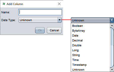

To add a field, click on the
“Add” button at the left of the page. The “Add Column” dialog box will appear.

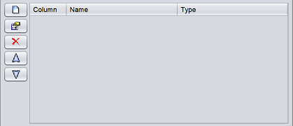

The order of the fields are according to the sequence they are added. To re-order the fields, select the desired property, then click on the
“Move Up” or
You can also edit the field by selecting the desired field, then clicking on the
“Edit” button. The “Edit Column” dialog box will appear.
If a field is added by mistake, you can remove the field by selecting it, then click on the
“Delete” button.

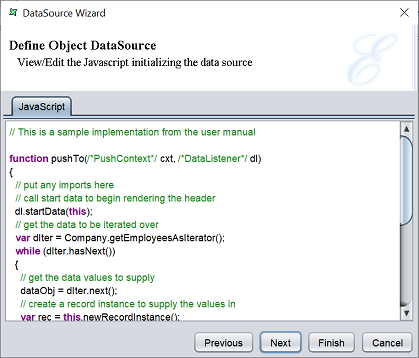

Define Object Javascript
In this page, you can view and edit the default Javascript for the object datasource.
The JavaScript entered here must conform to the pattern in the default JavaScript.
Edit as required and click on the “Next” button to go to the Security page or click on the “Finish” button to use the default security options.
