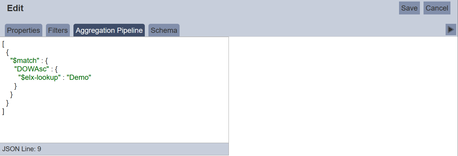

Prior setting up the Dynamic Parameter Control, the dataset need to setup the aggregation pipeline. Below is an example on how to setup aggregation pipepline for a dataset.
Example
In the Datasets module, select the desired dataset and click on the “Edit” icon under the “Actions” column. In the “Edit” panel, select the “Aggregation Pipeline” tab. Key in the code as required. Click on the “Save” button to save the code. Click on the “Cancel” button to abort the action.
In the above code, the parameter “Demo” will look for the matching “DOWAsc” field as in the data collection.

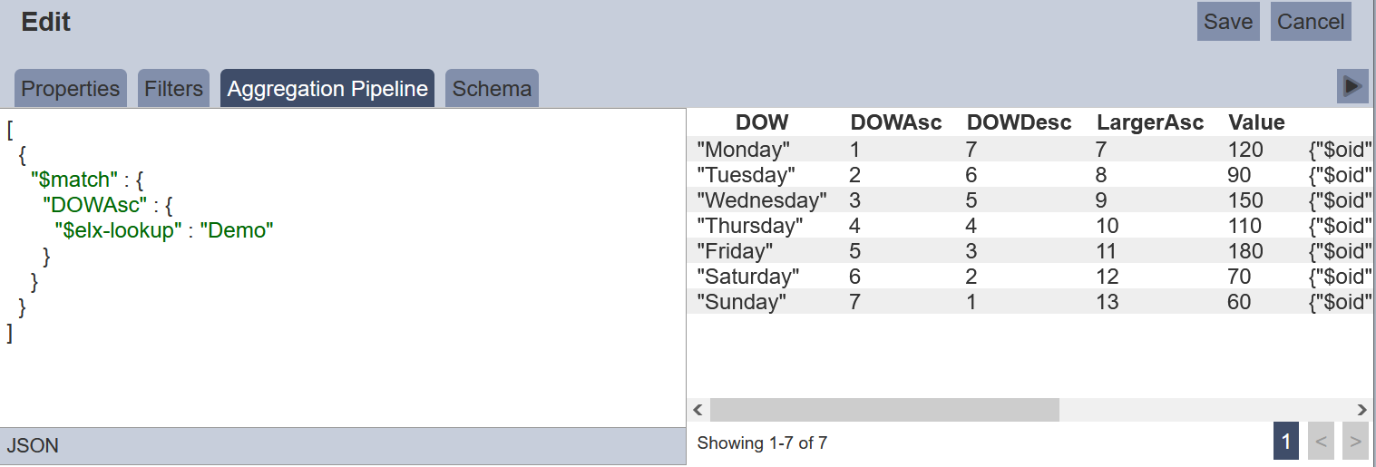

To test the code, click on the “Test Aggregation” icon at the upper right corner of the panel. The result is displayed on the right side of the panel, showing all data records in the “DOWAsc” field.

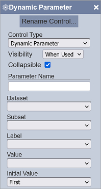

Dynamic Parameter Control Specific Properties
Parameter Name Parameter defined in dataset aggregation pipeline. Y Textbox Align with the parameter in aggregation pipeline of dataset Empty
Label Defines the choices displayed in the control filter in the Dashboard Viewer. Y Drop-down list Select from drop-down list Empty
Value Defines the values to be used for the label in the control filter in the Dashboard Viewer. Y Drop-down list Select from drop-down list Empty
Initial Value Determines the initial value of the filter control upon expanded for selection. Y Drop-down list Select from drop-down list:
- First
- Last
- Value
First
Example
In the “Parameter Name” field, key in “Demo” as defined in the aggregation pipeline example. In the “Dataset” field, select the desired dataset that has aggregation pipeline being set up.
Select the same field as defined in the aggregation pipeline of the dataset for the “Value” field. In this example, its “DOWAsc”. In the “Label” field, select the field that should appear in the drop-down list in the filter control in the Dashboard Viewer. This field should be a 1:1 mapping of the field selected for the “Value”.
In the case where there is no other field that can match 1:1 to “Value”, “Label” should use the same field as “Value”, so that the choices in the drop-down list aligns with the values.
In the “Initial Value” field, there are three options:
  • First - first value in “Label” field, this is the default option
  • Last - last value in “Label” field
  • Value - defines the initial value
If the option “Value” is selected in the “Initial Value” field, a textbox will appear below the “Initial Value” field.
Key in the desired value in the textbox. Ensure the value key in is one of the values in the “Label” field. In this case, “Tuesday” is key in and it is one of the values in the “Label” field in the filter control property.
Click on the “OK” button after selecting the fields to save the settings. Click on the “Cancel” button to abort the action.
