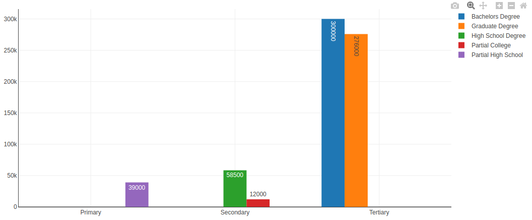

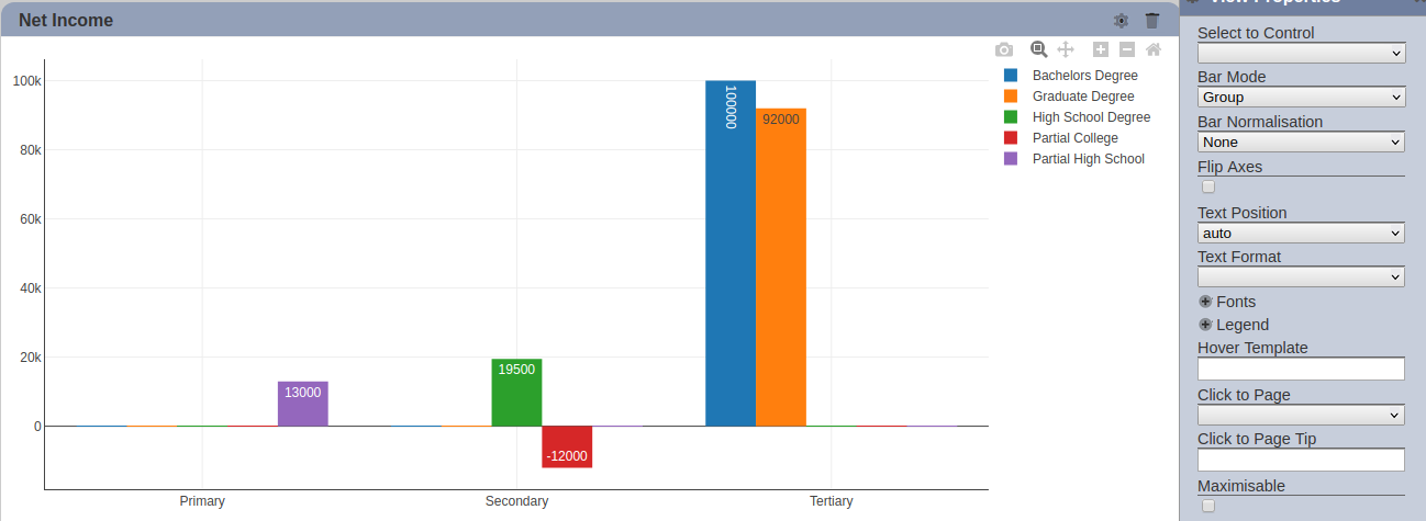

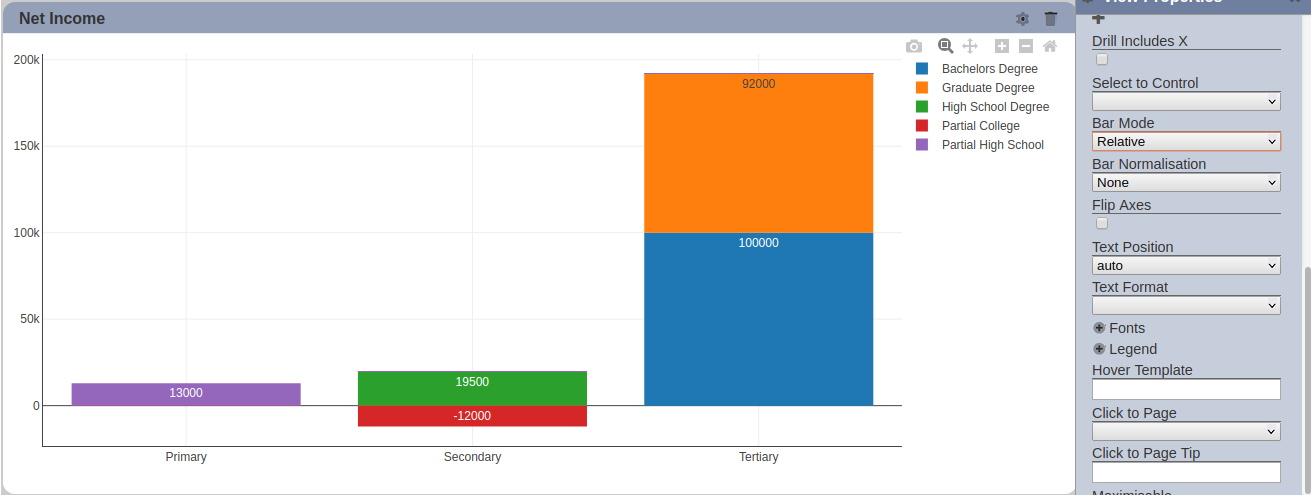

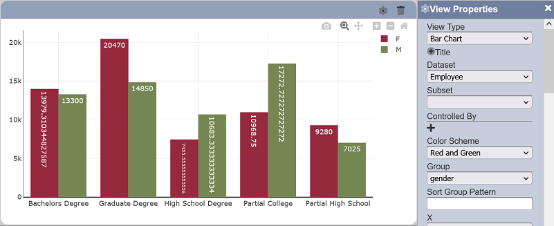

Bar Mode
This property sets the display mode of the bar chart. This property is specific to the bar chart.
| Bar Mode | Select | One value can be selected. Available options are: - Group - Stack - Relative |
“Group” | None |
By default, it is set to “Group”, which displays all bars of each X axis as starting from 0. Below are the available options:
- Group - displays all bars starting from 0. Negative values are also displayed starting from 0, growing vertically in the negative Y axis. Each bar does not overlap the other and is instead rendered next to one another.
- Stack - displays each bar of an X axis on top of each other, with the largest values starting from the base of the Y axis (0). Bars with negative values overlap positive-valued bars on the positive Y axis plane.
- Relative - displays each bar of an X axis on top of each other, with the largest values starting from the base of the Y axis (0). Bars with negative values are rendered separately from the positive-valued bars.

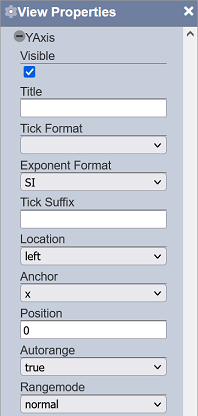

Note that setting the “Rangemode” of the Y Axis to “normal” or “tozero” makes the negative values viewable at first glance.

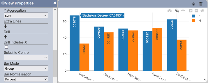

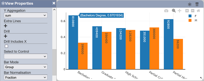

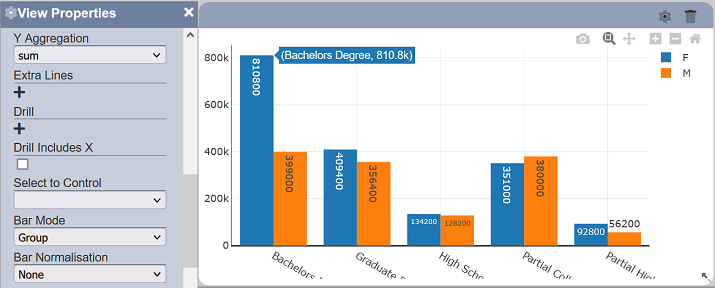

Bar Normalisation
This property allows you to choose the format of the labels in the Y axis is to be displayed, in terms on value, percentage or fraction.
| Bar Normalisation | Select | One value can be selected. Available options are: - None - Percentage - Fraction |
“None” | None |
By default, “None” is selected, which displays the values of the field selected in the “Y” field. Below are the available options:
- None - labels in the Y axis display the values of the selected field
- Percentage - labels in the Y axis are displayed as percentage of the values of the selected field
- Fraction - labels in the Y axis are displayed as fraction of the values of the selected field

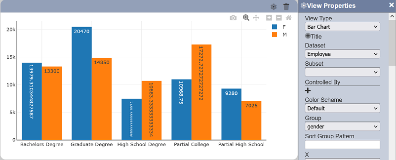

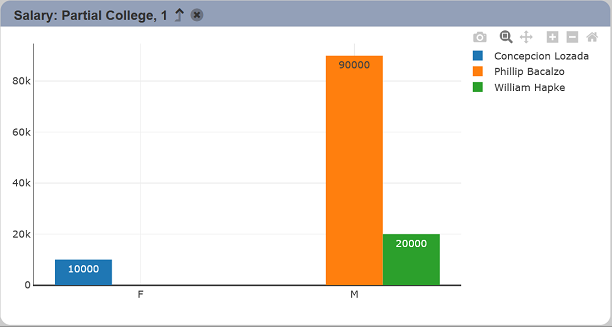

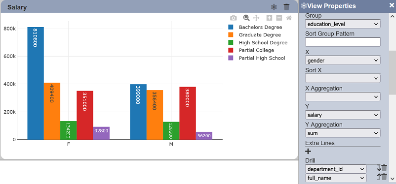

Drill
This allows drilling down data on the selected group level. Multiple fields of the dataset can be added to this property. The added fields are used to group the selected data group/trace. Each field added to this property represents one level of drill down.
Clicking on the
“Add” icon adds a new blank selector to the bottom of the list. Clicking on the
“Delete” icon removes the row from the list. Clicking on the sort icons arranges the order of each added line. Clicking on the
“Move Up” icon moves its corresponding row one place above. Likewise, moving the
“Move Down” icon moves it one place below.
| Drill | Select | One value can be selected. All fields of the selected dataset/subset are available. |

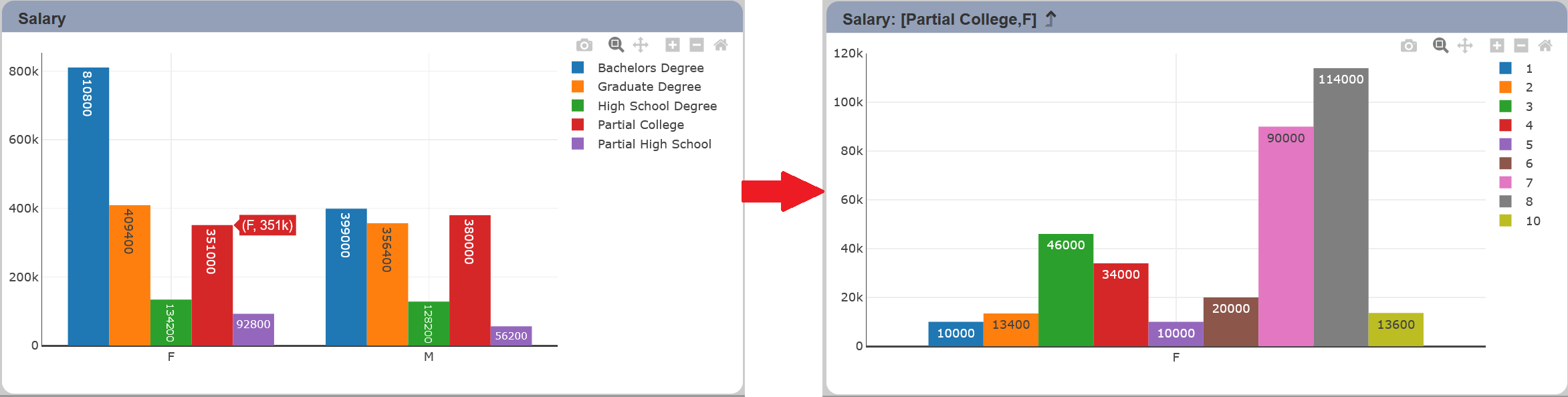

Note that the order by which the “Drill” rows appear affect the order drill down order. The ordering follows from top to bottom. If there are multiple drill down levels, clicking on a data group/trace group at the base level re-renders the view to display only the selected group/trace. The new subset is then grouped by the field corresponding to the first level of drill down. Each level of drill down would be applied on the results from its previous level.
In the example above, the data is grouped by “education_level”. On the base level, data traces appear for each “education_level” (see legend).

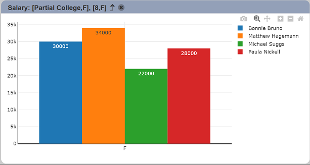

To drill down, click on any data group/trace corresponding to the legend.
In this case, “Partial College” is selected. Only records with “education_level” of “Partial College” are rendered. The grouping is subsequently changed to the first drill down level, which is set to “department_id”. Note that the selected data group/trace is appended to the grid title.
<view title>: <comma-separated group name selected for each level>
Drilling down into more levels simply appends the current selected group name to the whatever is in the grid title. This helps inform the user on what is being displayed.
There are drill down navigation buttons available as well. They appear after the text on the grid title. The

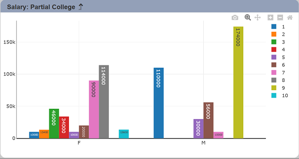

Drill Includes X
This enables drill downs to be done for a specific X value. This is also dependent on having drill downs configured (“Drill” property).
This is currently available for bar charts only.
When enabled (checkbox is selected) and if “Drill” property is set, only the selected X value of the selected data trace is re-rendered on the next level drill down.
Using the same example used in the “Drill” property, with the “Drill Includes X” property enabled, the X data displayed on each drill level is limited to the X value selected on the base level. Clicking on “Partial College” data trace for for gender “F” (X value) displays all data with “Partial College” as “education_level” and “M” as “gender”.
Drilling down to further levels changes the grouping according to the set property values, similar to how the “Drill” property works on its own, plus a fixed X value. The display on the grid title bar, appended after the grid title, if any, would also include the selected X value as an indicator of what is rendered. The format is as follows:
<view title>: <comma-separated sets of group name and X value pairing>

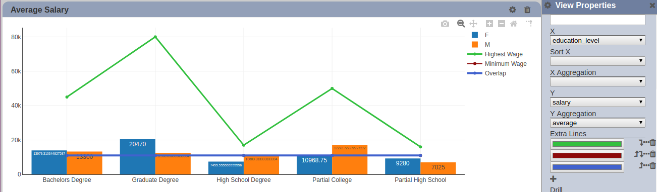

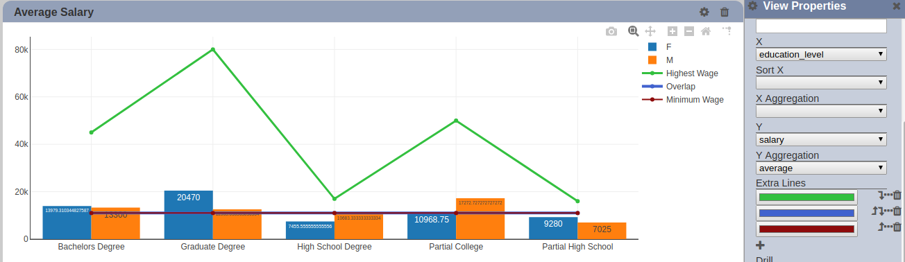

Extra Lines
This sets additional lines over specific views. This is especially useful for setting indicators or threshold values on views. One or more can be added.
Clicking on the
“Move Up” icon moves it one place below.
Clicking on the
“Color Picker” allows selecting specific colors.
Clicking on the
“Properties” icon allows more fields to be entered.
They can be of fixed values or based on a specific field in the same dataset. Ticking on “Fixed” property indicates that the line should be of a fixed value. Otherwise, the line would be based on data.
| Description | Field | Input Type | Constraints | Default Value | Dependency | |
| Name | Display name of the line to be displayed. | Text field | Any text | None | None | |
| Size | Thickness of the line to be displayed. | Text field | Any number above 0. | None | None | |
| Fixed | If selected, line properties after “Fixed Value” are fixed. | Checkbox | None | Selected | None | |
| Fixed Value | Fixed Y axis value of the line to be displayed. | Text field | Any number. | None | “Fixed” must be enabled for this property to be displayed. | |
| Field | Dataset field to be used as Y axis values for the line to be displayed. | Select | One value can be selected. All fields of the selected dataset/subset are available. | None | “Fixed” must be disabled for this property to be displayed. | |
| Operation | Operation to be applied on the Y axis values for the line to be displayed. | Select | Ine value can be selected | None | “Fixed” must be disabled for this property to be displayed. | |
| Curved Line | Allows the line to be displayed as curved. | Checkbox | Enabled (true) and disabled (false) | None | “Fixed” must be disabled for this property to be displayed. | |
Note that the order by which the “Extra Line” rows appear affect the order by which they are plotted on the chart and on listed on the legend. The topmost row is listed first on the legend. The ordering follows from top to bottom. On the charts, the topmost row is plotted first. The succeeding ones are plotted on top of it.
Therefore in the example above, the first screenshot shows the blue line at the top as it is plotted last. In the second screenshot, the red and blue extra lines are swapped and thus, the red line is now at top as it is plotted last.

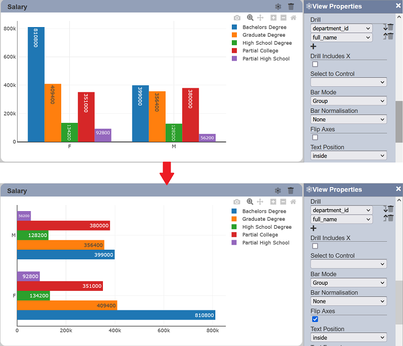

Flip Axes
This property allows switching the X and Y axis on display. This property is only available on the bar chart.
Normally, the X axis appears and grows horizontally while the Y axis does so vertically. This is disabled by default. When this property is enabled, the X axis would appear and grow vertically while the Y axis would do so horizontally. Effect on the chart is that the bars would look horizontal instead of vertical.
Note that all data properties (e.g. Group, X, Y) would still be populated as if the “Flix Axes” is disabled. However, display properties, such as “XAxis” and “YAxis” property sets would follow flipped chart. This means that if the “XAxis” “title” is set, it would appear on the bottom, regardless of the setting for “Flip Axes”.

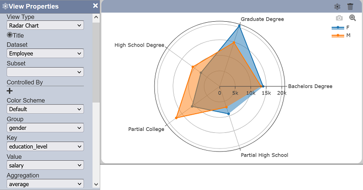

Group and Key
The “Group” property puts the output of the selected dataset/subset into separate groups or data traces based on the field selected (e.g. group data by department). The “Key” property also groups the output into separate groups based on the selected value.
If used alone, both do the same thing. “Key” is available by itself on the pie chart.
If used together, “Group” is used to create separate data traces. “Key”, on the other hand, is used to add further categorization to the data in each data trace resulting from applying the “Group” property.
Note that only records that have the selected field are included in the data; records that do not contain the selected field are excluded.
| Group | Select | One value can be selected. All fields of the selected dataset/subset are available. |
None | Dataset/subset must first be set. |
| Key | Select | One value can be selected. All fields of the selected dataset/subset are available. |
Depending on the view type, populating the “Group” or “Key” property may be required to render the view.

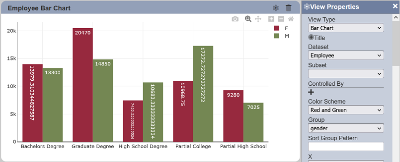

For views that have X and Y axes (e.g. bar chart, line chart, bubble chart, etc.), if no value is selected, no grouping is applied. Data would instead be plotted collectively. For instance, on a bar chart, grouping data would result in multiple bars on a single X value.
If grouping is not applied, only one bar would appear per X value.
For views that support more than two dimensions but don’t have X and Y axes, such as the radar chart, both properties are available.

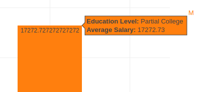

Hover Template
This property allows setting a template to be used when displaying texts upon hovering (mouse-over) the data points on the view.
The template is set to blank as a default. Default template varies per applicable view.
All values included in the data displayed on the view can be can be added to the template using variables or placeholders. This means that, for instance, on a bar chart, only X, Y, data trace names and additional fields added through the “Data Script” property can be referenced in the template. Data references and functions must follow a certain syntax:
Sample template with variable references:
Other texts that are not function-related (e.g. numeric/date formatting) are displayed as static text. Adding some basic styling or aesthetic formatting to the displayed text can be done through adding HTML tags.
HTML basics can be found in many external sources.
The views that support this property are built using Plotly. Configuring the template may require a more technical background. Additional information regarding supported hover text format can be found in the Plotly documentation, also an external source: https://plot.ly/javascript/hover-text-and-formatting/
